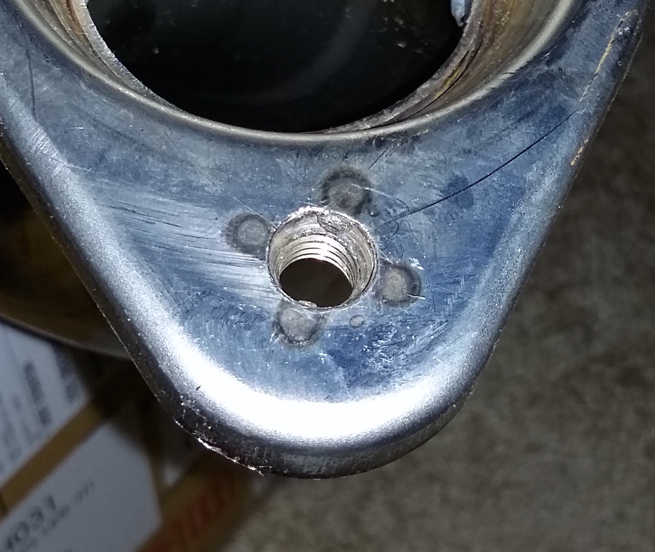

So, I took a chance and bought the HKS Silent Hi Power from Kamispeed.com and after a three month wait it finally came in and I've been sorely disappointed.

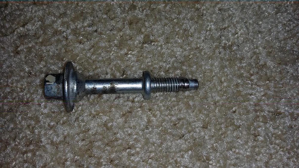

One of the nuts that holds the muffler had a weld sticking out too far. This ended up tearing up one of the bolts that holds it on. I didn't realize what had happened at first, I thought, "that's weird" when it kept failing to catch on the bad nut side.
I switched the bolt to the other side, noticed it was hard going in, pulled it back out and noticed it was galled to hell. I'm not a mechanic, but I worked on my tools for a living for 5 years so I know what I'm doing when it comes to this stuff.
I tried the other bolt on the bad side (the side I originally tried) and that's when I noticed the weld was in the way and tore up the threads before it had a chance to catch the threads on the nut (lucky I noticed this before the threads on the other bolt got too torn up and was able to chase them back out on my stock exhaust and use it to bolt the stock exhaust back up).
I did a quick scan for leaks and all seems ok, even with only one bolt.
Long story short. DO NOT BUY.

Unfortunately, I dropped an email to HKS, who said the vendor should take care of it. Great. Looks like this might turn into a run around. Really, I think I could fix it by running a tap through it, and I may be able to fix the bolt by running it through a die, but those 8 bucks to buy anyway (I checked). But my faith in the product has been shaken enough that I wanted a refund. Oh well. Like I said, I knew I was taking a chance when I was ordering it, it being a brand new product and all, so I was half expecting something to go wrong.

I'm going to run a tap down the threads on both sides and file down the weld. I can get this to work.

I was able to re-tap the threads and die the bolt and reuse it. Then my ratchet fucking broke (it was a cheapie, my good tools are in storage), I have it one bolted right now and took it for a test drive... It sounded pretty damn good I thought, you can definitely tell it's there when accelerating and climbing hills (well bridges, not many hills in SE Texas), but it's not over the top. When cruising 65-70 you almost don't notice it, the sound is very subtle. You only really notice it under load.

I actually was able to use OEM parts, it fit up perfectly. It was a bad weld that caused my problems and ruined a bolt (although I fixed).
