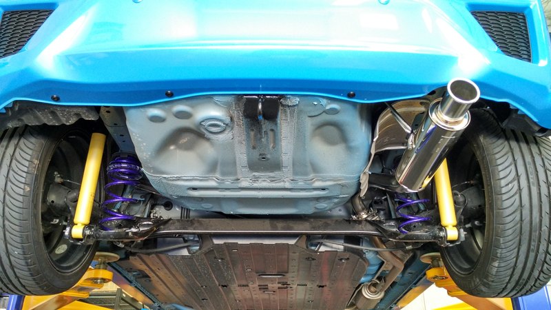

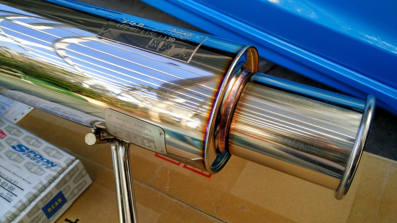

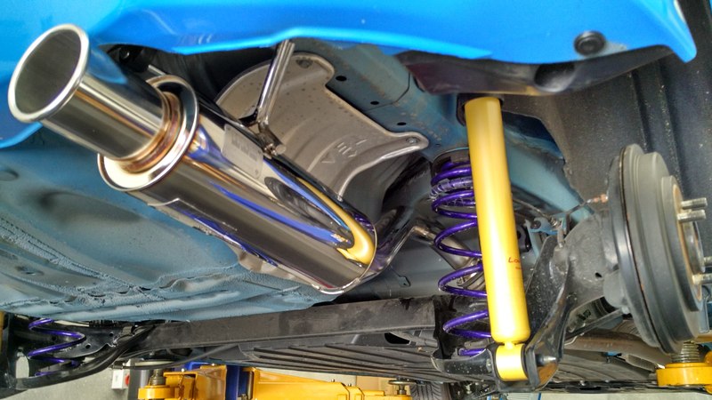

This was a test fit to find out if JDM HKS exhaust can be fitted on non L15B engine GK5 with CVT. The result was perfect fit, no modification required.
Car: Australian 2014 Honda Jazz VTI-L (GK5)
Engine: L15Z2
Transmission: CVT
Exhaust: HKS silent Hi-Power (Ordered from Japan)

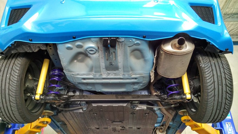

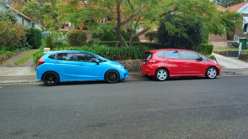

Before and After

To install it without lift. Jack the car up and place car stand, then you can start. Only require removing 2 bolts and 2 rubber mounts, then use them again on new exhaust.

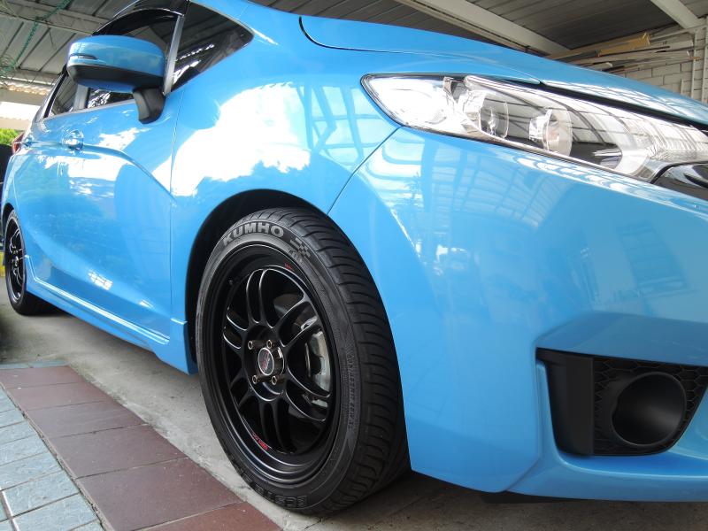

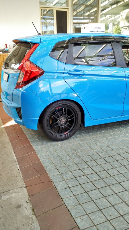

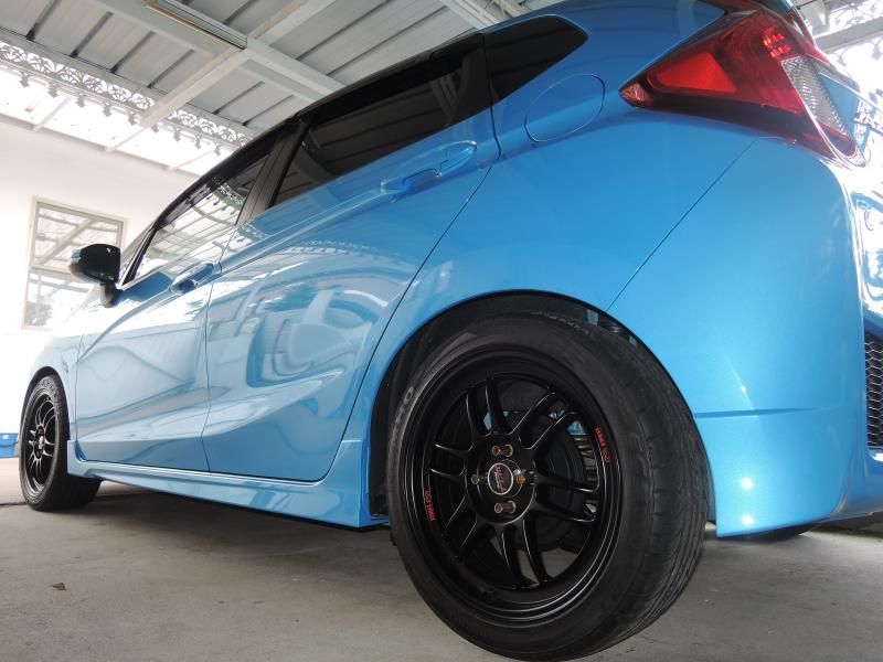

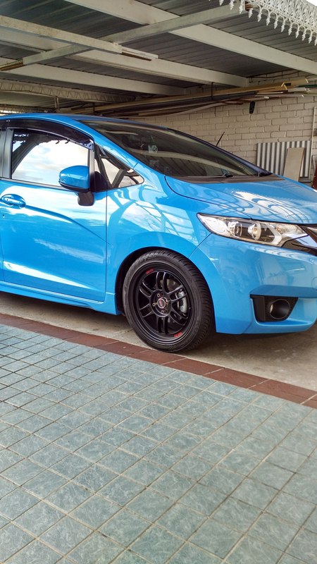

Wheels spec: Enkei RPF1 17x7 43
Tyre size: 205/45R17

Have more pics of the wheel set up? I was going to go Kosei K1, but after talking to them directly it'll be awhile if ever before they will make a 17x7.5 +45 again. They need 80 pieces ordered.
Old Aug 18, 2015 | 05:57 AM
Sam Tsai's Avatar
Joined: Sep 2014
Posts: 38
From: Australia

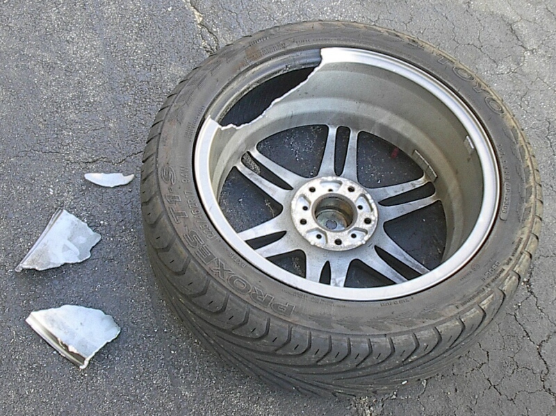

Here you go, but just be careful with copied wheels. Sometimes they end up(or worse) like the one in last picture.

It was installed by a Japanese mechanic, I'm not sure what torque did he tighten the 2 bolts. He use hand tools only, the HKS instruction manual did show 19.6~24.5 Nm (2.0~2.5kgfm).
