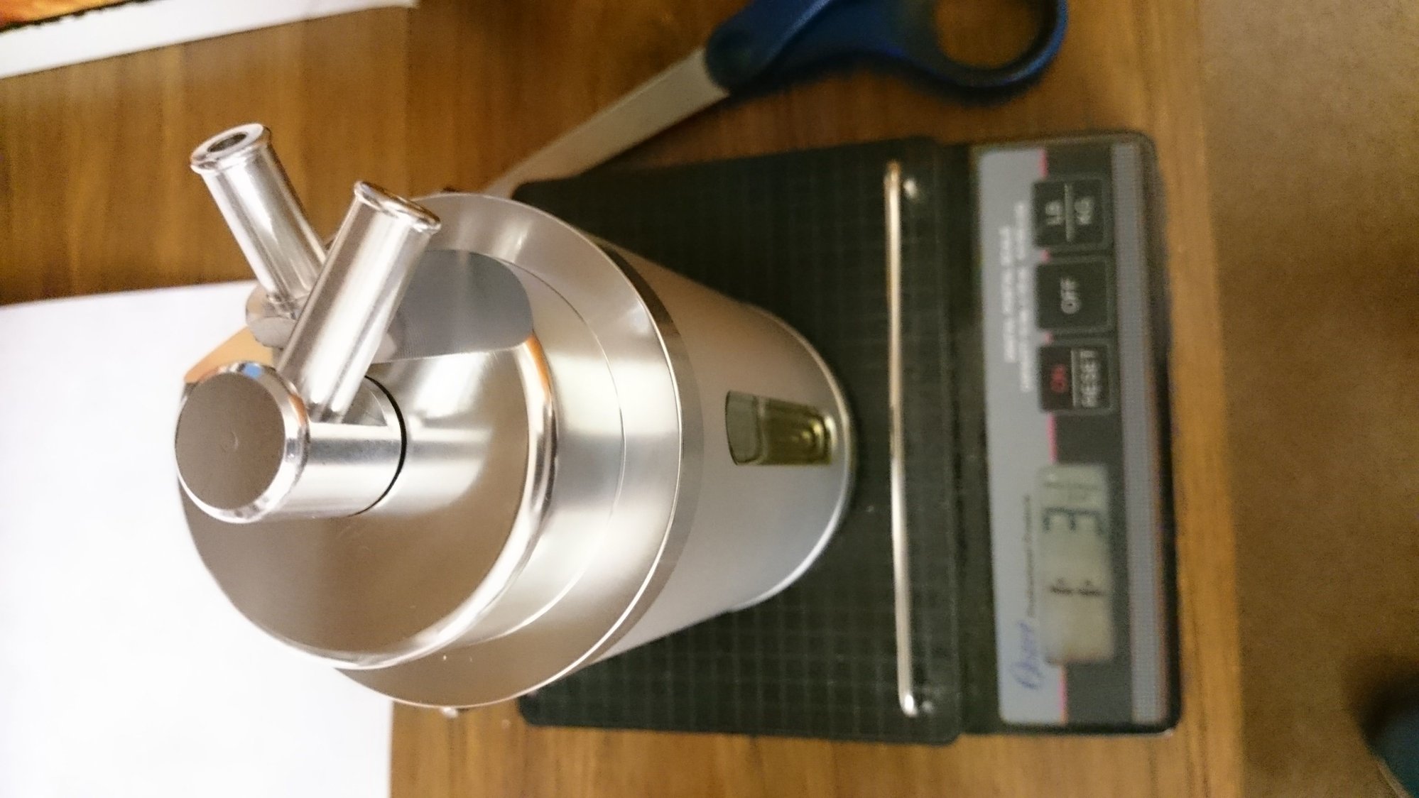

Installed my Simota catch can.
Some tips:
Buy new clamps. I used 5/8" spring clamps instead of the band clamps included with the can. A band clamp will not fit at the intake.
Buy new hose. I bought Gates 3/8" id pcv hose. Looks much better than the blue hose that came with the can.
I mounted the can on the tranny mount.
I would recommend buying a small can and mount next to the windshield washer reservoir for you cvt and stock airbox owners.
Also, I did not disconnect the stock pcv hose at the block. It is behind the starter and is very hard to get to. I did not want to deal with it so I spliced the stock hose to my Gates hose using a vacuum connector. If you mount your can close enough, you can connect the stock hose to your can. Hopefully someone can figure out a way to get to the stock clamp at the block.
I'm not expecting to catch much but we'll see what we get after a month.
