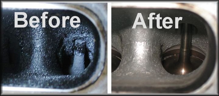

sneefy, was it you who had a bmw 135i as a 2nd car? I've been looking into these heavily as of late.... and my goodness, even at 44k, the carbon build up is insane!
https://www.e90post.com/forums/showthread.php?t=520035
even the newer n55's apparently still suffer from some (not as much) carbon build up
https://www.boostaddict.com/showthre...t-periodically
Not me. That's some nasty buildup!
