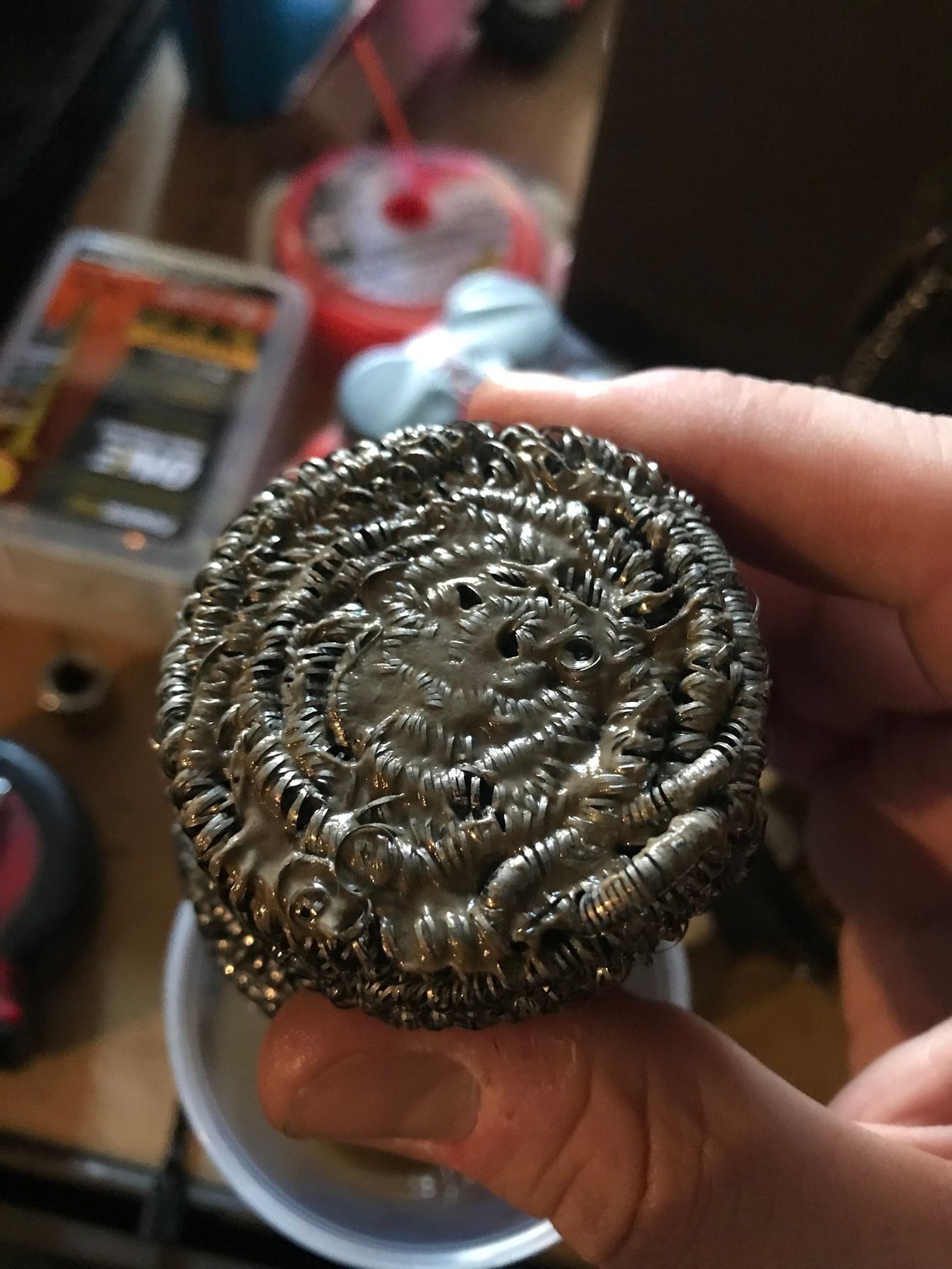

Okay.... I've heard a few comments about oil catch cans in the winter and them creating condensation. There seems to be a lot of truth to this idea. The cold aluminum can that is being blasted by cold winter air and has very hot air traveling through it. This causes condensing of the moisture rich air and a large buildup of water in the catch-can.
I haven't put much thought into whether this is hurting or helping. I don't know if the high humidity air can actually act as cleaner for the valves. I am sure there is some benefit to not having water in the combustion process, but also the amount would be so little that I am sure it could not matter.
I am estimating that this is probably 80-100ml of liquid and almost entirely water.
Left to right is my first, second, and today's emptying of the catch can.
I believe when this one completely settles it will be almost entirely moisture.

Scowling Pad Change
My scowling pads are pretty ugly on the bottom, probably thanks to the water causing gunk... Since they are 3 for about $2, I grabbed a pack while at Target. Labor and cleaning supplies aren't as easy as throwing $2 at this... I use 2 at a time so maybe if my other single turns up, I'll have another set for later.
Picture is the bottom, so it's worst case. I am sure I could pour something in, shake it around and pour it out, but oh well....
