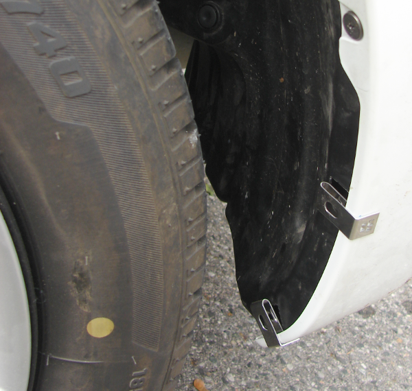

Now attach the metal clips. The splash guards will screw into these clips. These clips are oriented into the car. They have teeth that dig into the plastic fender for a solid connection. You use one of the screws to tighten both sides of the clip together. Install the clips on the marks from the paper template. Once tightened, remove the screws. note that these screws are extremely soft/cheap, so don't over tighten and don't slip.
2016 Honda Fit Rear Splash Guards: Install right clips.

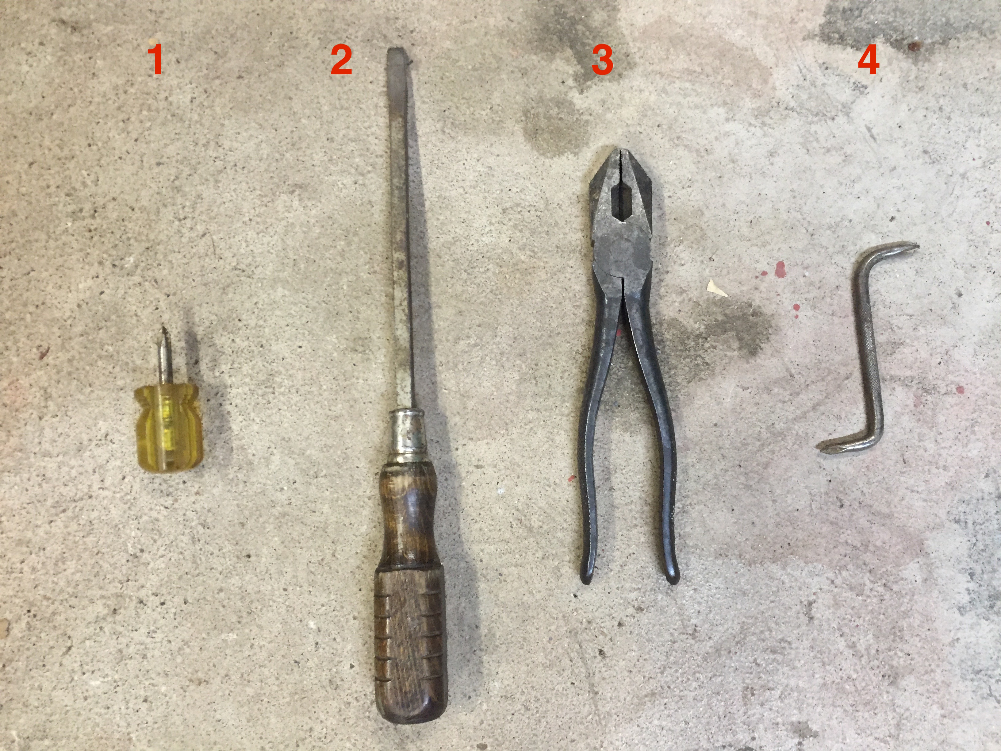

I just installed them this past weekend. Certainly easy, just the rear is a PITA/time consuming. Here are my time savers:
I used a stubby screw driver [1] but found it still too long. So I used an angle wrench [4]
A long big screw driver [2] was great to pop the fasteners under the wheelwell.
Instead of using the screws to tighten the fasteners on, I used a pair of Lineman Dykes [3] to crimp them into place. Hell, I wasn't gonna sit there with a stubby screwdriver against the tire trying to secure those !@#&*)^. The pliers did the trick.
Of course, your other option is to jack the car up and pull the wheel. "Aint Nobody Got Time For That!"
