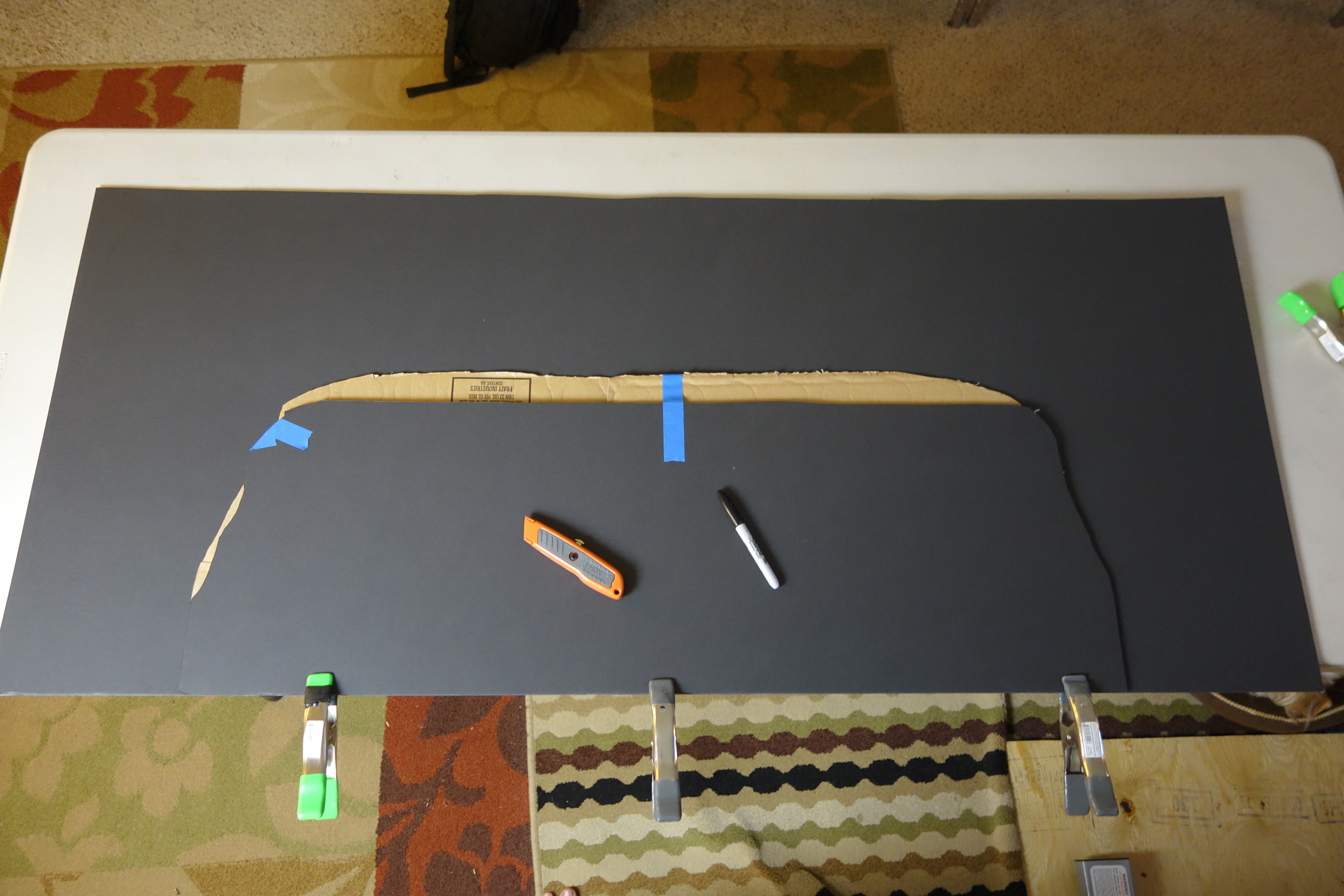

Step 1: Go to Michael's, walk past the section with regular foam core boards, and head straight to the custom framing department. Tell the nice lady at the counter that you need a huge sheet of black foam-core board. They have a 40"x60" sheet for $10 and change plus tax. This is large enough to give you a template cut and a final (bonus: this board is large enough to show a friend just how versatile your little hatchback is).
Step 2: cut a rectangle from the foam core that's about 45"x14" with a sharp new box-cutter and start whittling it down bit-by-bit to get it to fit in the cargo cover tray. This will take some time and your entire vocabulary of swear words.

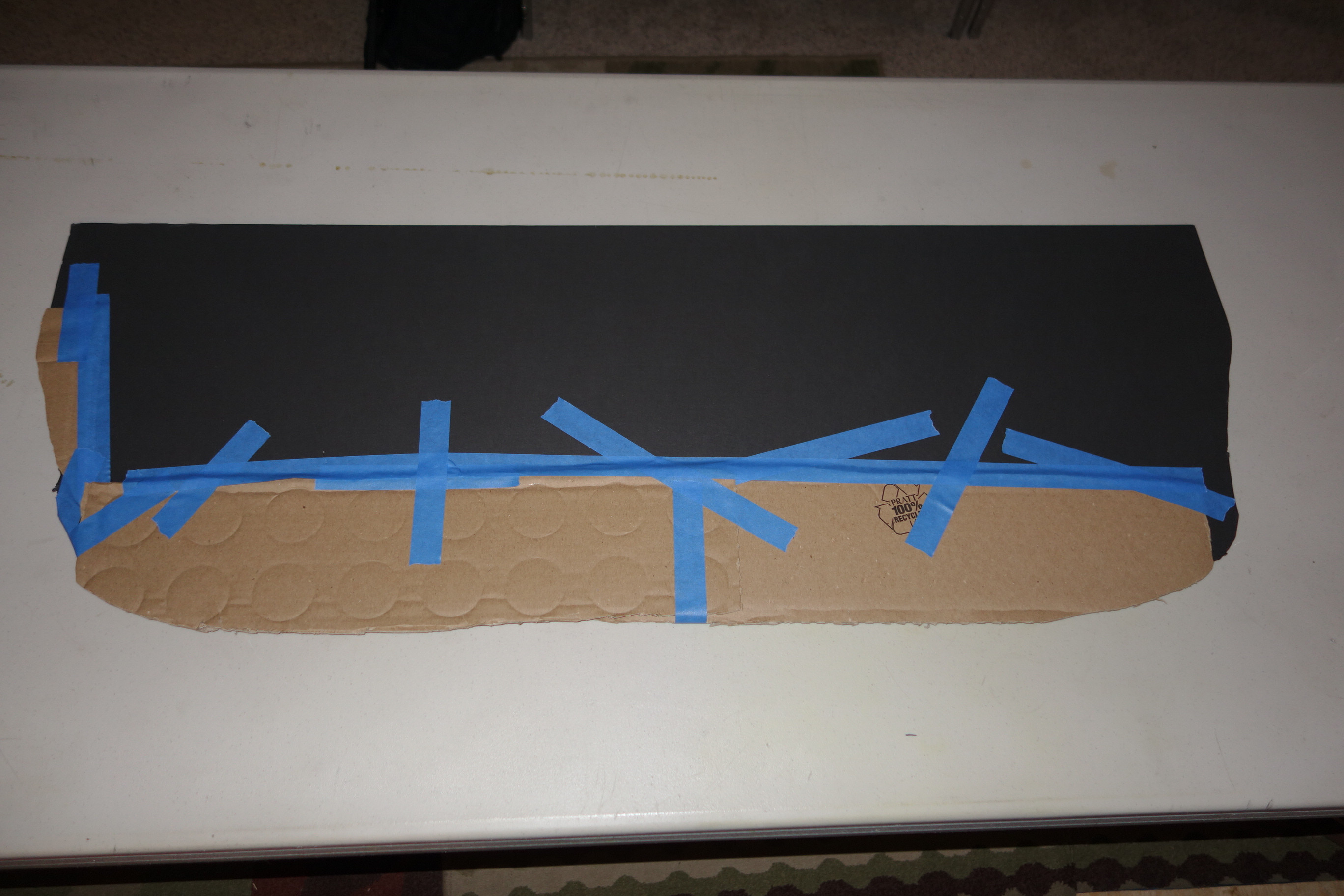

Step 3: If you are as useless as I am, you will have some gaps that need filling where you cut too much away. tape some cardboard pieces in place to get a nice template.
Step 4: place your completed template on top of your fresh piece of board and cut a nice clean piece from your template.

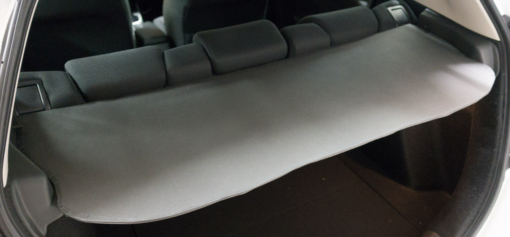

Step 5: test fit and trim as necessary. Mine fit very snugly the first time - yay.
I put a flashlight below the cover so you can see that there are still some small gaps, but with my 40% tint and no light in this bay, it would not be possible to see anything through these gaps. Obviously the more patient you are, the cleaner your result will be. I am not a patient man.

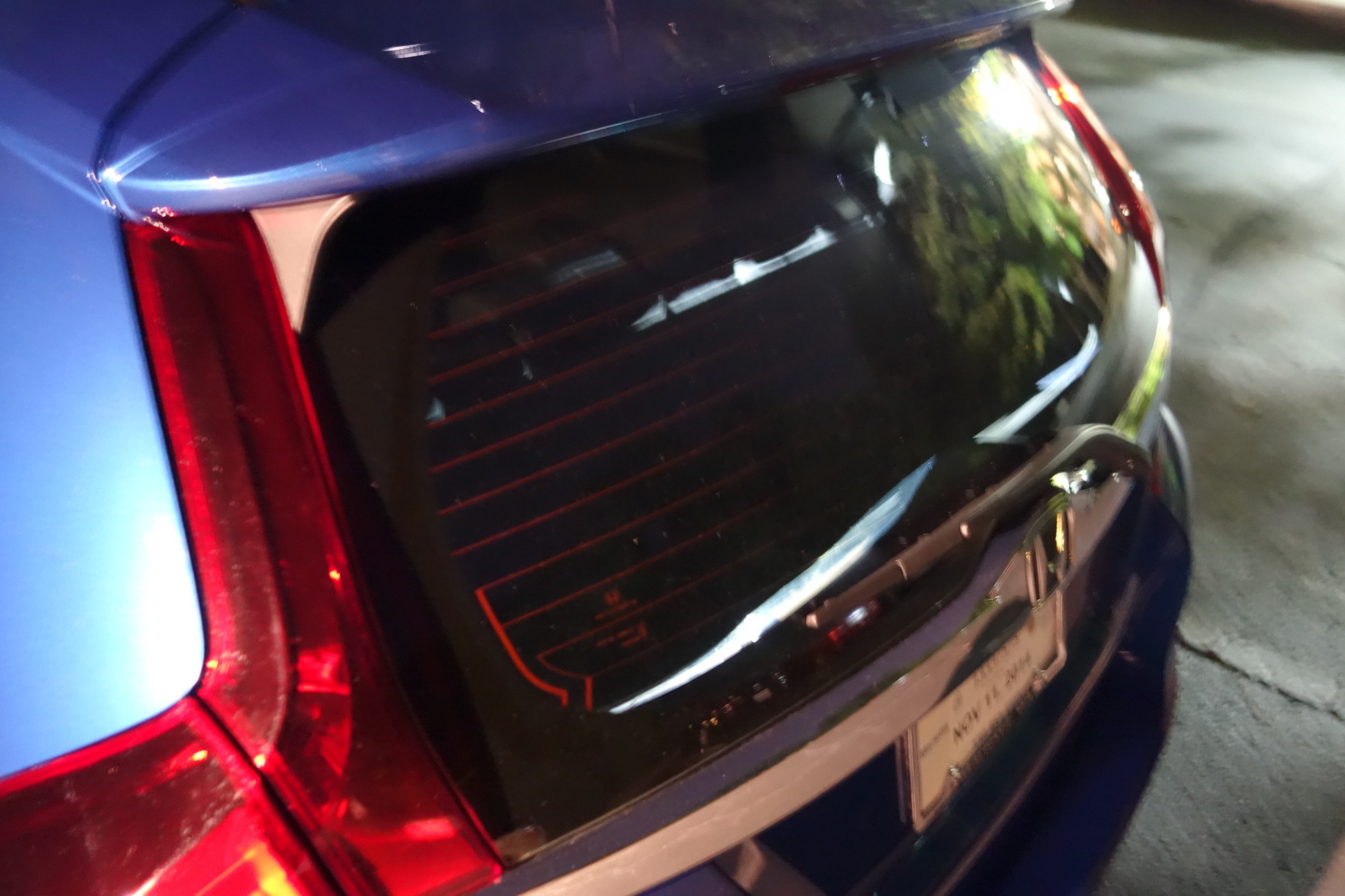

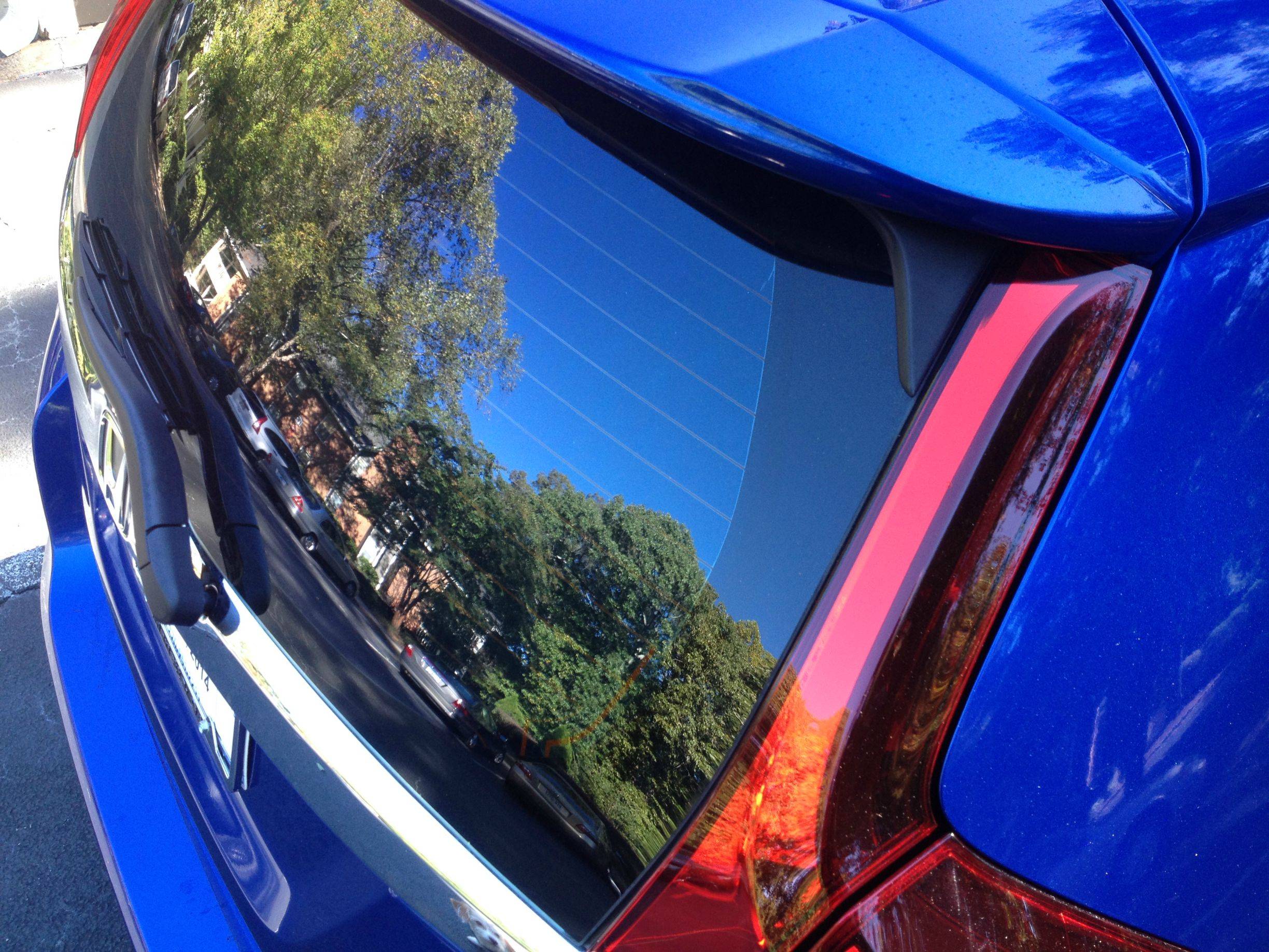

UPDATE: I'm happy to report that when viewing it from the outside or even from inside the passenger compartment, it's pretty impossible to tell that it doesn't belong there and you definitely can't see anything past it. You'd only really know it wasn't factory if you opened the hatch.
This will totally work until Honda come to their senses on the OEM cargo cover.

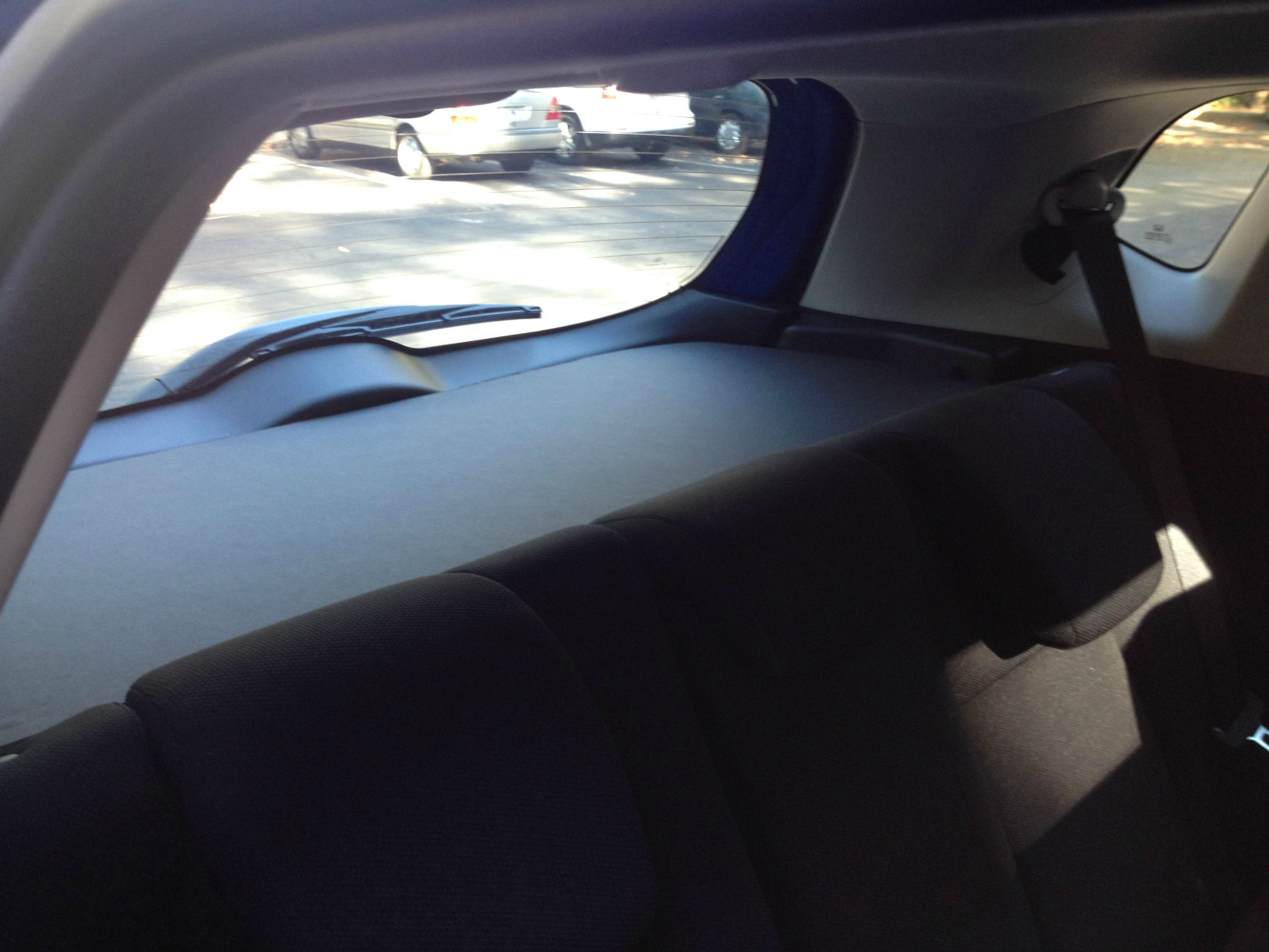

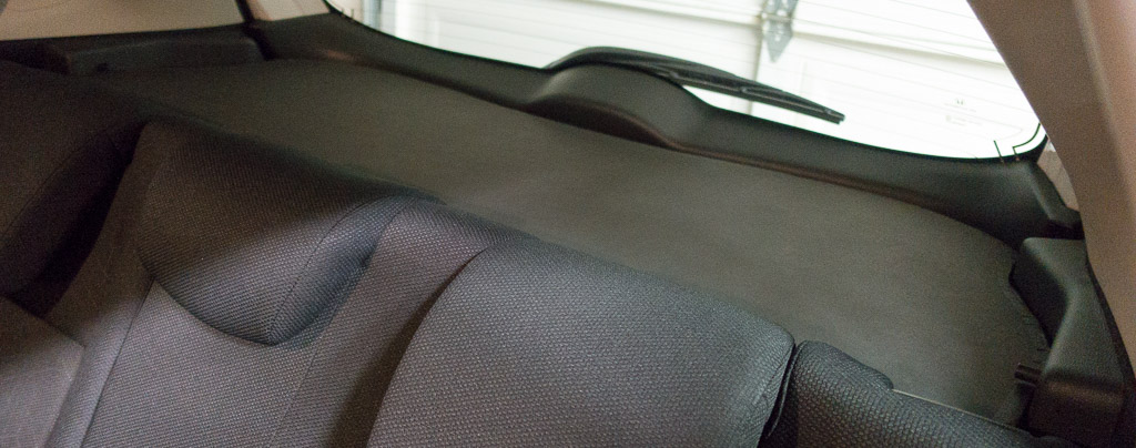

Thanks for the tips and inspiration. I paid $15 with tax for the 40x60 sheet and made a cardboard template first, cut to shape with a minor amount of trimming, added some gaffers tape to the perimiter and installed.
I think it came out pretty nice and it wedges in nicely without any velcro. Just bend slightly in the middle up or down to remove and chuck out of the way for the larger costco runs.
I have enough left over to make another one in a few years if this one gets dinged up or damaged.
