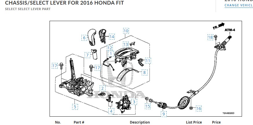

Awesome video. I have a question about partnumbers, as i know honda does funny things with partnumbers and their pars diagrams at time. On the diagram below, it shows 6 as being the part to replace, however, the part number listing show 2 parts, different numbers, same description, and a 2x cost difference, which one is the correct one? 54131-T5A-J51ZA or 54131-T5R-A81ZA
*Edit, i found the partnumber thanks to Stembridge. drum roll, 54131-T5R-A81ZA

Old Jun 6, 2016 | 08:45 PM
stembridge's Avatar
Joined: Sep 2014
Posts: 927
From: The Middle West
You're welcome! (c:
