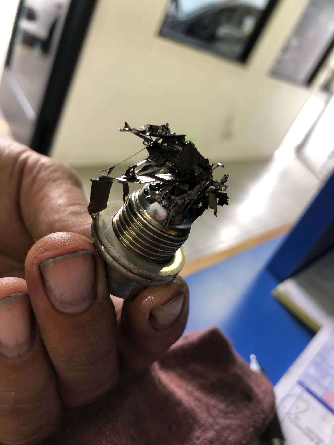

CVT tranny with metal shavings
anyone had this happen to them? only have 69k miles, dealer told me I need a new tranny. Brought it in initially cause of shifting issues..

Wow, looks like the CVT self destructed.
My 2016 has 53K mi. and the MM came on around 50K for the CVT fluid change, which I did.
Curious - did yours have the MM come on yet at 69K?
If it did and the fluid was changed then, was anything amiss?
