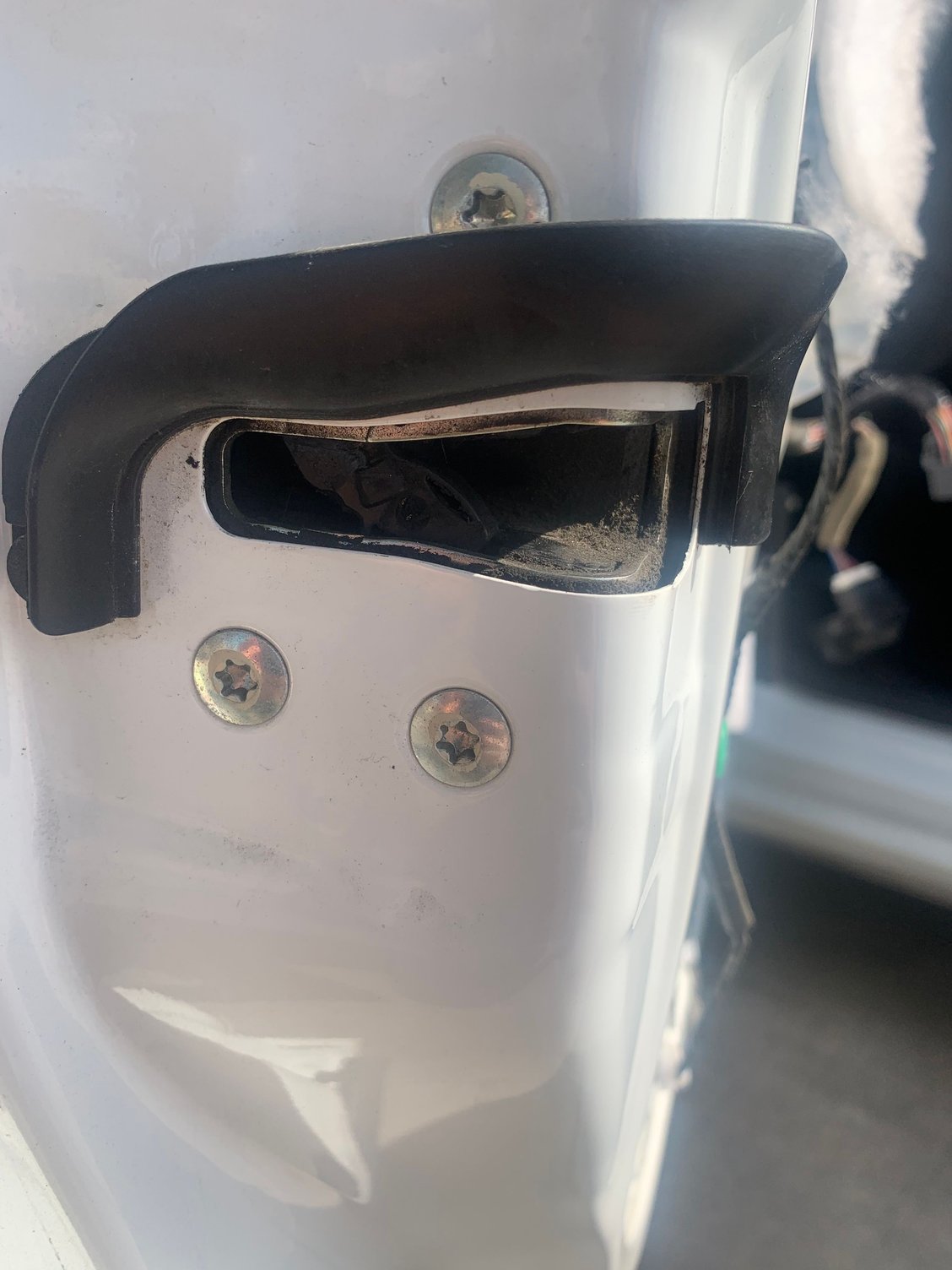

From: Utah
My 2007 Odyssey did that. It was due to the lock on the driver door sticking just enough that when the locks auto locked, the little knob wouldn't actually go down. Apparently the system used the position of this lock to tell if the doors needed to auto lock or not. I could verify this by physically pushing the knob down. When I did this, the system would stop trying to auto lock over and over. Not sure if yours is related, but I thought I would share just in case.

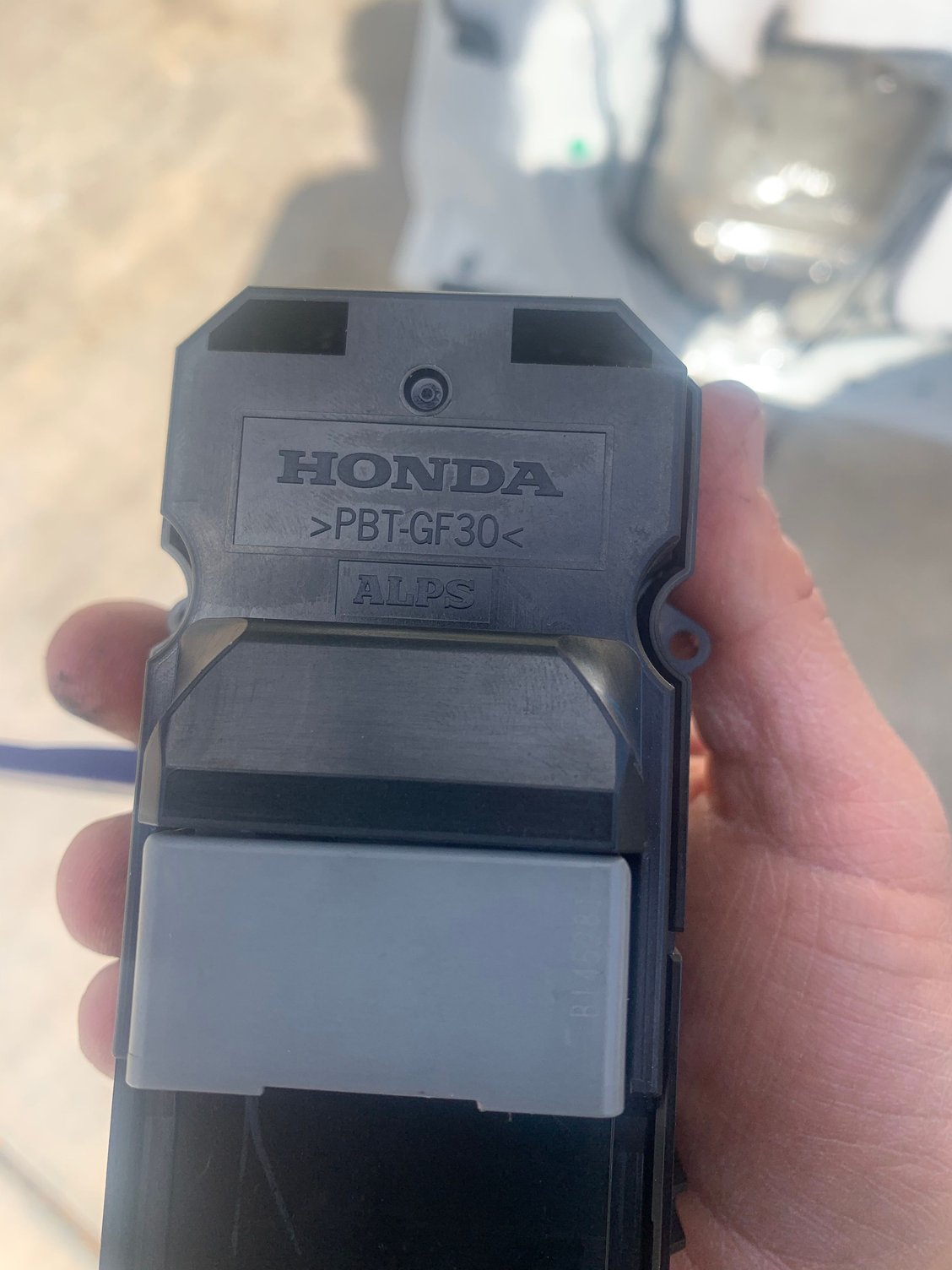

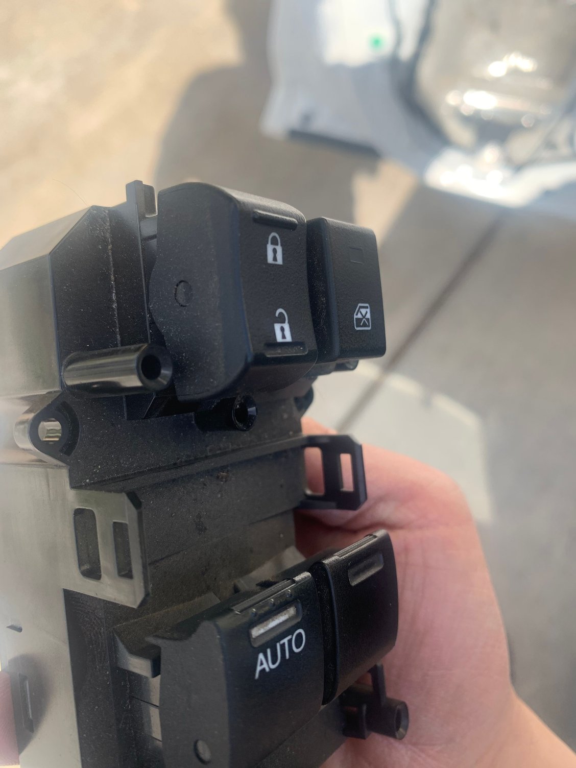

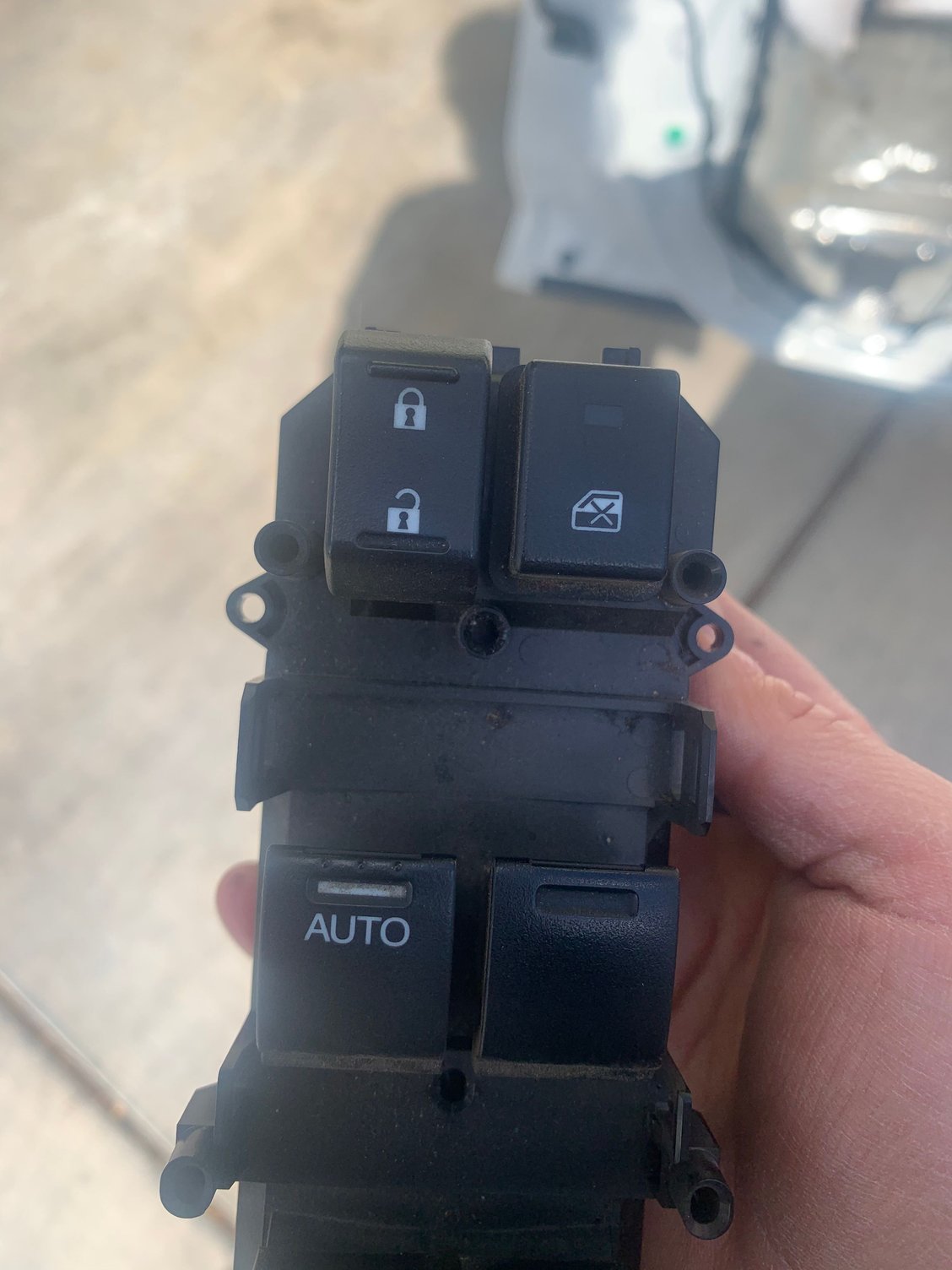

Old Mar 20, 2021 | 07:17 PM
Ummitsgabe's Avatar
Joined: Nov 2016
Posts: 25
From: United States
hey bud sorry to bother again but another question lol.
So was the piece you moved to fix the problem this piece in the door that moves with the door handle.
Or is there a knob in here. Do I open this piece up and fix something In here?
once again thanks man for answering!

There's not much to do with the switches themselves as they are pretty solidly built. I took mine apart to change the color of the indicator lights. They are solidly built. I suppose if they every got wet that might cause some issues but it would take a lot of water to screw up those switches.
