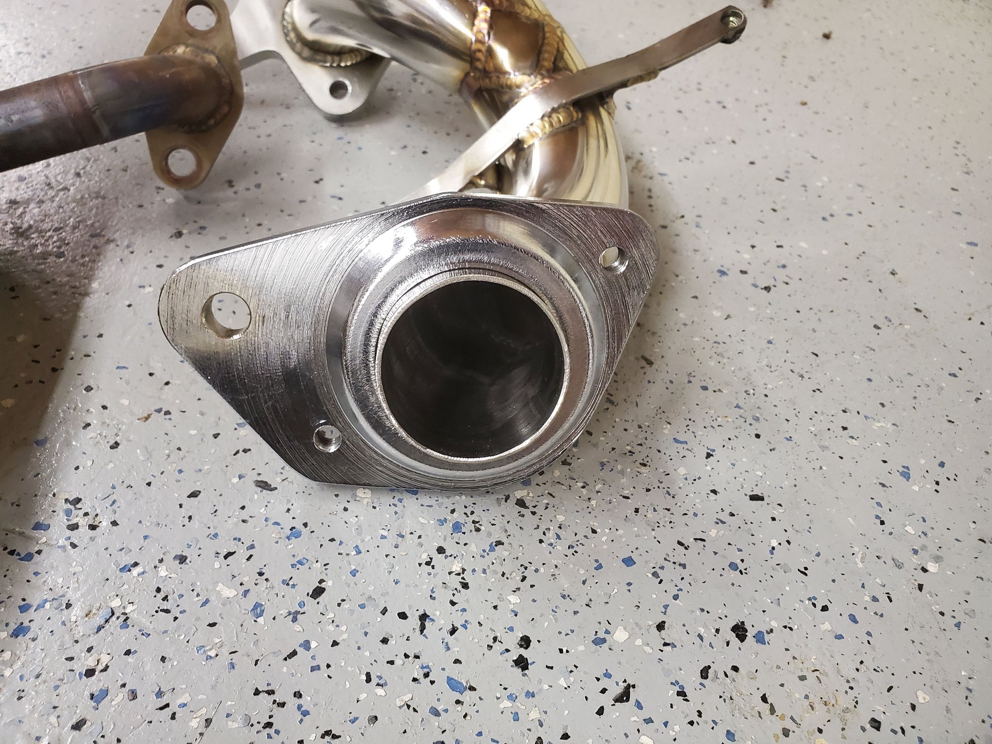

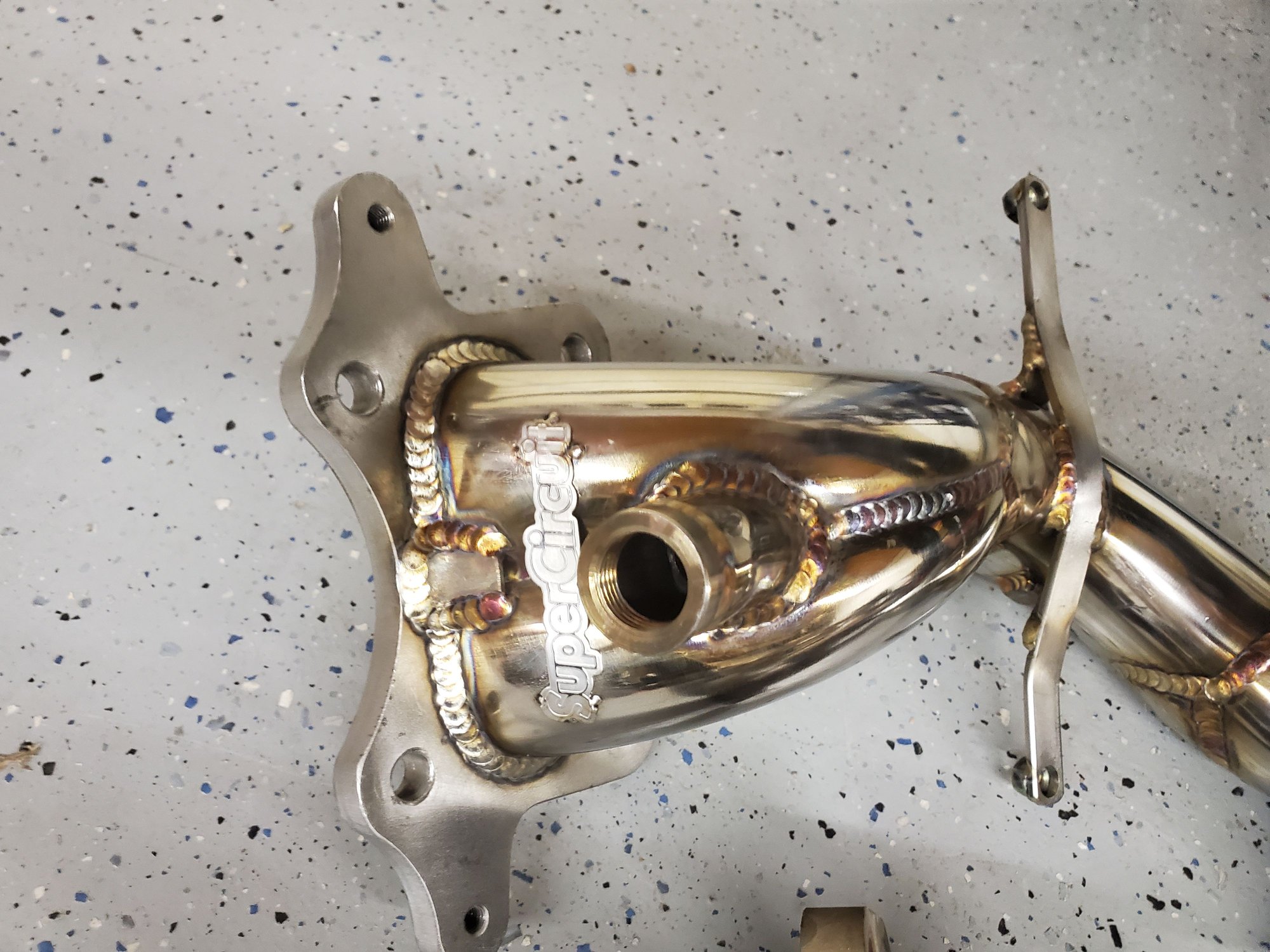

RZCrew GK5 2 in 1 Super circuit header
Here's the header. It says 2.5" collector, and it is... but the inside diameter is 1.875"
Maybe it's acting like a long tube header since the pulses of the exhaust will combine better...
Here it is next to my RV6 down pipe. That inside diameter is 2.25". I'm going to throw in the RZCrew and hope for the best. If i don't hit 200hp on the first dyno pull, I'll chop off the RV6 at the neck and go 2.5" from there...

Those are some beautiful welds!

RV6 quality is much nicer. And closer to OEM spec. Not sure about that other one...

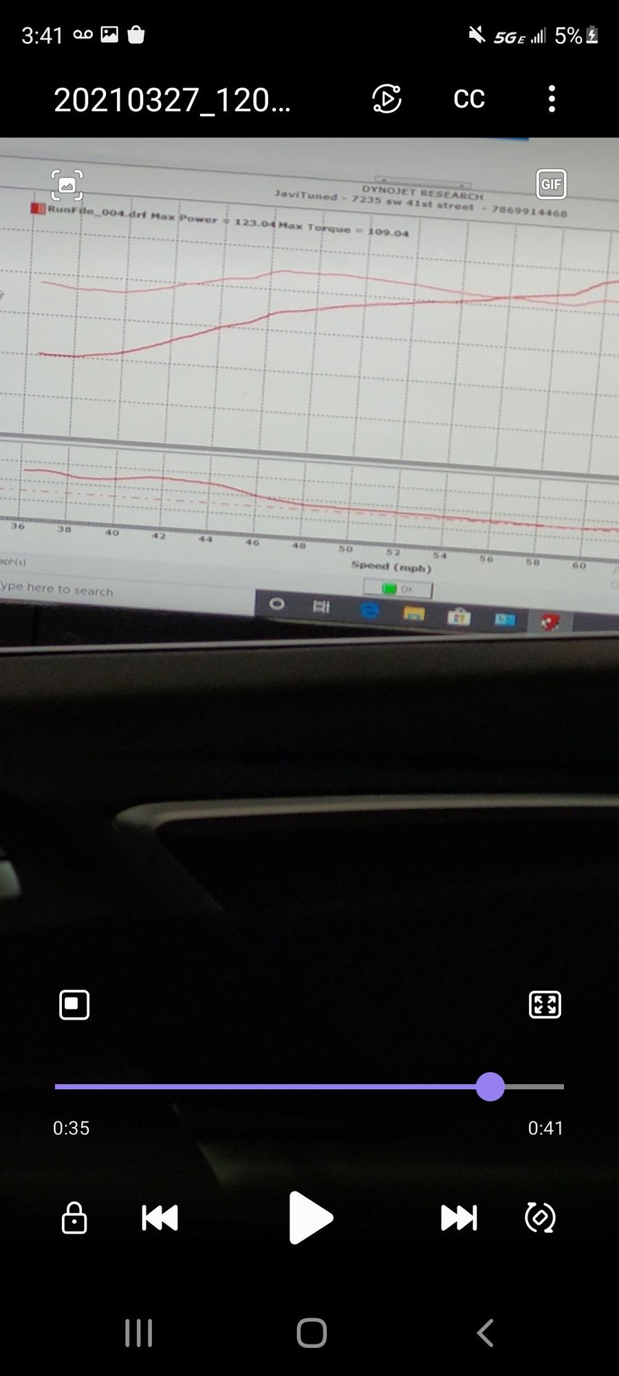

well I picked up 6 whp and 2 ft lb. torque with the 93 octane tune and 2.25 straight pipe on the cvt.
