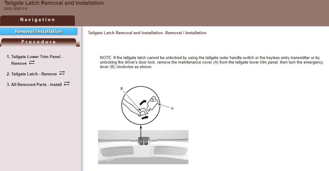

try this

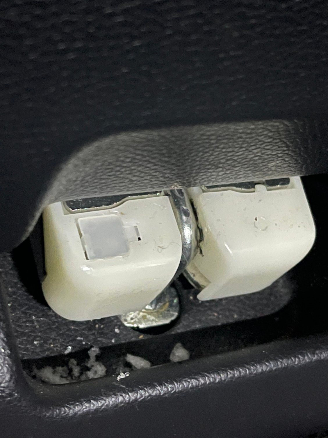

Hi and thank you. However the item , emergency lever in the diagram above is Not in my Honda Fit exl 2016 . There is no release button in the Glove Compartment , as there is in some models . There does not appear to be any way to open this manually or in emergency mode ??? There is no Access Panel in the Hatch wall as there seemed to be in a previous model . This is crazy , there has to be some way to open this thing ??

it's not on the wall, it's on the white plastic part on the latch. it's tiny and very hard to miss.

Thank you for the help but neither answer is really applicable ...looks like . This is a Fit with Keyless Entry . There is not really a handle / latch on Hatch, just two buttons . The plastic cover shown in the diagram above is not there in my Fit ( Exl Fit 2016/ Keyless Entry ). None of the solutions so far apply to this particular model , seems the Keyless Entry makes the difference. Thanks again for the help .

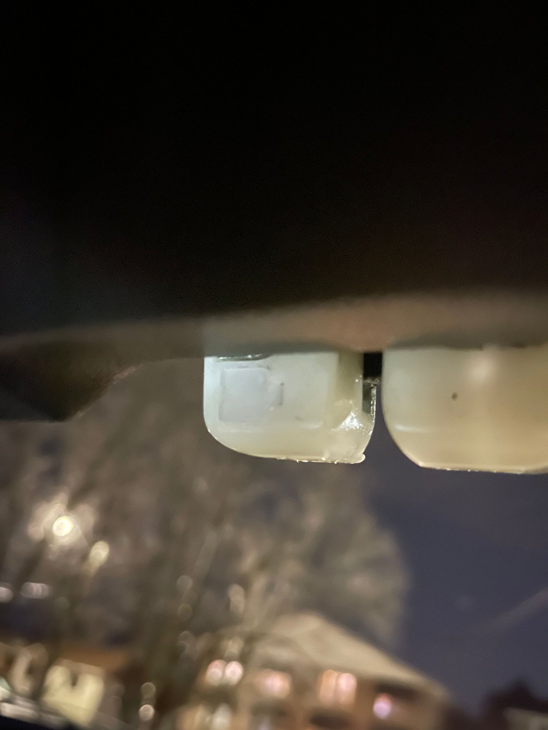

I don't know of any Honda Fit/Jazz that uses an electrical actuator for trunk release, I could be mistaken but AFAIK every Fit uses a little handle to open the hatch. Can you take a photo of the hatch area like in the video? Just angled up from the licence plate area? Not sure about these buttons you're talking about but a photo might get everyone on the same page.

Originally Posted by howarejew
This is the correct method, I checked on my car and it's hard to see, please check your's to see if you can see it. Otherwise all I can think of is maybe pressing the button and having someone push from the inside. Or maybe there's a valet switch

Hi there , Yeaaaa !!! it worked , your detailed photo did the job. I want to express my thanks to all of you and especially to Howarejew...I owe you my friend !! Even the dealer did not have a solution , did not know that this little latch existed !!! Dealer had no clue how to open it .
Just one more thing . It it a solenoid or a little motor that actually opens and closes the lock ? Or possibly a cable that activates the lock . . I've ordered the lower part , the part with the hatch so I will know when I see it .
Thank you again for all the help and especially for the photo , that nailed it !!!
