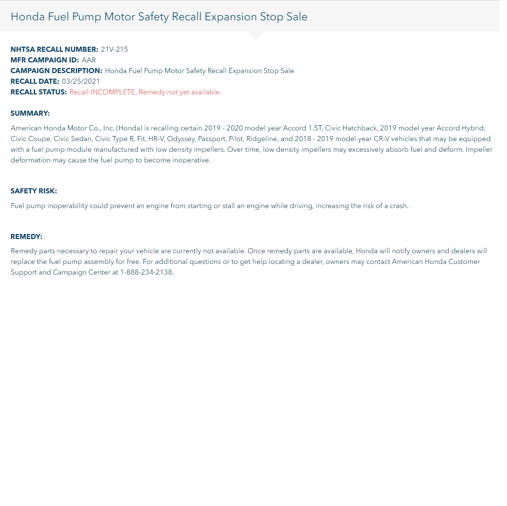

Here's the verbiage:

Honda still has no remedy for mine (1 month after the notice went out):
there are supply chain issues due to the factory shut downs last year , it's been gumming up the works for quite a few auto makers
