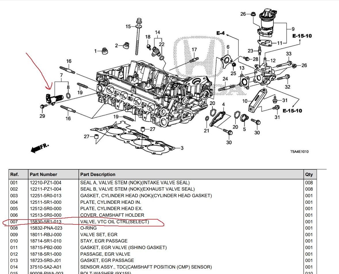

In the middle of replacing the timing chain tensioner on a 2015 Fit and somehow managed to destroy a sensor. Spent some time on Google and couldn't identify it. It's right above the alternator. Picture attached. Does anyone know what it is so I can order a replacement? Any help is greatly appreciated.

Thanks, appreciate it!
