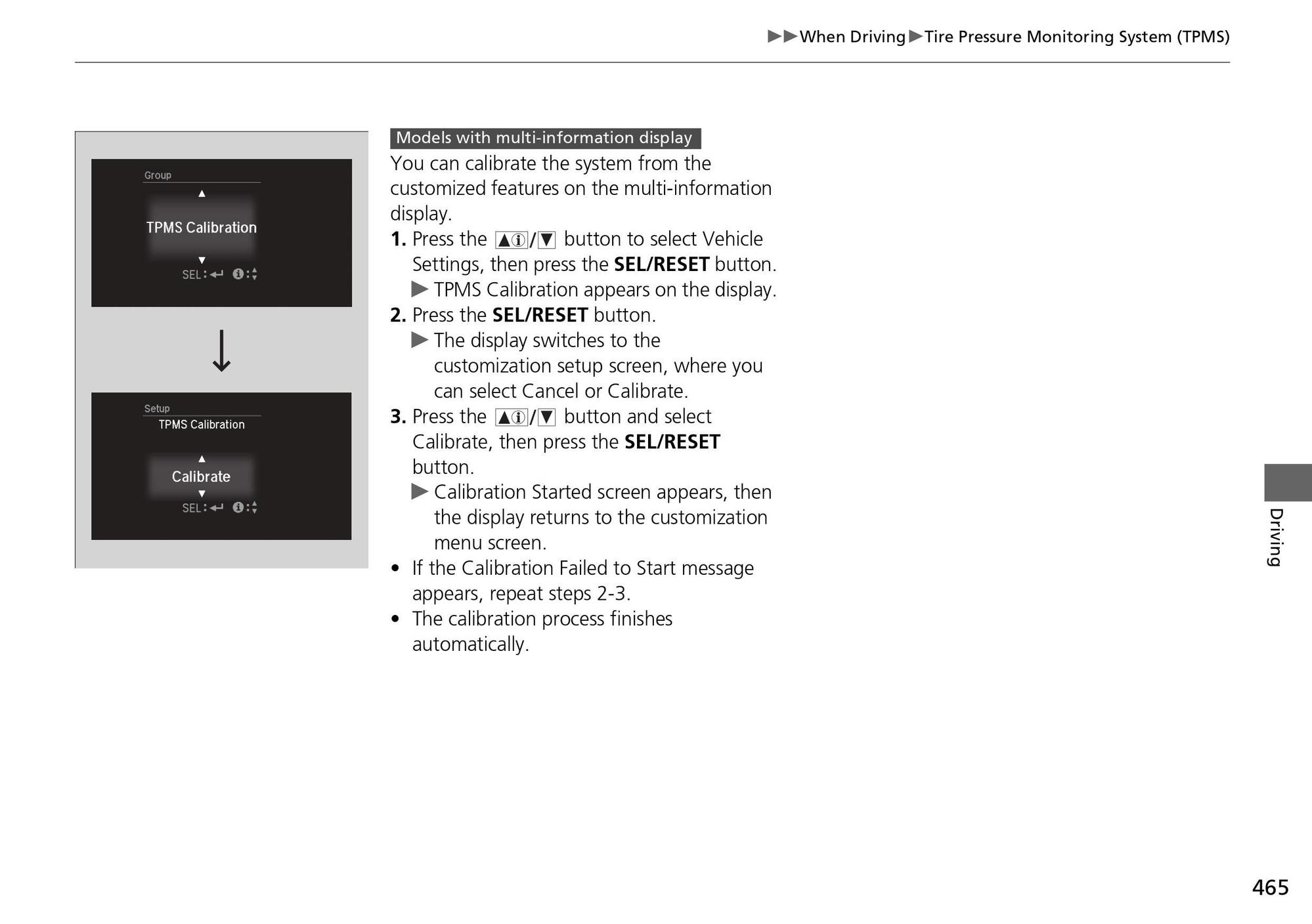

Hey there!
I own a 2018 Fit Sport model. Recently my low tire pressure indicator/TPMS light came on. I corrected the tire pressure. I have been unable to find the vehicle settings to recalibrate. I DO NOT have the buttons on the bottom right of my steering wheel. Also I have been through my display a lot and there is nothing on there for vehicle settings. I've been through my manual a number of times and still no answer. Can someone out there help me out?

see if this helps

I have 2017 LX. The rectangular button with the tire icon is on the left side under the round green econ button. While driving, push and hold until the fault indicator lamp goes off.

Thanks so much for this info. I don't have those arrows in the pictures below to select anything. They just plain don't exist on my model. It's driving me mad. Ha! I must be able to access the vehicle settings somehow.

I found that button way below the Econ button like you said! Wow it was really hidden. I drove it and pressed it. It is now recalibrated thanks!
