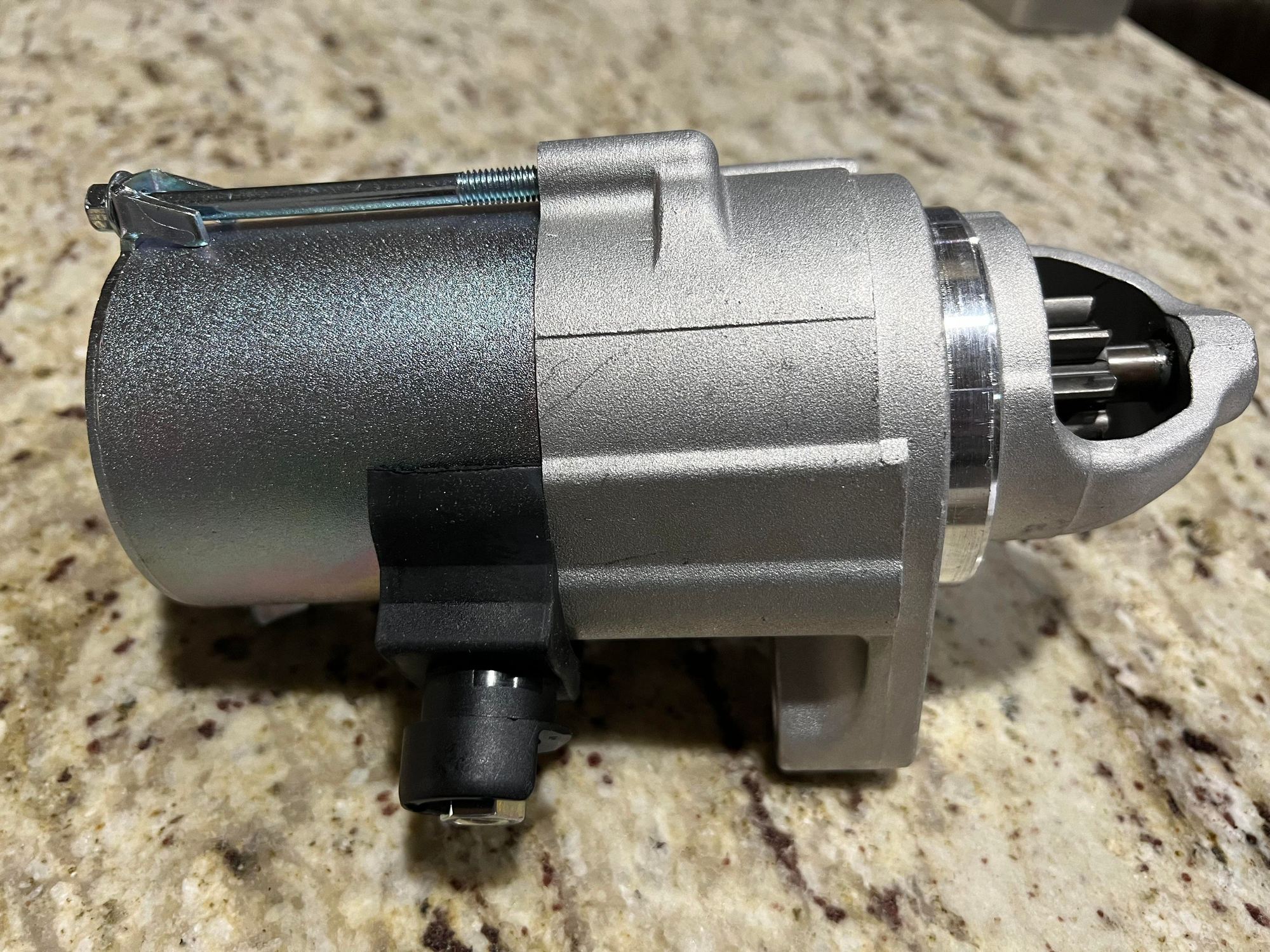

Received starter from amazon open box item. Looks good. Is this Re manufactured Honda part? If it works after fixing, i am good to go right?

Old Dec 25, 2021 | 12:04 PM
bargainguy's Avatar
Posts: 1,061
From: New Mexico
If the starter is the problem now, sure, but it's only buying you more time, not a better circuit.
You didn't mention how many miles are on your vehicle. If my assumption about circuit design is correct, you'll be looking at both a new starter and stop switch in however many miles you have now, and of course, neither will be covered under warranty.
I really wish Honda hadn't cheaped out on circuit design just to offer pushbutton start. This is most likely the result of cost-cutting in an effort to offer an entry-level vehicle into the Honda marque, and most likely the reason they abandoned the Fit for the US market - too expensive to manufacture and maintain, given the problem areas we know about now.

Thanks for the information. Honda shop replaced stop starter switch 2nd time. Recommended starter replacement. Honda is not acknowledging circuit design issue. They do not agree that stop start switch issue and starter issue are related. They are claiming that starter issue is normal mechanical wear and tear and nothing to do with Start stop switch/circuit.
