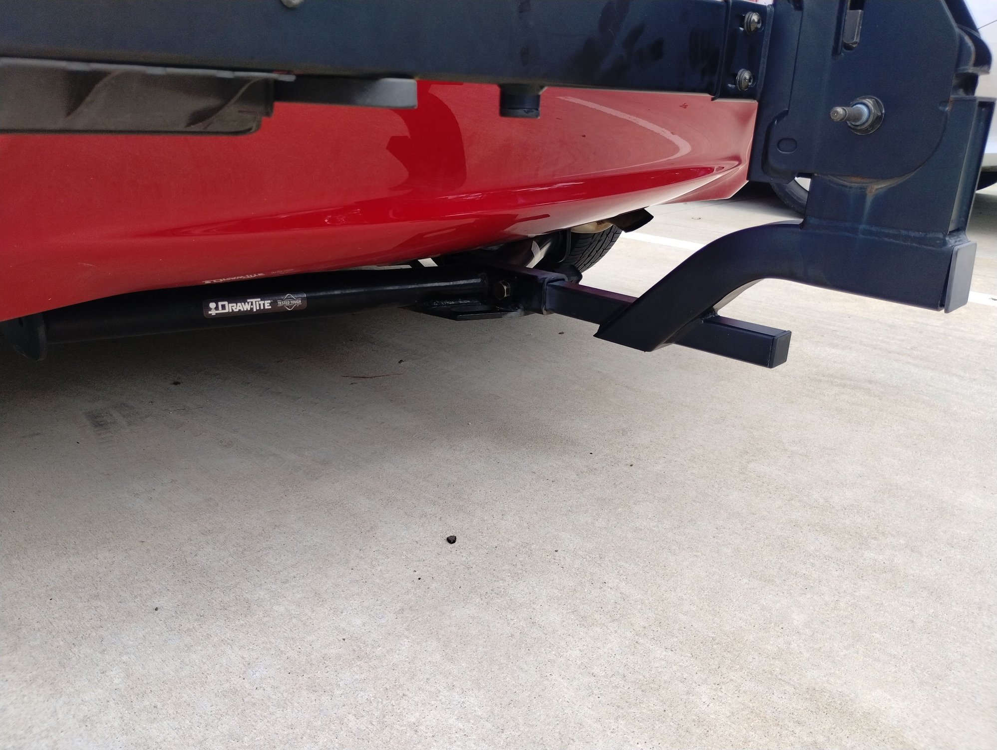

I run this draw tite hitch on my 2018 Sport, it's pretty great (minus the aforementioned muffler rubbing one of the bolts, but you can fix that with bending the hanger or getting a slightly longer exhaust hanger isolater). I have a 1.25 inch Saris Superclamp EX2 which works very well.
In terms of clearance I've never had issues with it scraping, even while driving some rather hilariously steep roads to access mtb trails. So I'd say unless you're properly off-roading your Fit regularly (and if you are, godspeed) you should be fine with any hitch.
Here's a few pictures for reference of the Draw Tite and my Saris installed.
