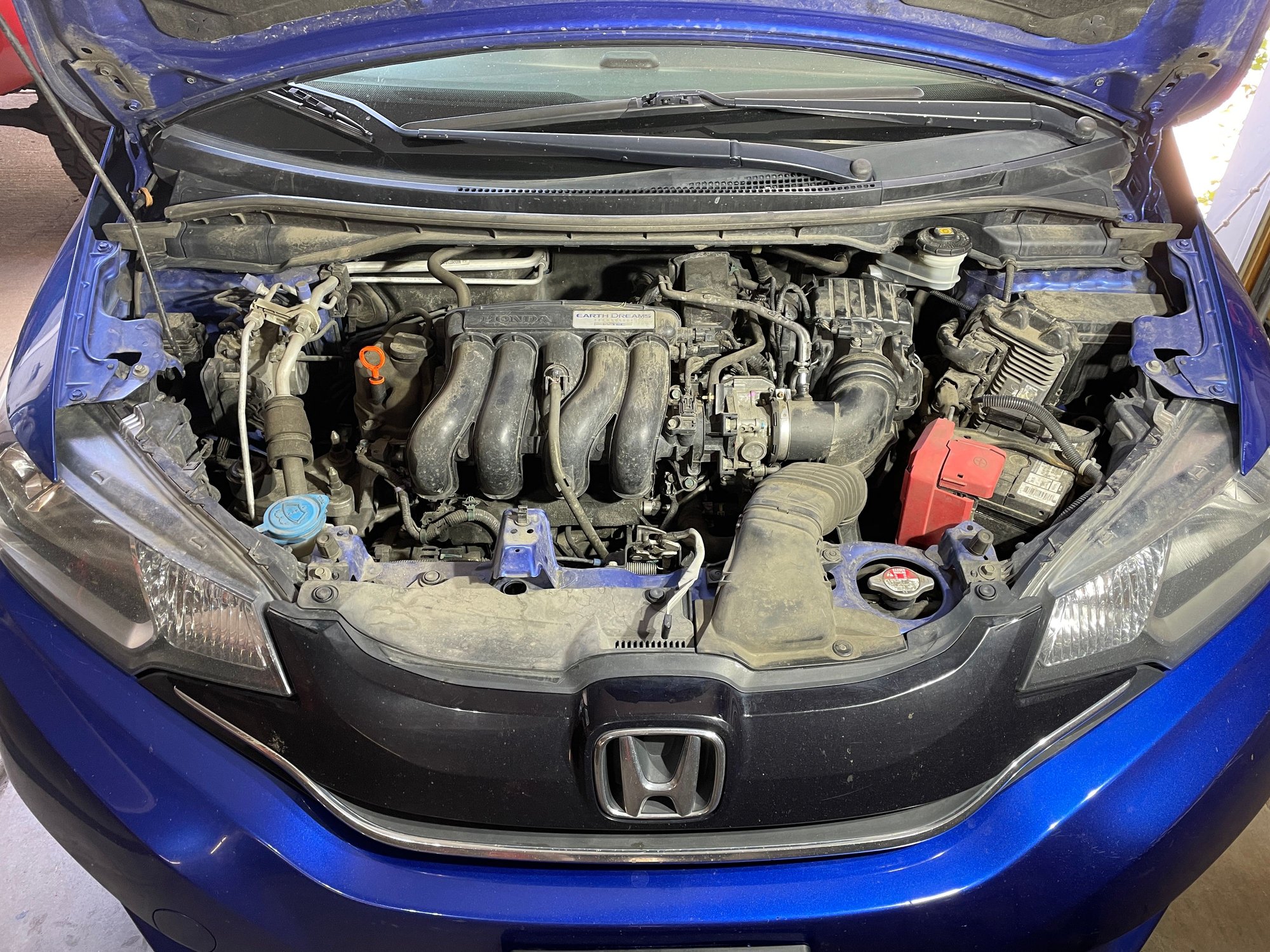

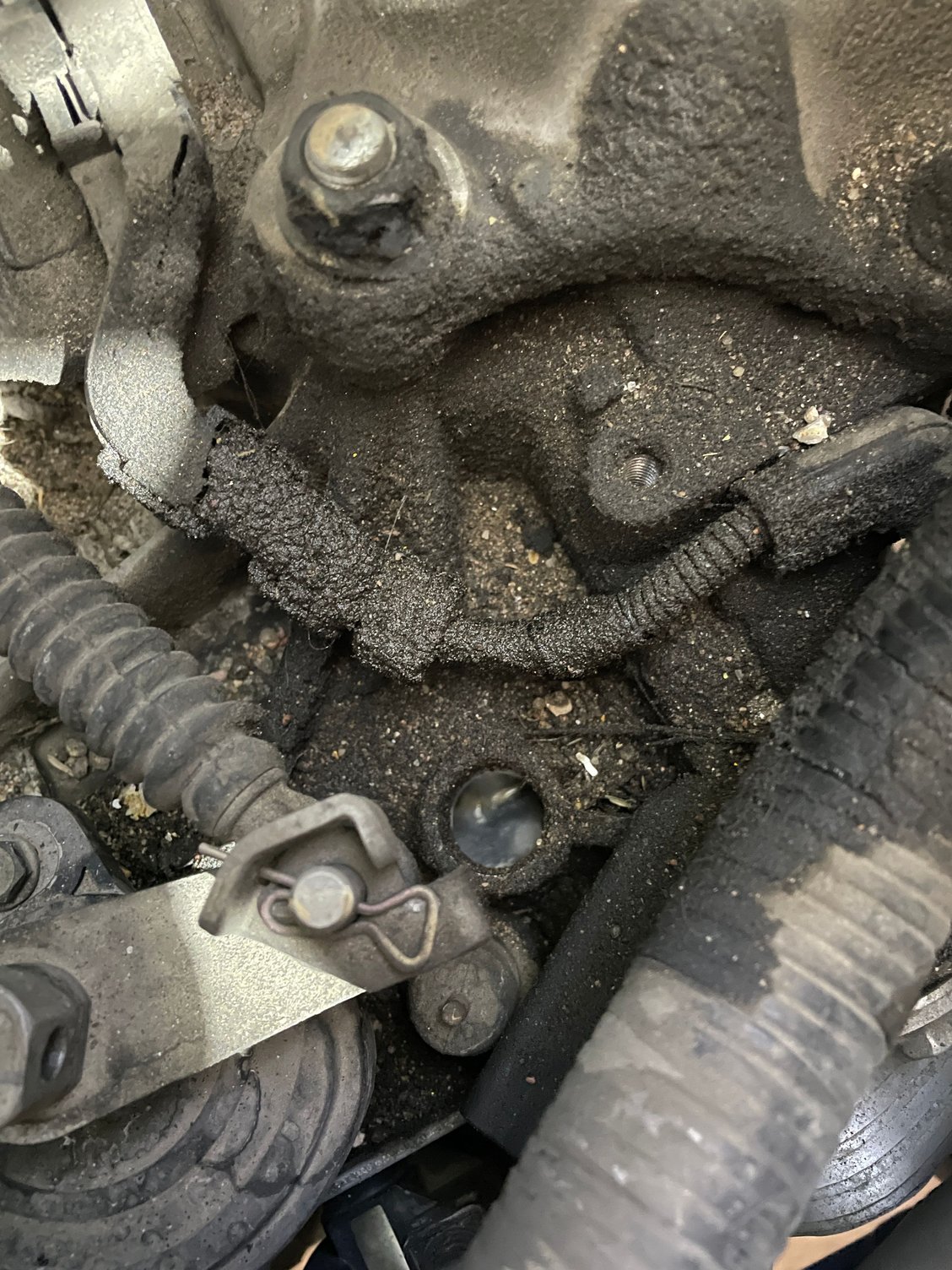

New member, long time wrencher. I am most familiar with Toyota vehicles, especially every generation of Tacoma (currently own a 2016). However, I am avoiding racking up miles and having to purchase a $60k truck in the next few years by sharing time with a commuter car. Luckily, or maybe not so much, I found and purchased a 2015 Fit EX CVT. It was a trade in and in pretty rough shape. In fact, they had not even brought it through the reconditioning department and I bought as-is. 154k on the clock, not a straight body panel, but appeared mechanically sound. I had them put it on the hoist so I could inspect the undercarriage. No active leaking, but signs of previous 'wetness' around the LH axle seal and back side of the timing cover. I also noticed a wet area on top of the CVT, but didnt think much of it. Drove well, started fine and had potential. So I bought it with a grocery list of maintenance items needing completion.
First up was changing the CVT fluid with some fresh HCF-2. I wanted to utilize the actual fill on the top of the trans, so off came the airbox. And thats where the concern began. The fill plug was missing! And that wet area was in fact fluid spitting out of the trans! I found the plug next to the hole covered in grime and I'm sure is absence introduce a wonderful amount of debris into the trans. I drained the fluid which was fairly dark, but minimal metal collected on the drain plug. So, fingers crossed that I can get another 150k out of the trans. I plan on doing one more drain and fill just to be sure.

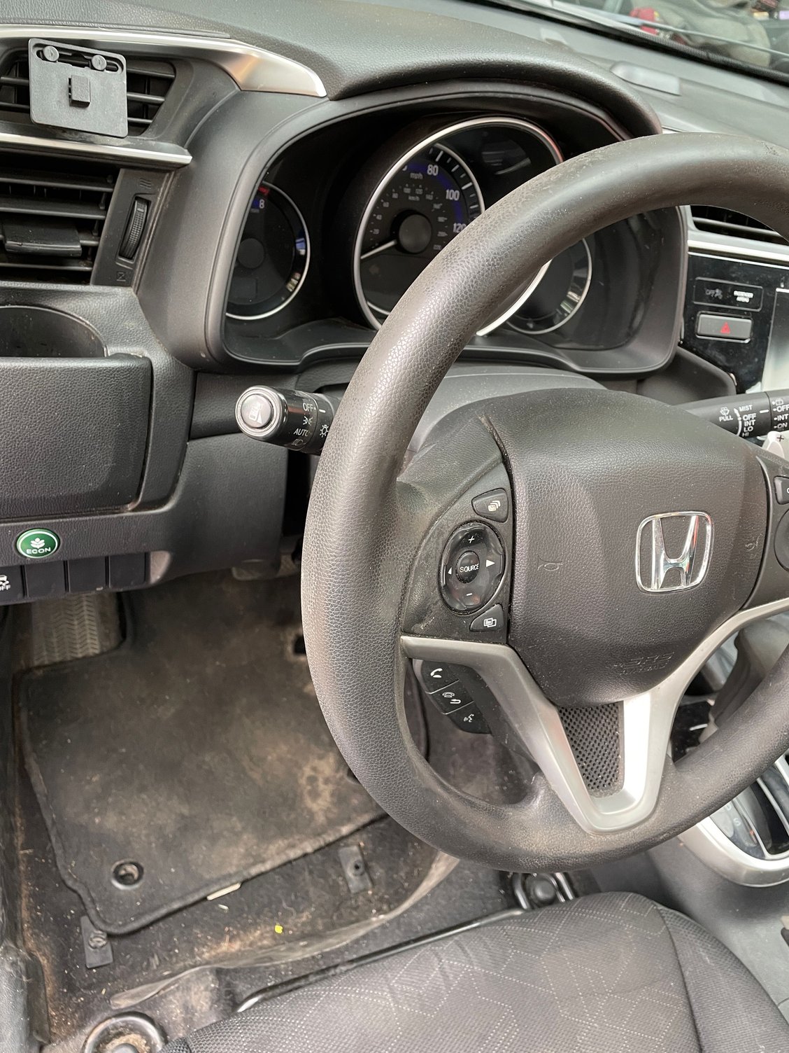

Heres the interior before
French fries... yep.
