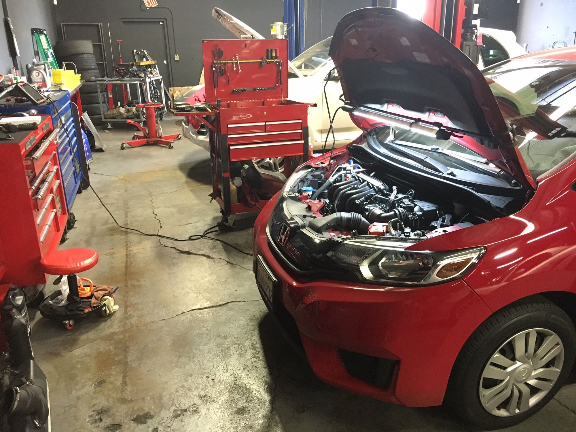

circled in red are where you need to disconnect things to remove the air filter box. 2x 10mm screws, a hose with a clamp on it, and a rubber boot you can just pull by hand.

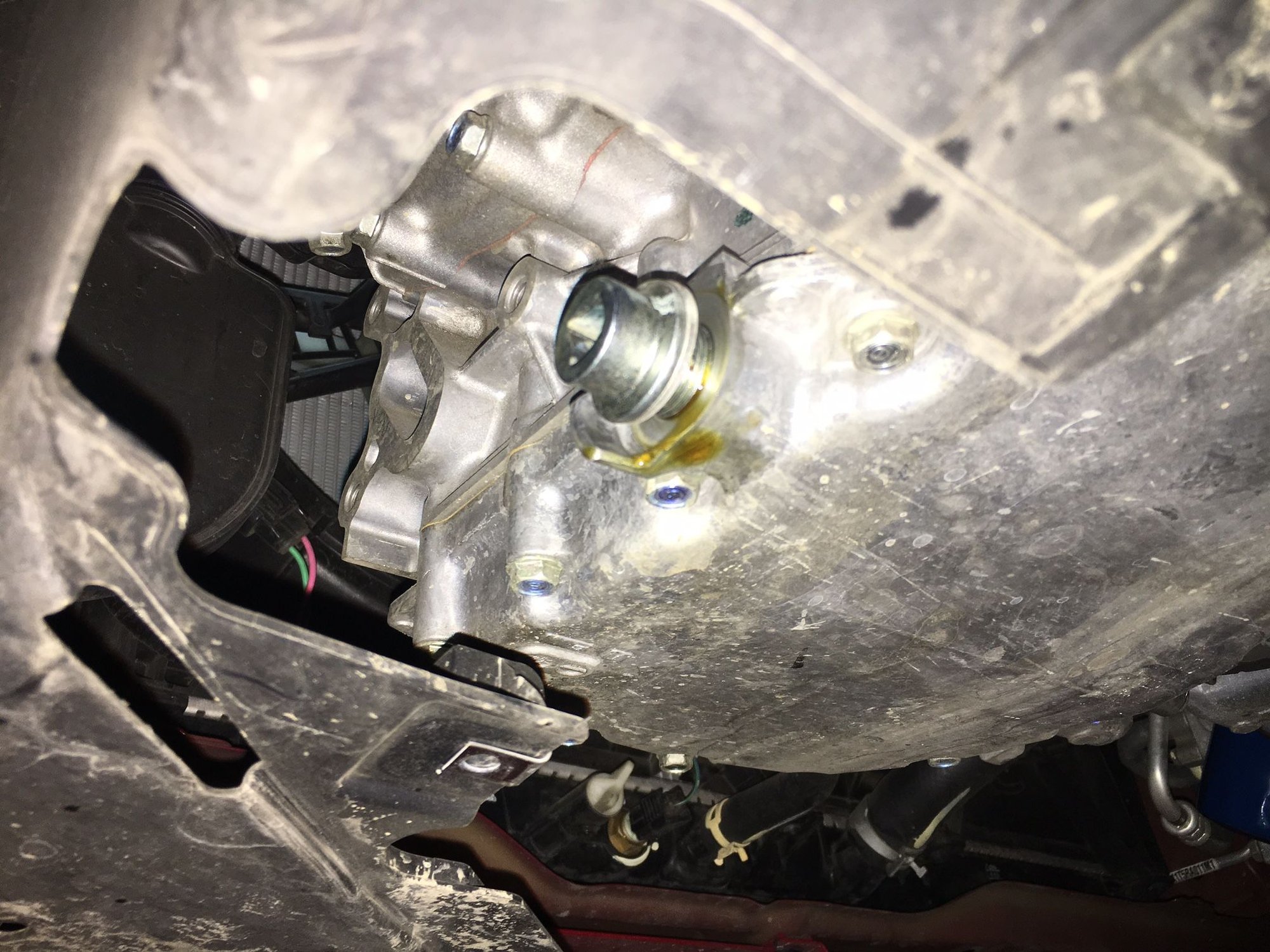

CVT fluid drain. 3/8 drive.
drain plug for CVT has a magnetic tip. don't forget to clean it off.

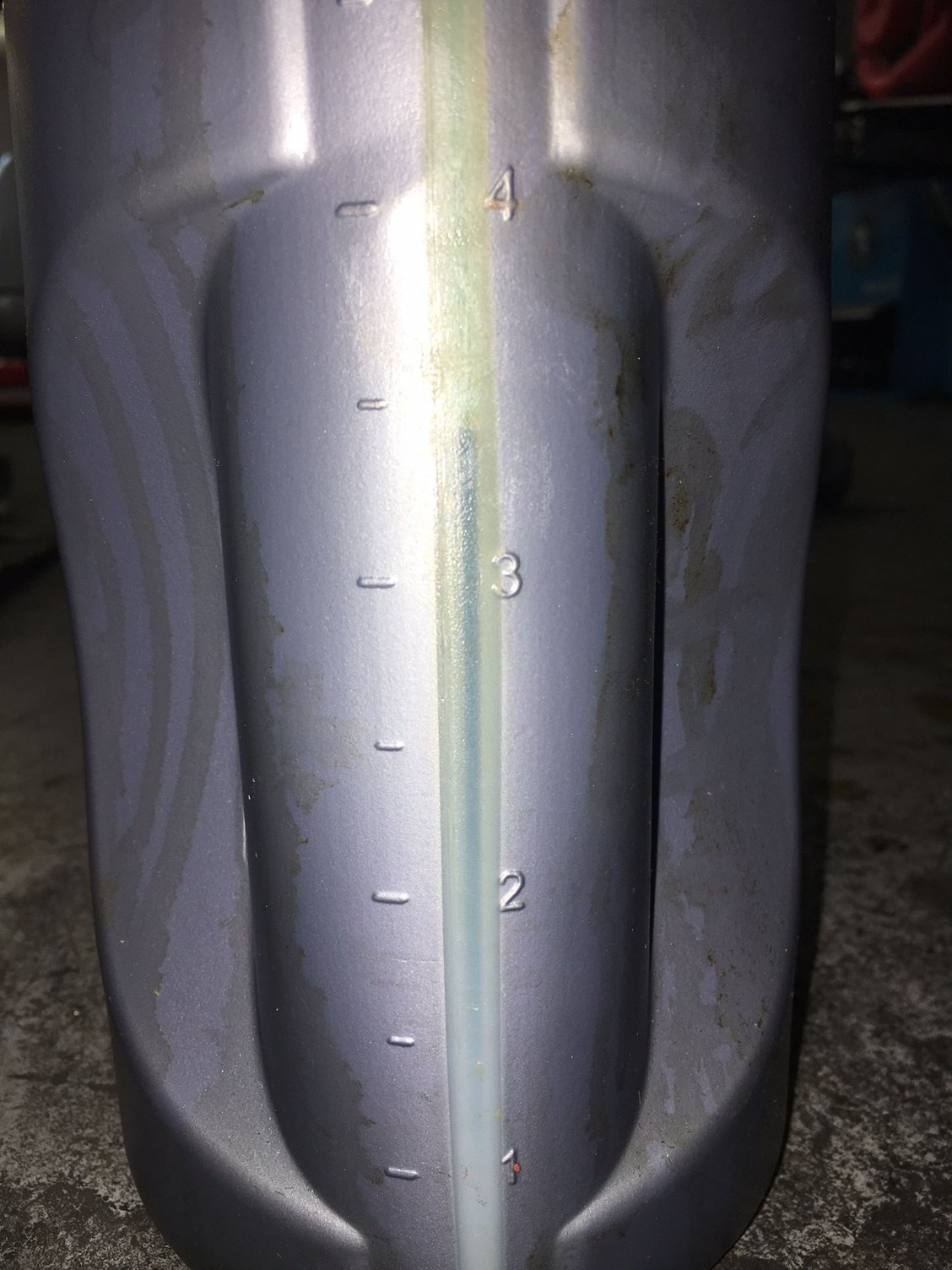

captured exactly 3.5 qts.

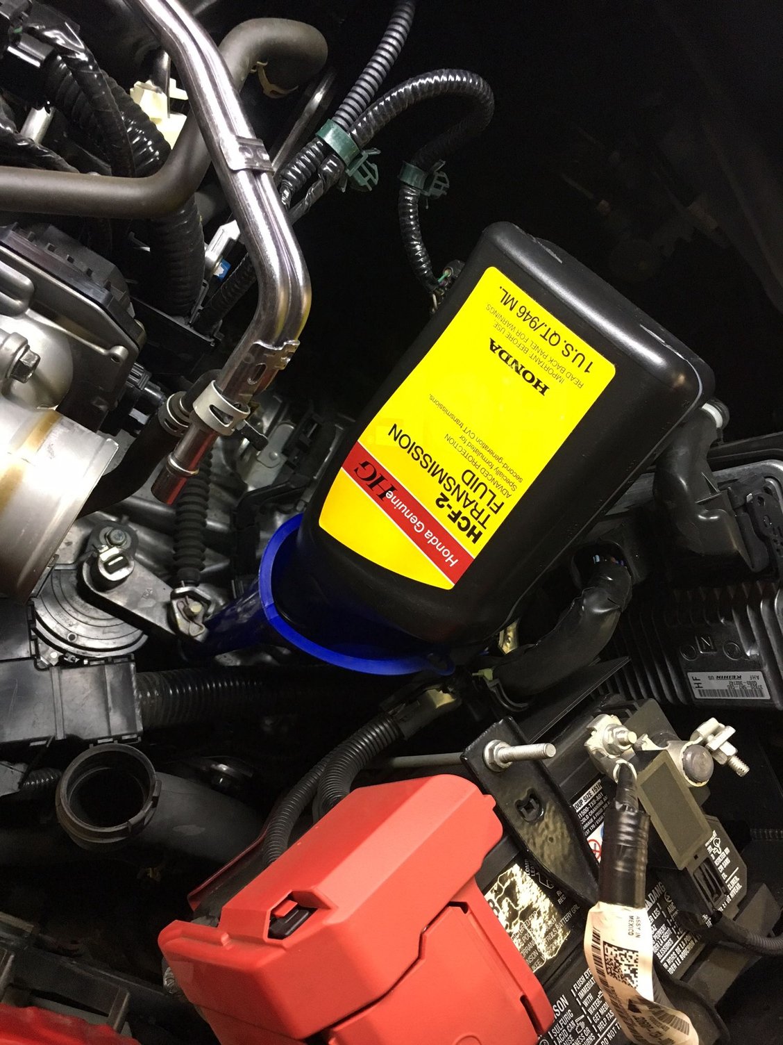

with the air filter box removed you will see a rubber plug with a metal tab sticking out of it. you just need to pull it out to fill.
use genuine fluid. i just put back in the amount that came out. 3.5 qts.

Nice garage you have there.

Thanks for the write-up. Your engine bay looks real clean. And yes, that is a nice garage.
