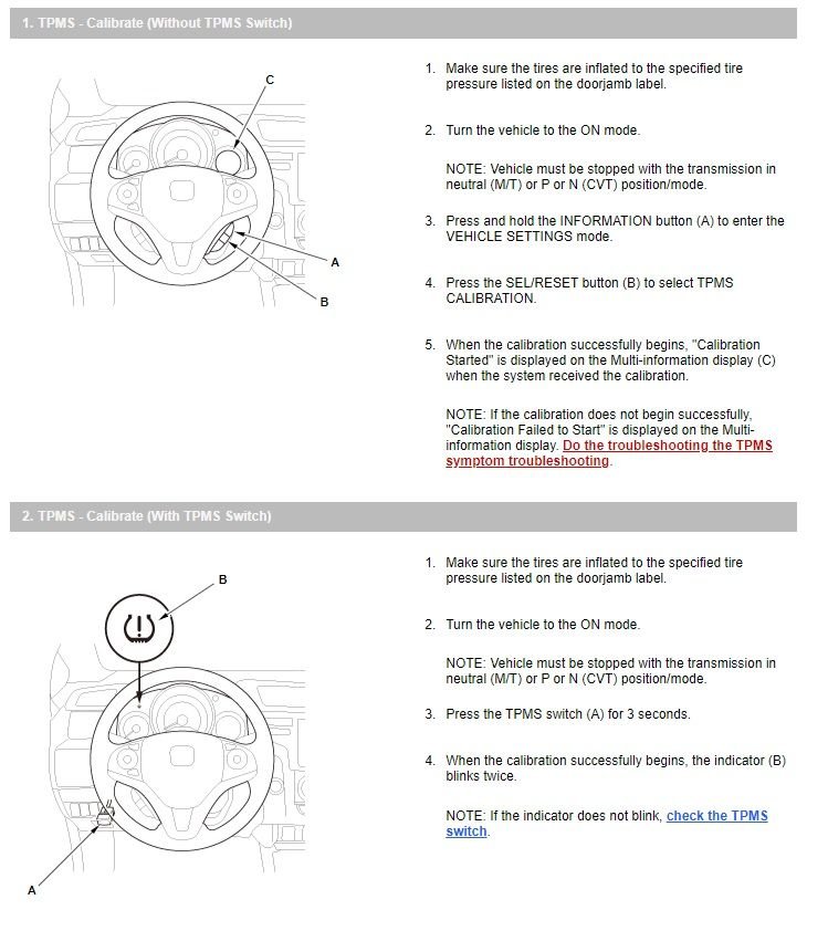

Step 1: Remove the VSA module
Step 2: Install new VSA module
Step 3: Bleed the brakes
Step 4: Connect to HDS and check for software updates for the VSA module
Step 5: Perform VSA Sensor Neutral Position Memorization Procedure
Step 6: Calibrate the TPMS
Step 7: PROFIT
