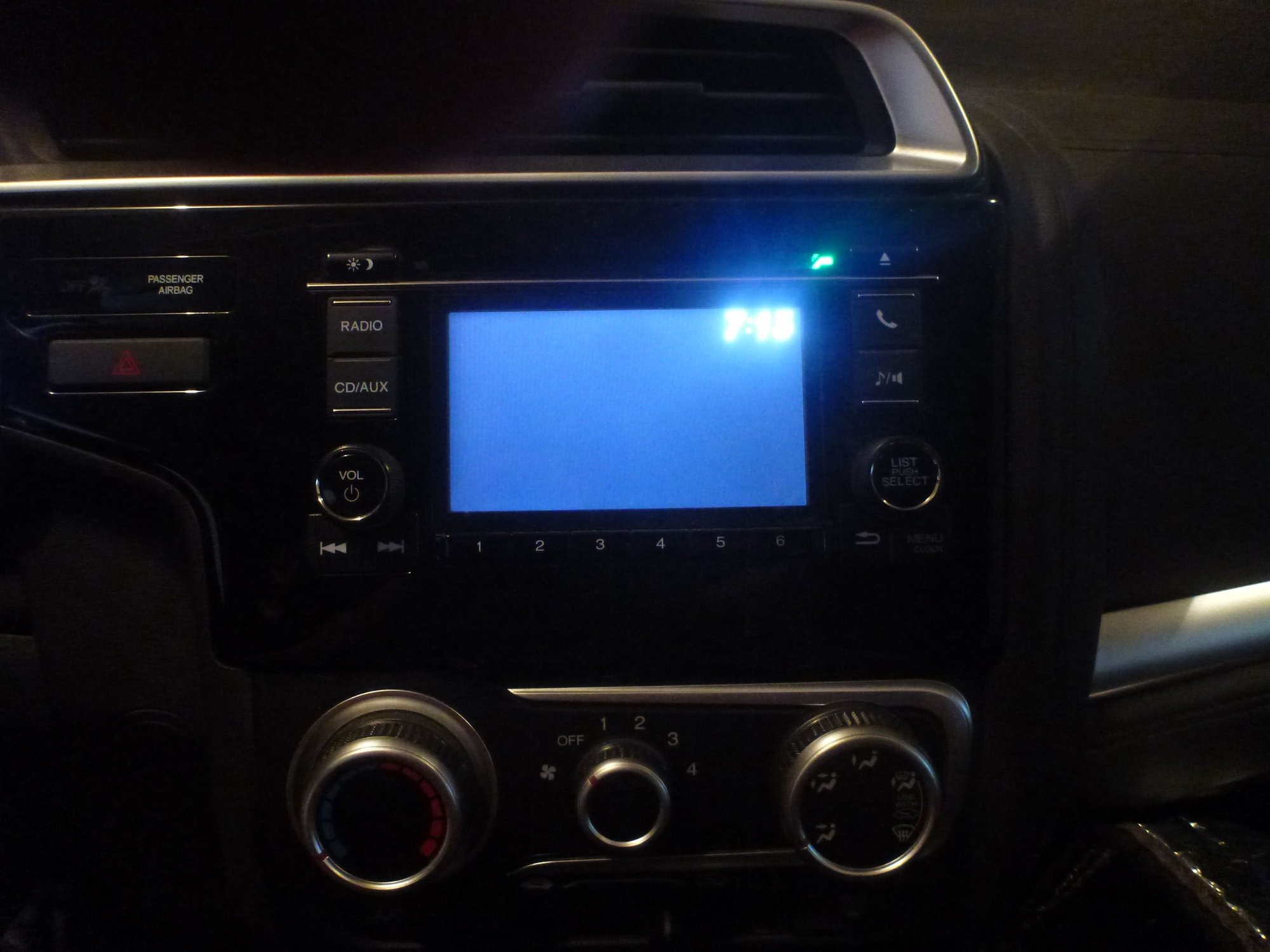

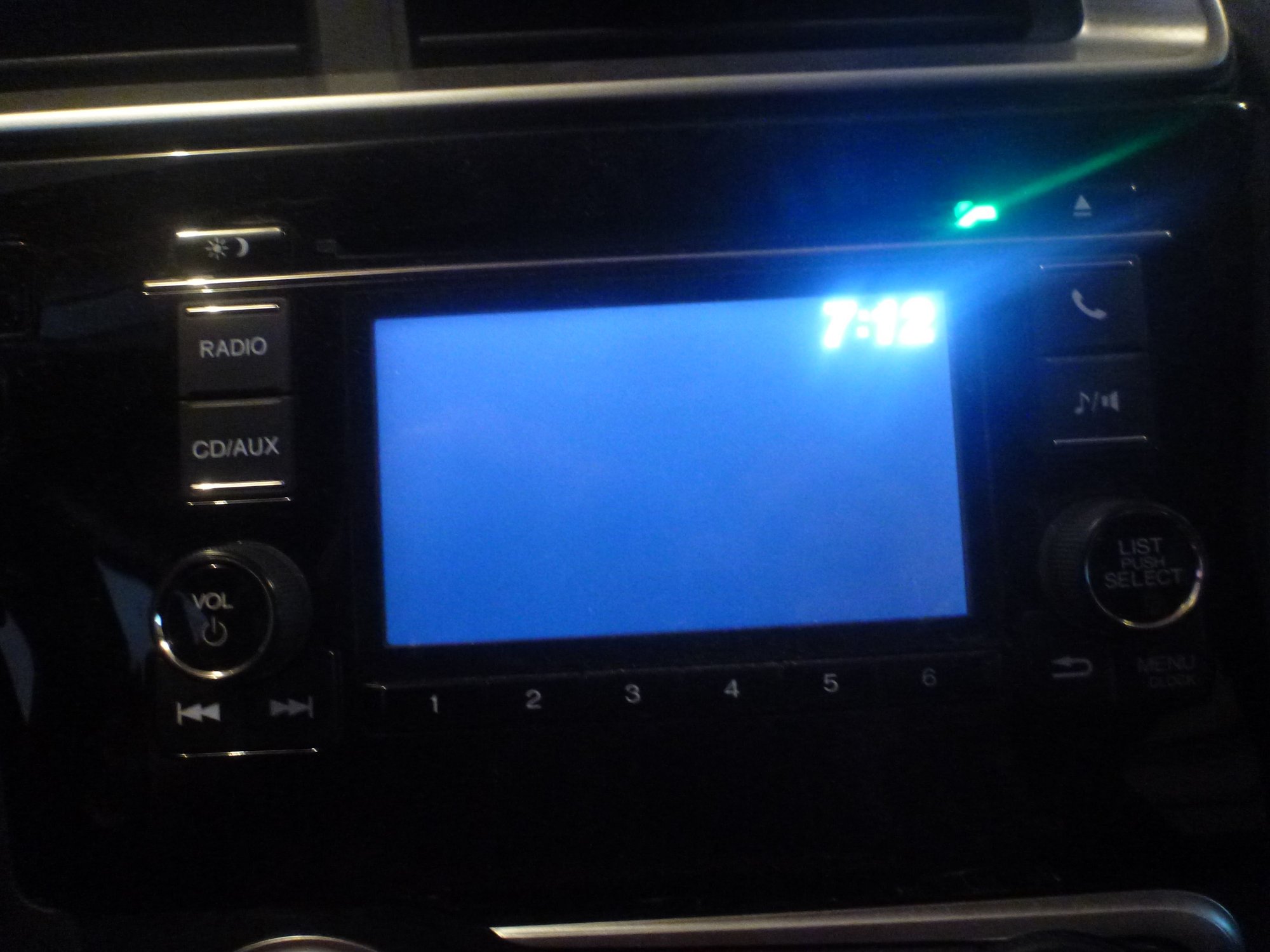

black screen with time in upper right corner
Black screen with time in upper corner. Radio plays, but this is the only screen we get.

I still think your display brightness is turned all the way down. That would explain the clock functioning (always on no matter screen brightness) but nothing else visible.
Owners manual, p. 169, states that the "brightness" button (sun/moon icon) is used with the right selector knob (List/Select) to adjust display brightness. Press brightness button, use selector knob to increase, done.
It also states that each time you press the brightness button, it toggles between daytime mode, nighttime mode, and off. So if you're pressing the button without using the knob, it probably doesn't do anything other than toggle, which doesn't get you your screen back.
