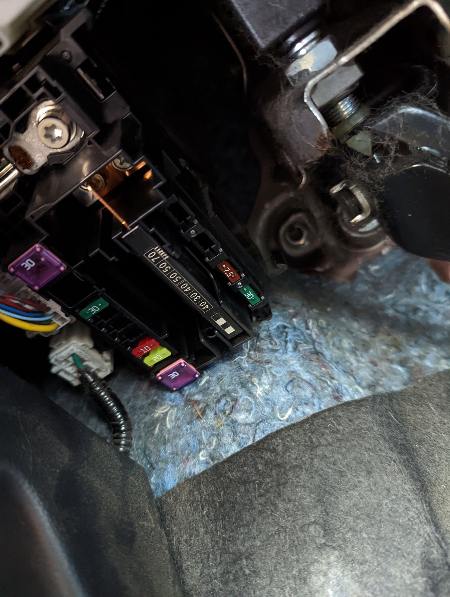

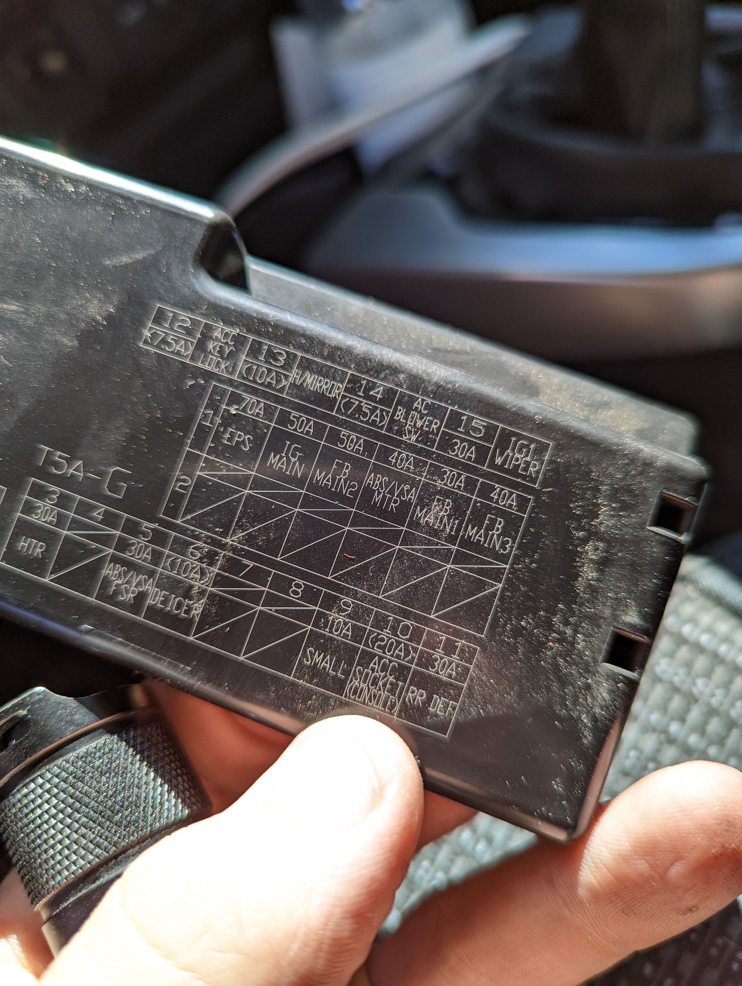

Hey all, AC was totally working fine on my 2015 Lx just a day ago but for some reason when I went for a drive yesterday afternoon the AC just decided to stop working.
I replaced the compressor when it was squealing like crazy when engaged around ~50k but the car is now at 151k.
I've done this troubleshooting so far:
  1. Checked 7.5A fuse #22 under the dash labeled "A/C". Looks good.
  2. Checked 7.5A fuse #14 under the covered fuse box area labeled "AC Blower SW". Good.
  3. Checked Low side pressure, shows that system is overcharged, but since the compressor isn't running I don't believe this is an issue. I verified by checking another cars low side pressure while the car was off and it was around the ~70psi mark. I did not add any refrigerant to the system today, nor have I ever since the compressor was replaced 100k miles ago
  4. Checked and activated all of the 4 relays that are on the passenger side of the vehicle under a cover. Not sure exactly what those are for, but on the previous generation apparently those controlled the condenser and radiator fan and if they were bad it would cause the AC to not work.
  5. Spun the compressor by hand, doesn't seem to be frozen up.
Anyone have any suggestions? I'm out of ideas aside from checking the voltage at the compressor, I don't know the pinouts anyways, so I wouldn't know what I'm looking for.
Thanks in advance. Photos below:
Four relays that apparently control the fans.
Under dash fuse box, checked #24.
Fuse layout
Checked fuse #14.
Fuse Layout.
Pressure on low side of system. No refrigerant added.

Well it took about 4 hours but I finally figured it out.
The wire to the compressor had degraded and was no longer making a connection. I went to go disconnect it to check the voltage on it, and the whole thing just broke apart. After the wire had come out, with the AC button on and the blower on full blast I used a 12V battery I had laying around and energized the clutch on the compressor. It came to life and started blowing nice and cold inside of the car.
A couple quick crimps and some solder and the whole thing is working again. I'll have to go back later with some heat shrink to solidify it up.
