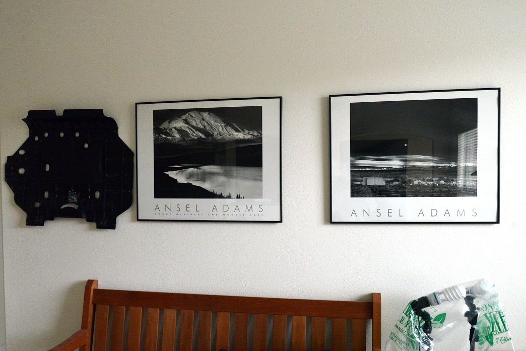

I turned mine into a piece of art after the first oil change. Some incorrectly call it a "splash guard".OK, then they came up with all kind of rationales that it shouldn't be removed without any supporting data. My 2017 LX CVT Fit, 113K miles, constantly getting over 40 mpg.
