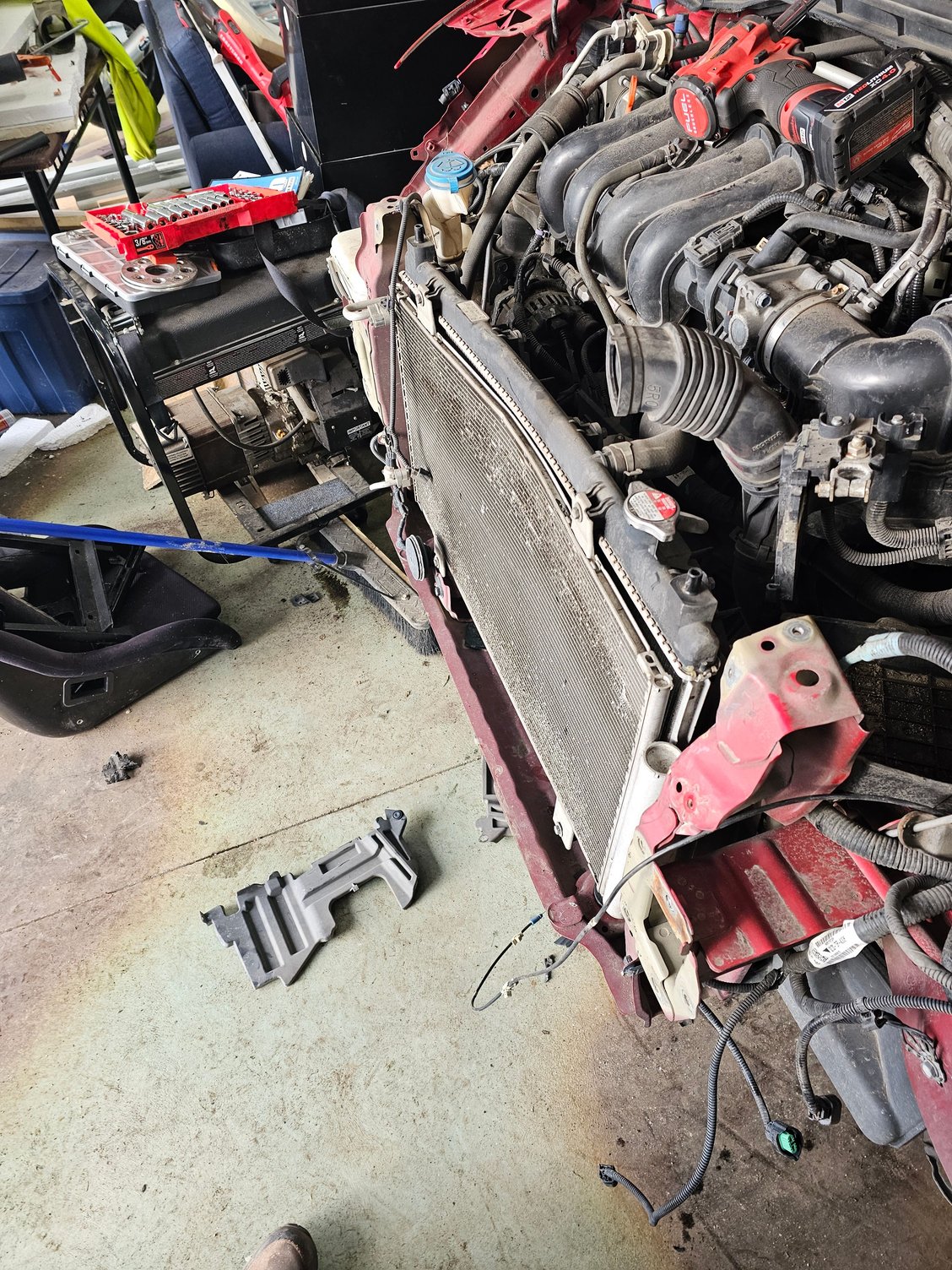

I placed a bid on this 2015 Honda Fit not far from me and to my suprise, I won. Picked it up and assessed the damage. It had obviously been in a front end accident but wasn't sure what else may have been wrong.
My friend who you can see in the picture helped me start it and we were able to drive it onto the trailer.

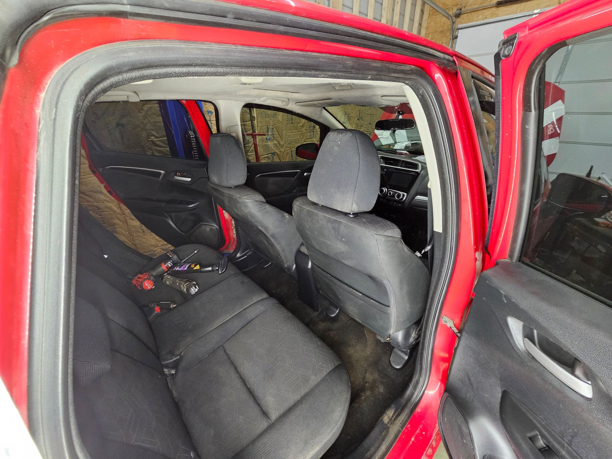

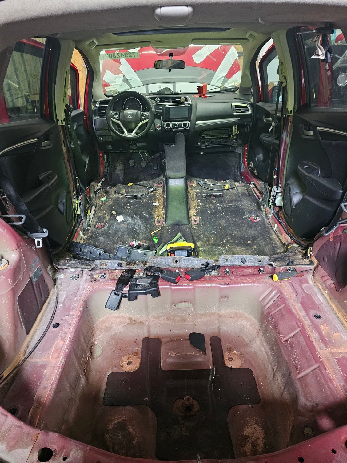

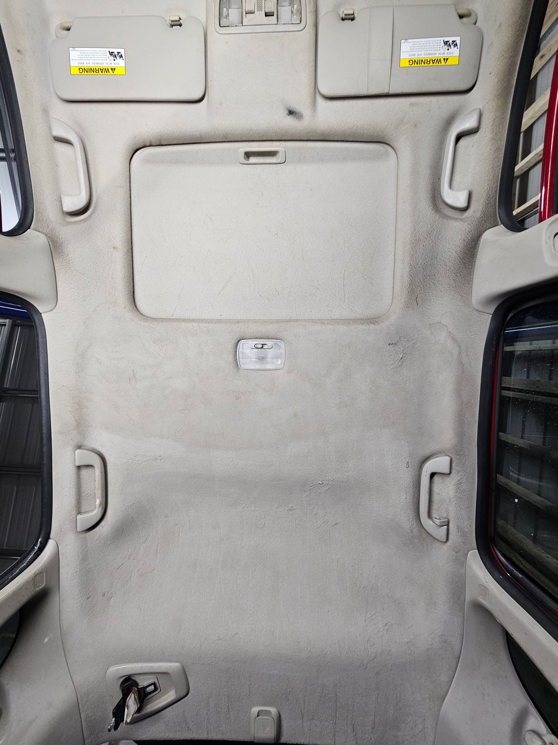

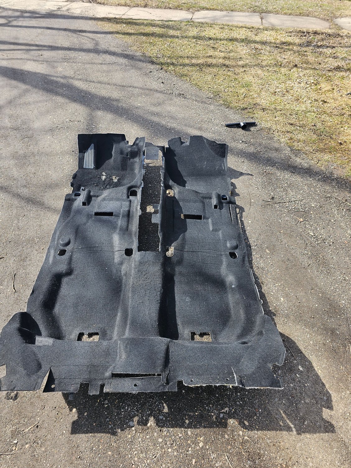

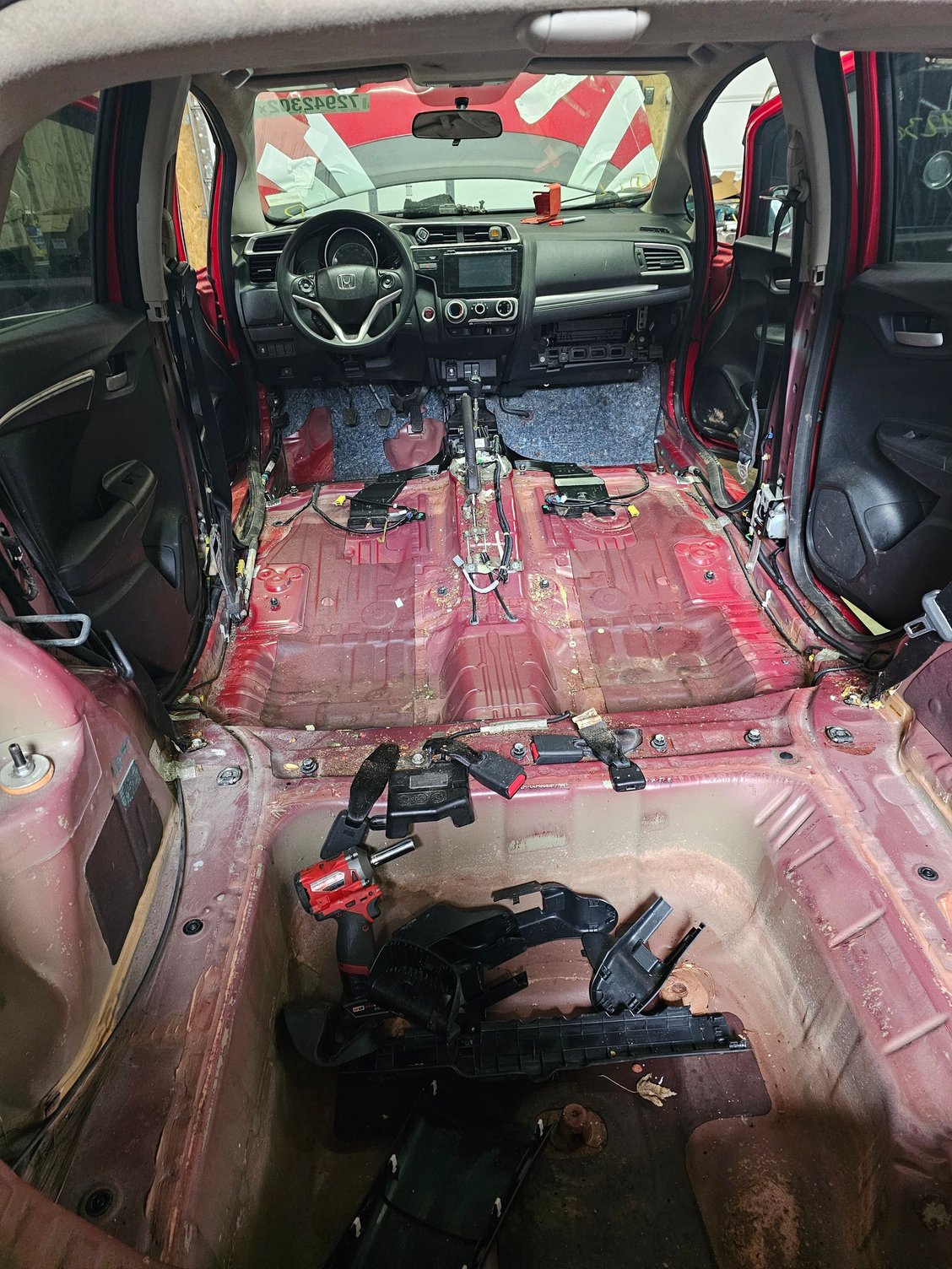

Once I got it home, I can clearly tell it was a smokers car before due to the smell so I decided to pull the entire interior and clean everything throughly.

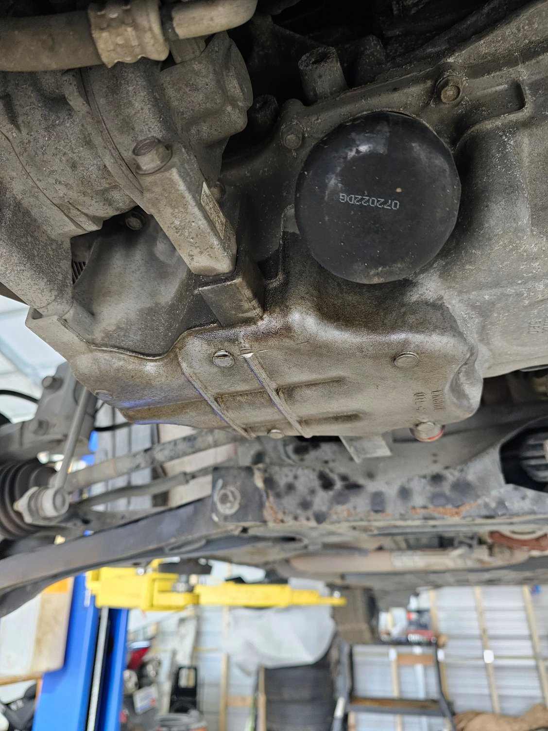

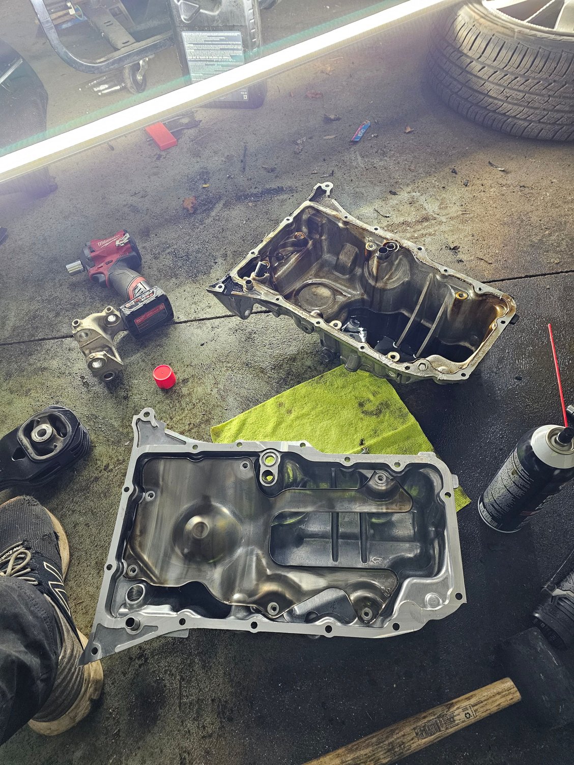

Now that the interior was taken care of, I moved on to the mechanical side. After the car had been sitting in my garage for a couple days while I cleaned the interior, I put it on my lift and noticed a puddle of oil under the car. It didn't take me long to find the culprit. There was a gas in the oil pan, which I can only assume came from when the auction yard brought the car out on their big fork lift and one of the forks clipped the oil pan. No big deal, ordered up a new oil pan and some other oem bits from my local dealership for that job and took care of it right away.

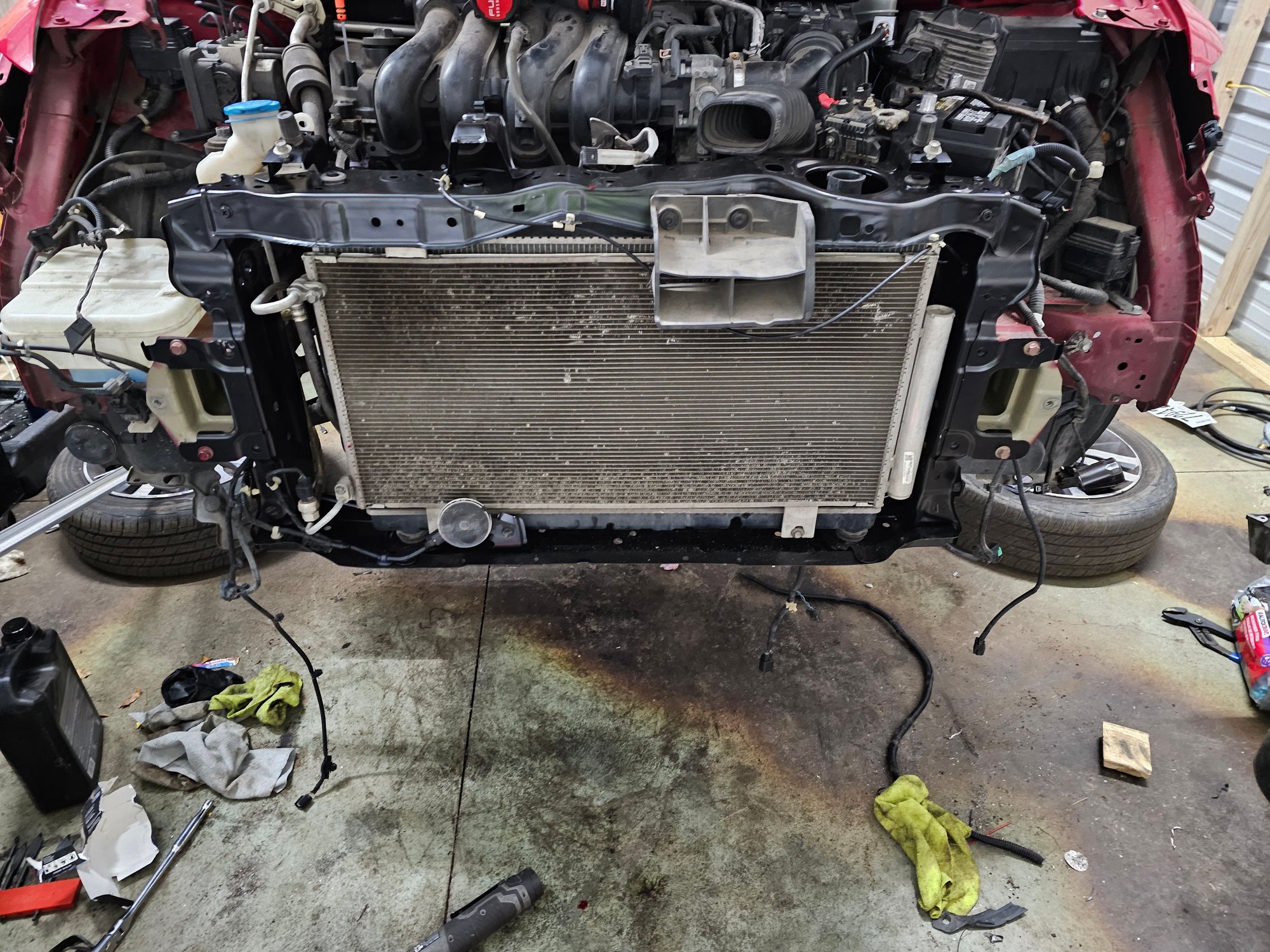

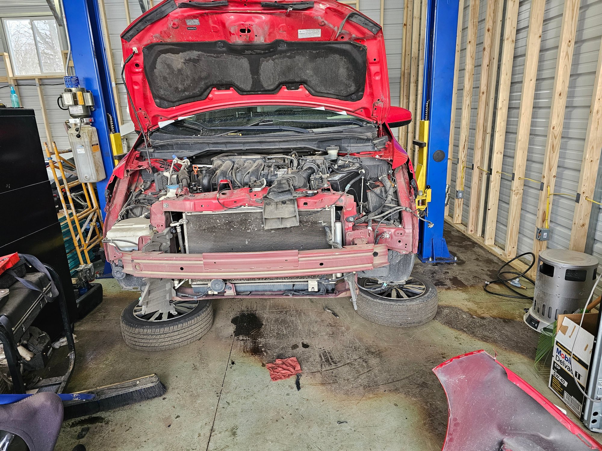

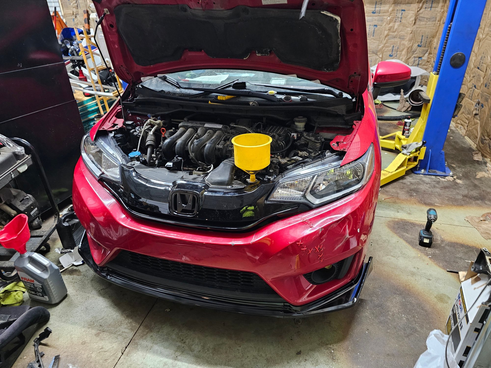

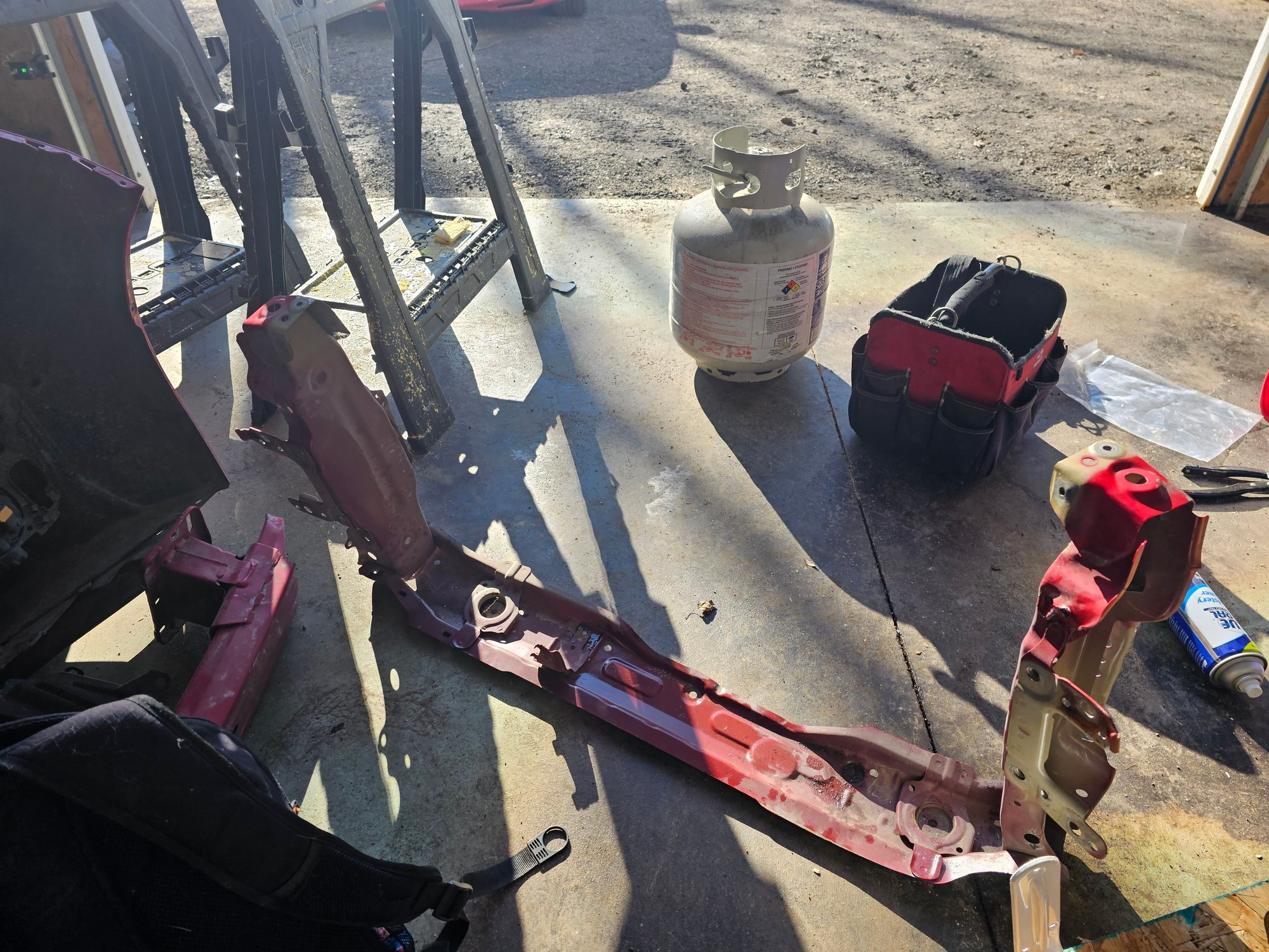

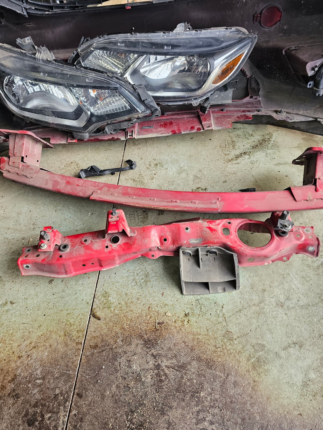

Next was the front end, I disassembled everything up front and assessed what it needed. Core support, headlights, grill, and hood were the obvious ones. I was able to save the condenser and radiator luckily. I ordered a whole new core support, headlights, and a nicer looking grill.

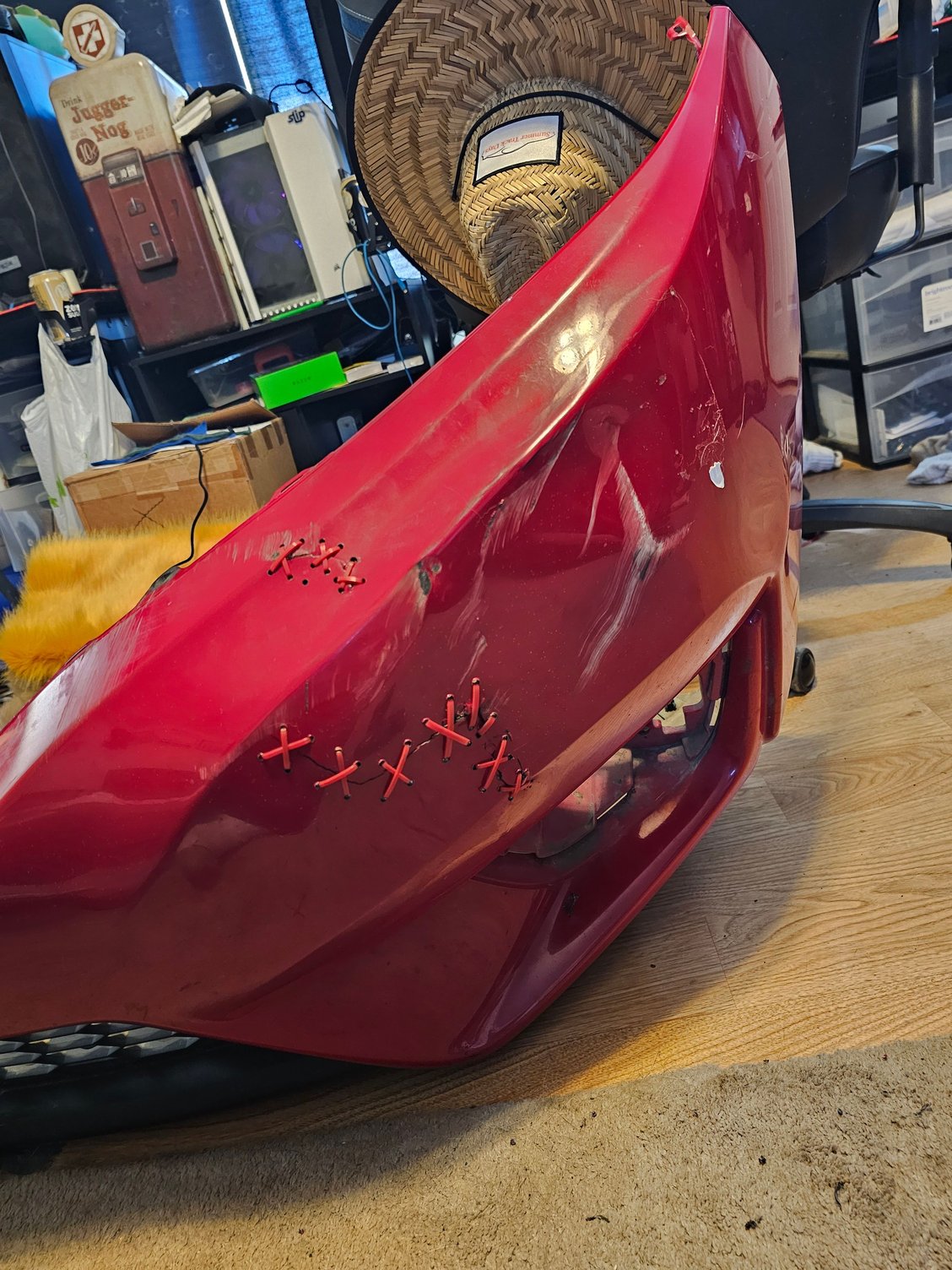

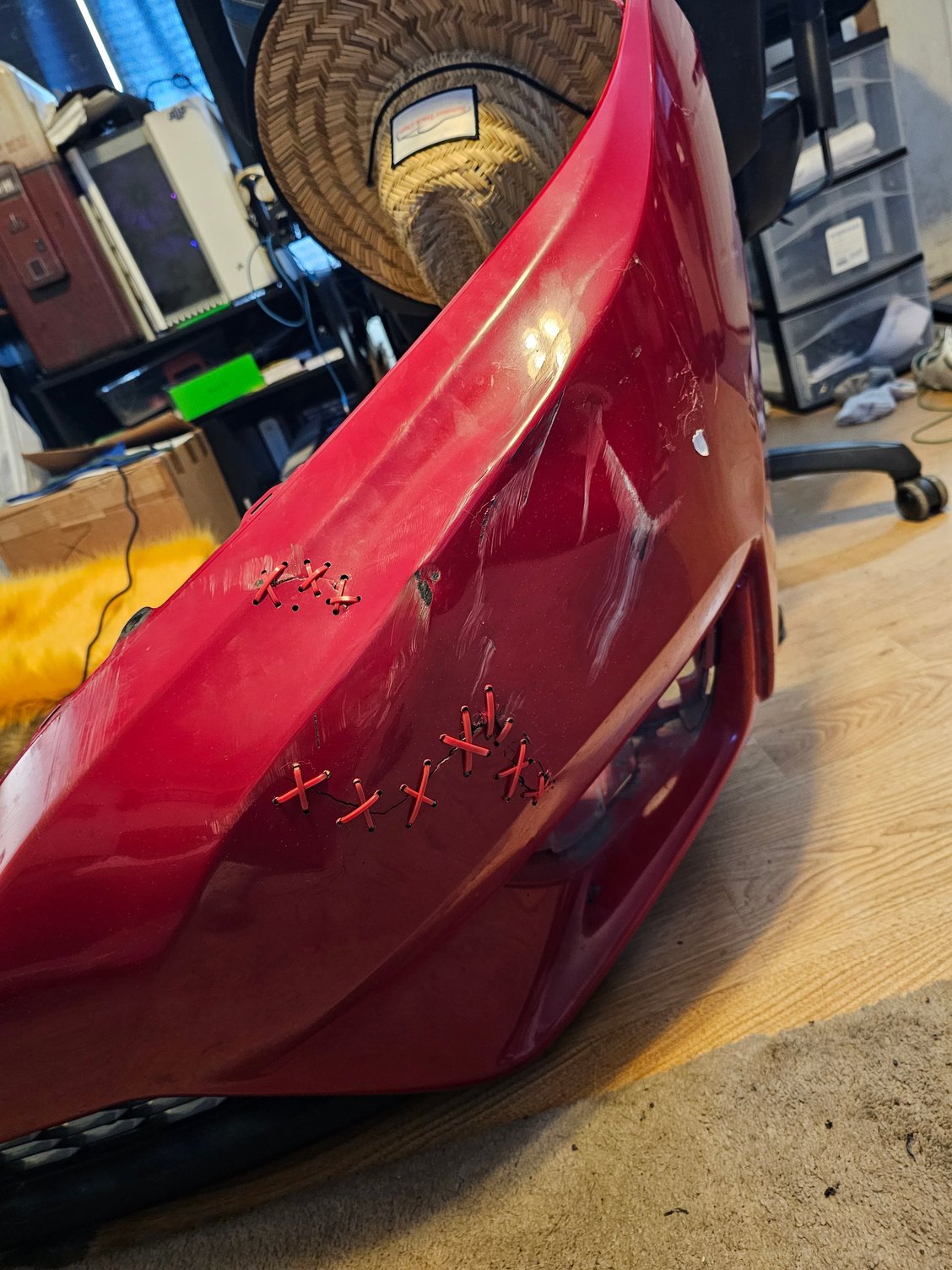

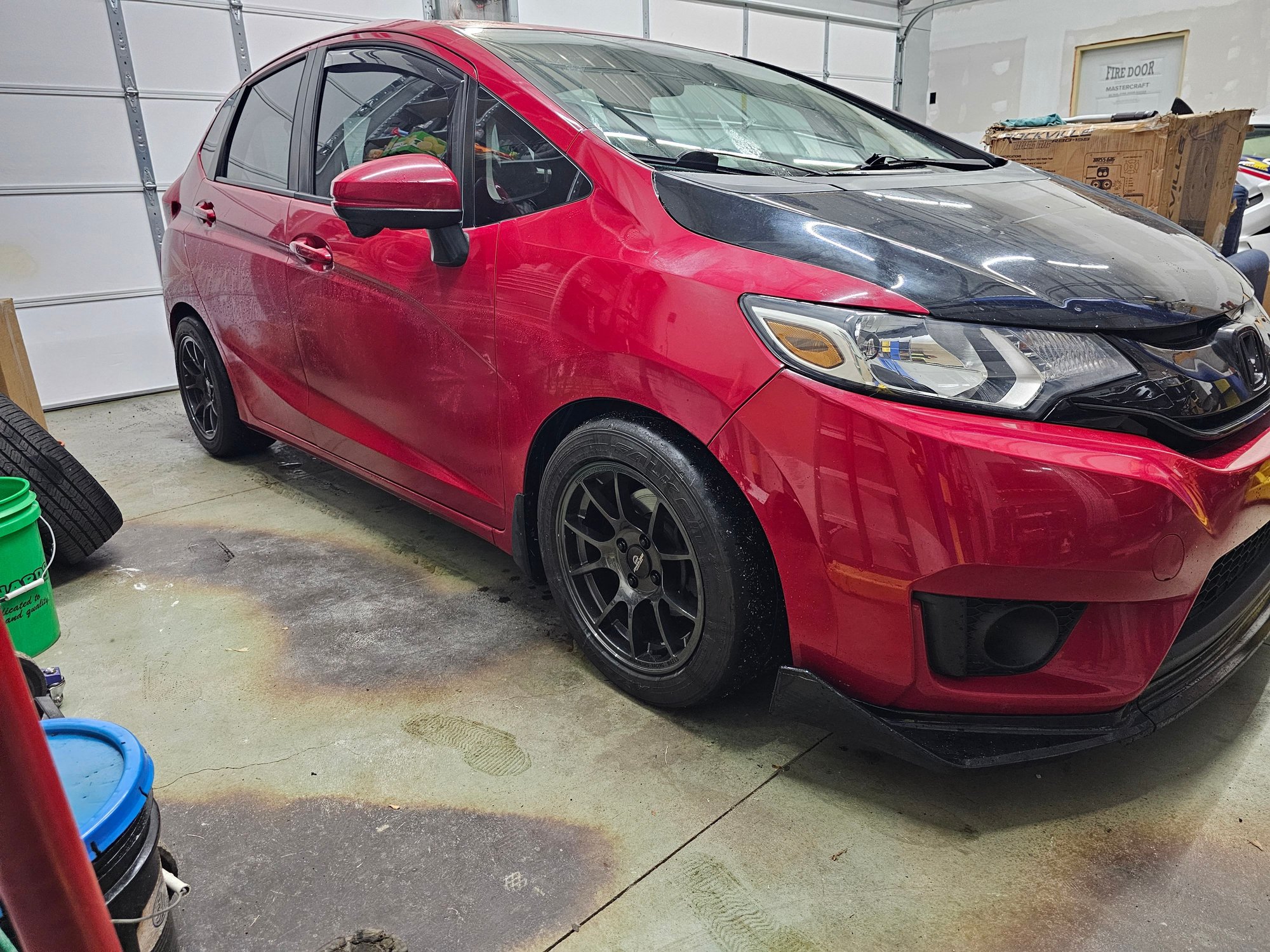

The bumper cover was cracked, and finding a painted replacement was becoming an issue so I decided to do something called drift stitch. It's a where you drill holes on either side of the crack and zip tie in an cross pattern along the crack. This came out way better than I thought it would. At the same time I installed a set of aftermarket fog lights, the nicer looking grill, and an ebay lip. I put it all back together on the car with the new headlights, changed the serp belt, air filter (thing is tiny) and added fluids. It turned right over and went for a drive that night. I love this car already. I was able to find a used black hood which I think compliments the other black accents on the car!

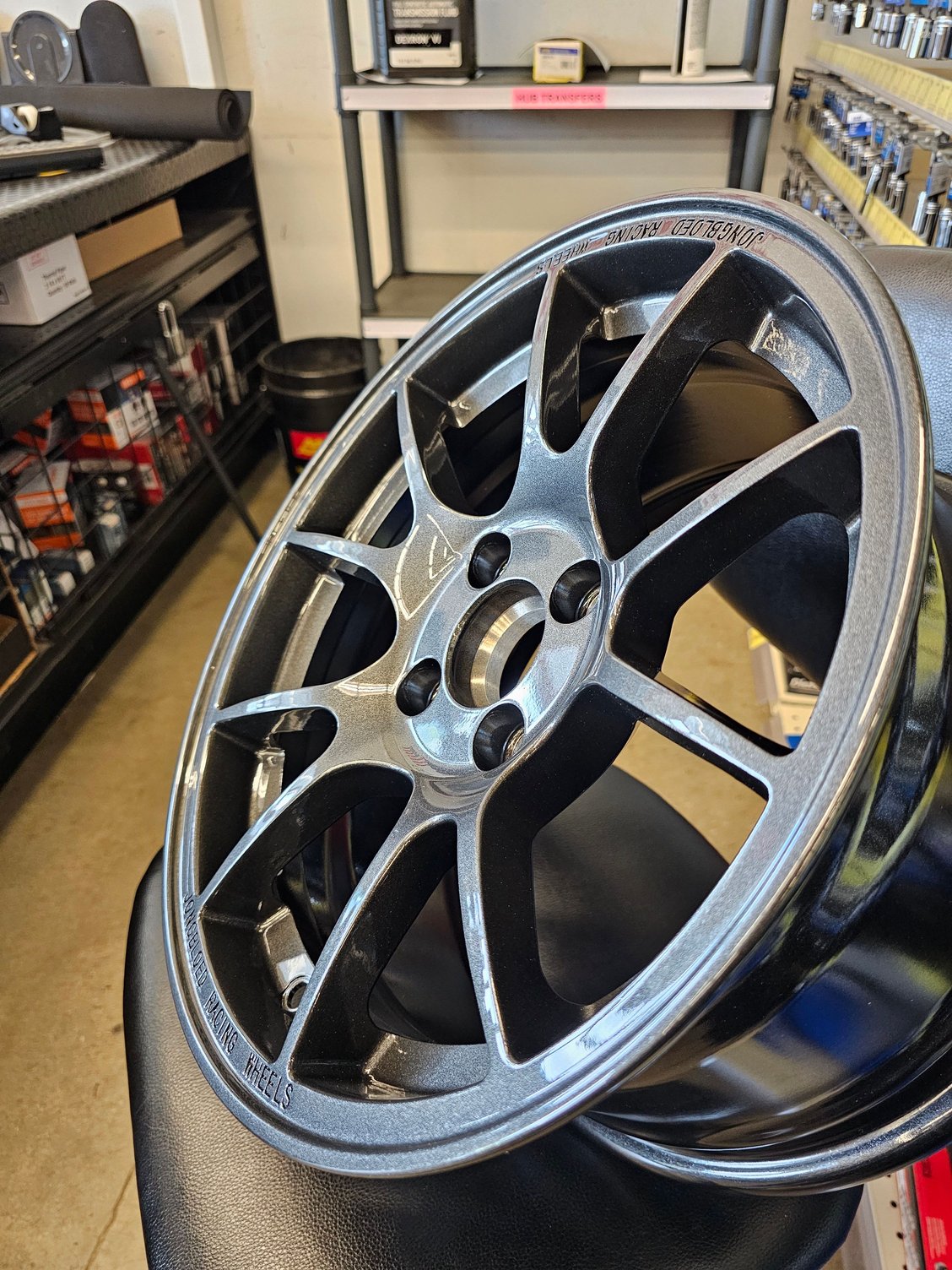

Lastly, I got some new wheels for it recently but need to lower the ride height a little so it doesn't look like a monster truck. 15x8 Jongbloed Racing Series 500 wheels.

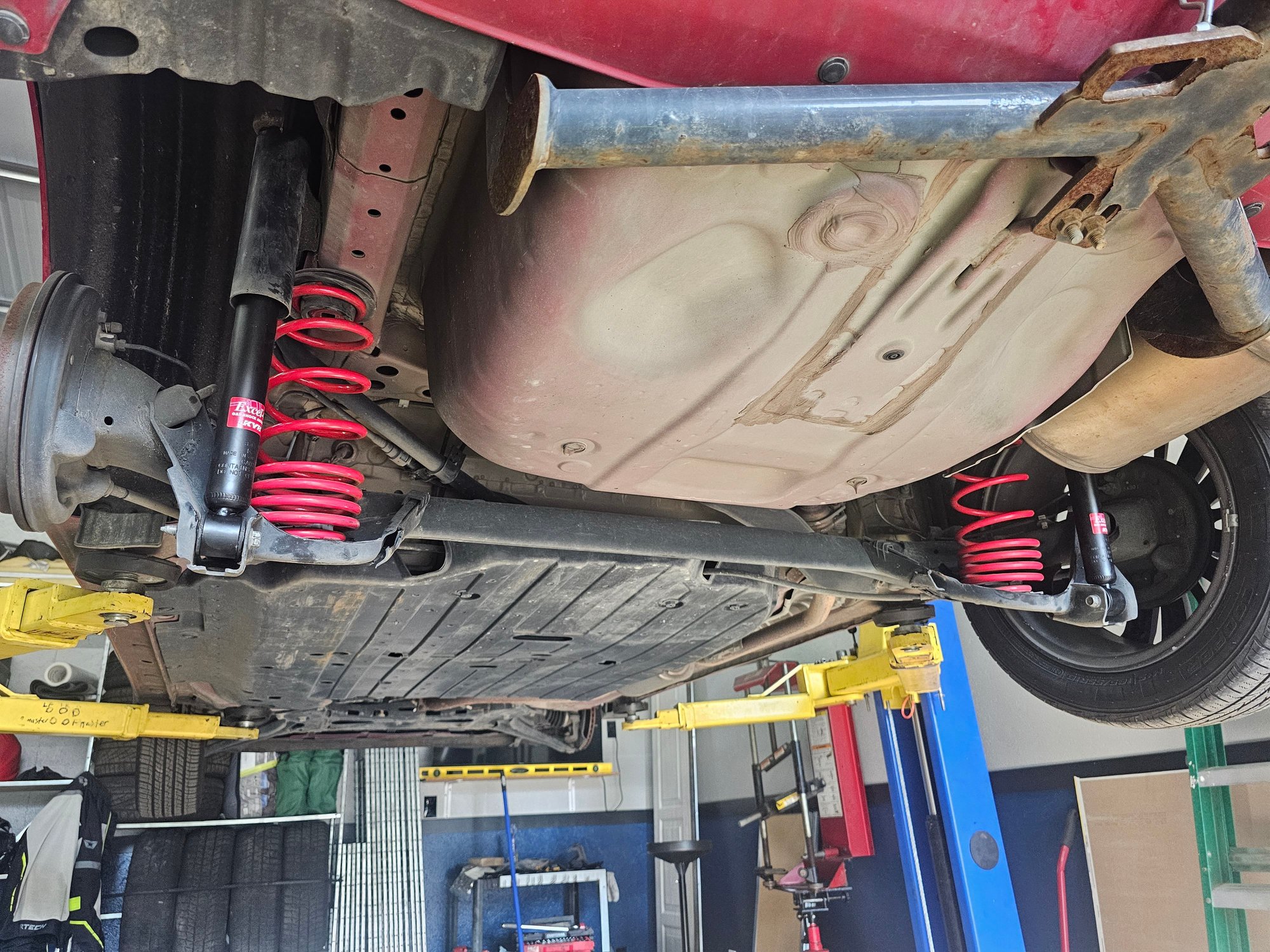

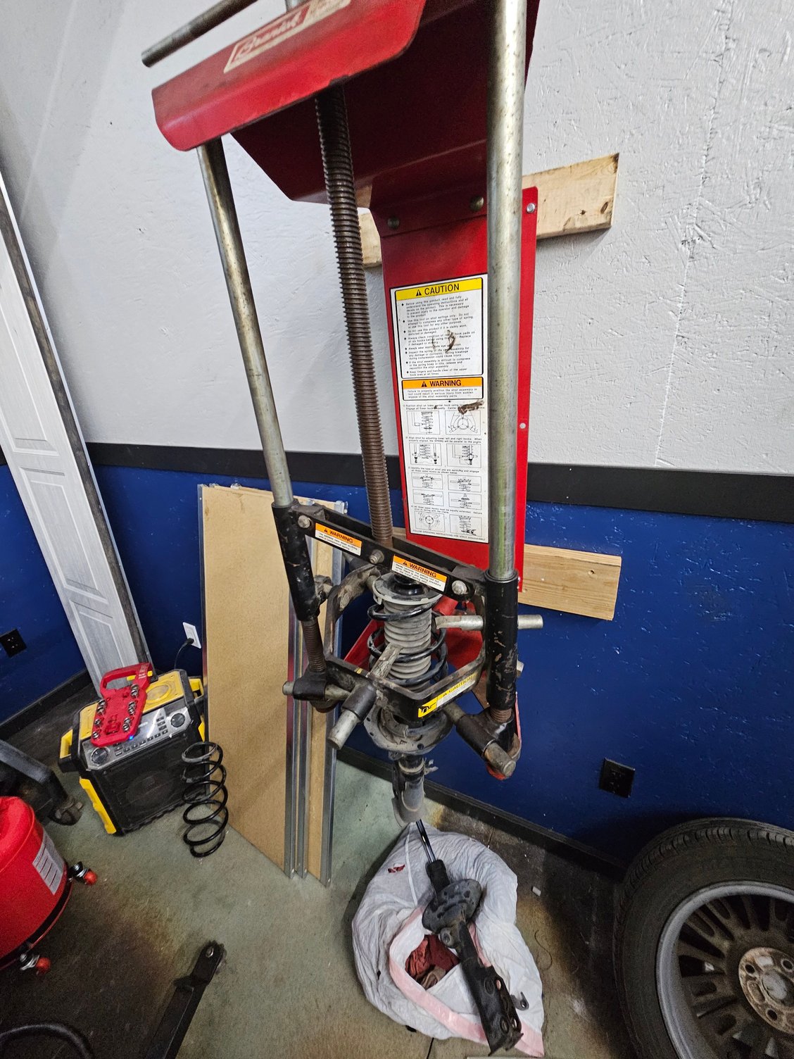

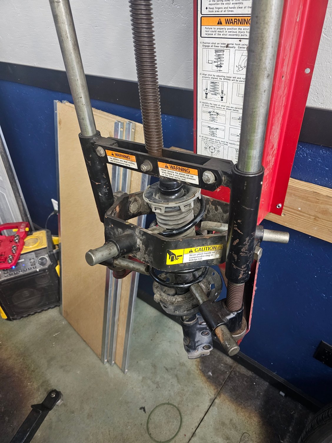

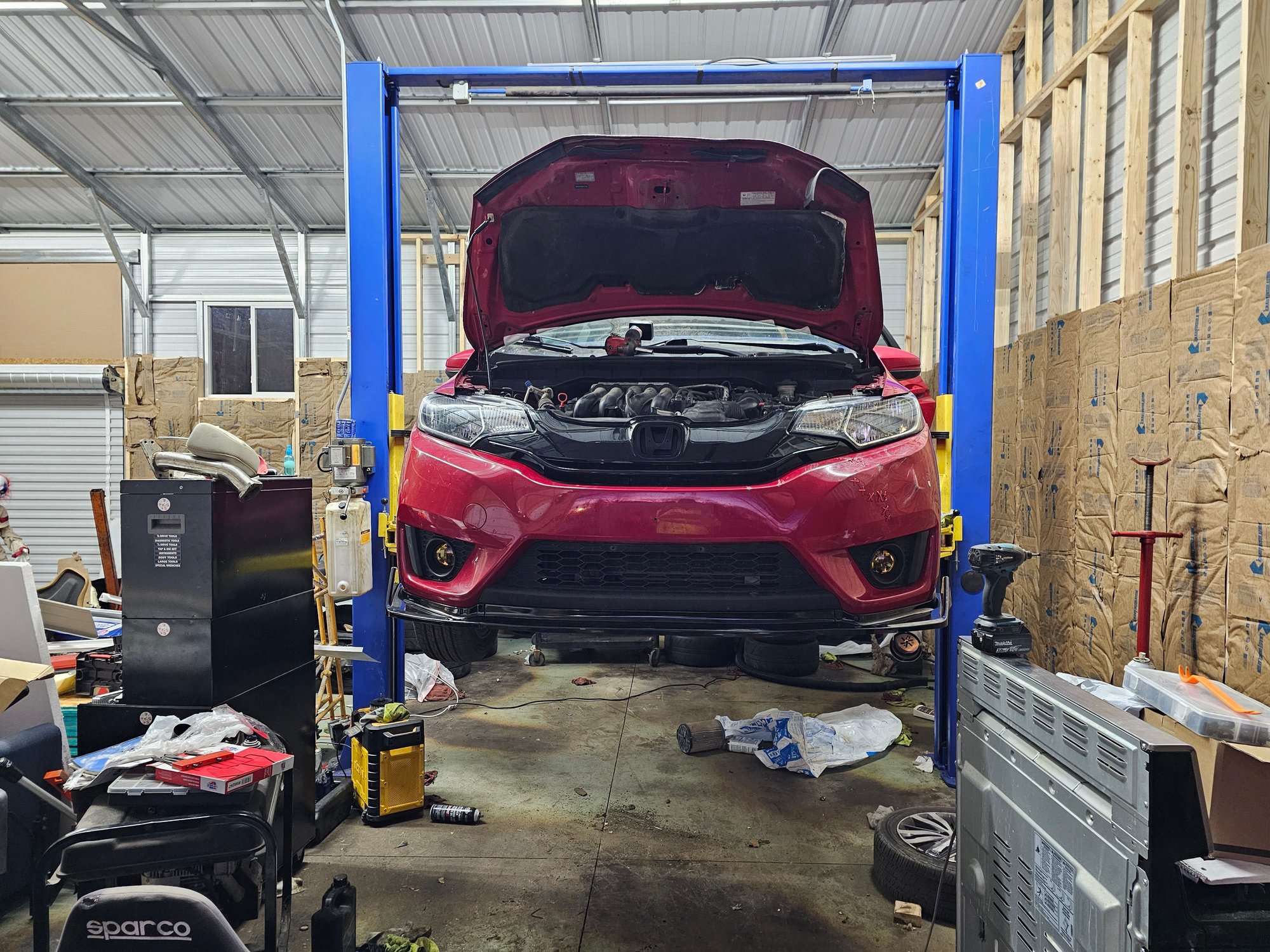

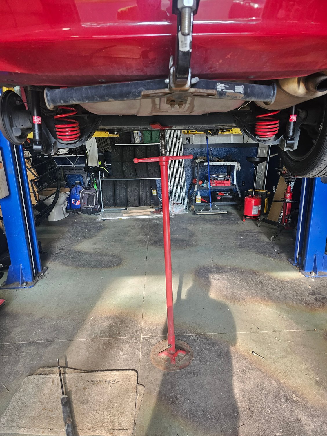

Alright, got everything in today to install my new struts/ shocks with my swift lowering springs.
Tossed the fit on my lift after work today and started disassembling the suspension. I started with the rear shocks, which were super easy and took no time at all. Unbolted the bottom bolt of the shocks on both sides, once I did the springs just fell out. Swapped all the rubber pieces over to the swift springs and reinstalled.

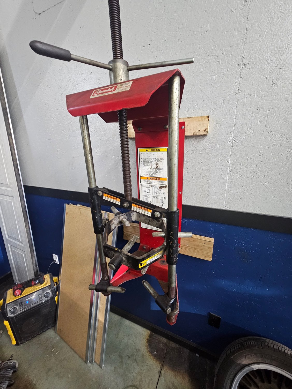

Next was the fronts, to save my alignment as much as possible I marked all the bolts so I could line em up exactly how they were. I forgot to bolt my strut machine onto the wall before today so I had to do that before moving forward. The driver side strut came apart smoothly and swapped over everything to the new struts. However the passenger side strut gave me a bit a trouble getting it apart. The nut was seized and was actually bending my allen key, so I had to come up with a different solution. I couldn't find my long vice grips, so what I ended up do was taking a pipe wrench to the struts shaft and taking my milwaukee impact to the nut. It took a couple adjustments of the pipe wrench to keep the shaft from spinning but eventually got it. Reinstalled everything, and torqued everything to spec.

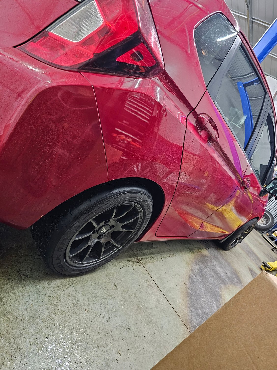

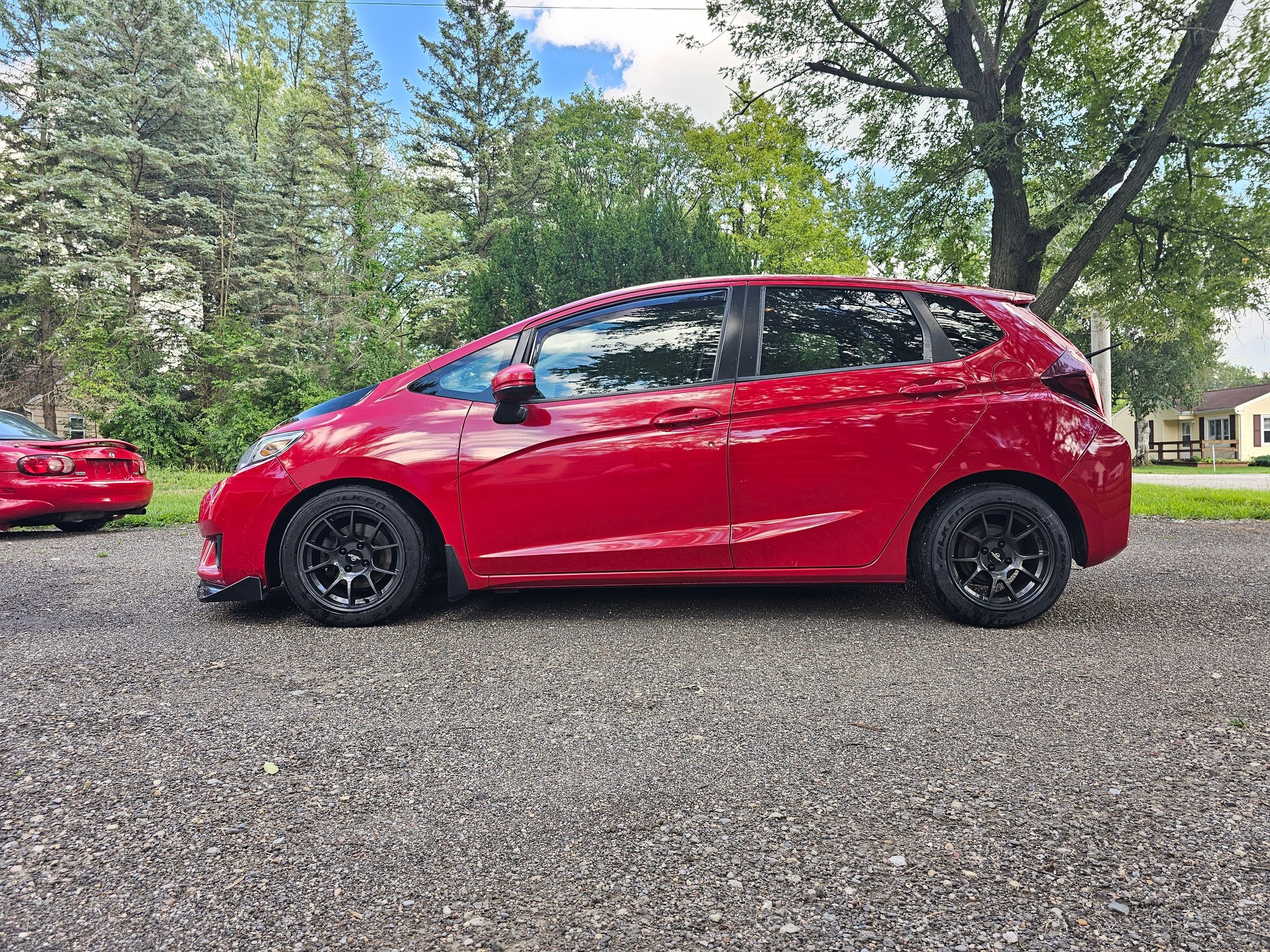

I bolted the new wheels back on and took it for a spin, and I absolutely love the way it handles now. it got dark before I could take some outside pictures so I'll upload some at a later date. For now have some garage pics!
I will be doing double camber bolts in the front struts and camber/toe shims in the rear to dial in my alignment and get rid of the wheel poke.
Can't wait to continue adding to this car and making it better!

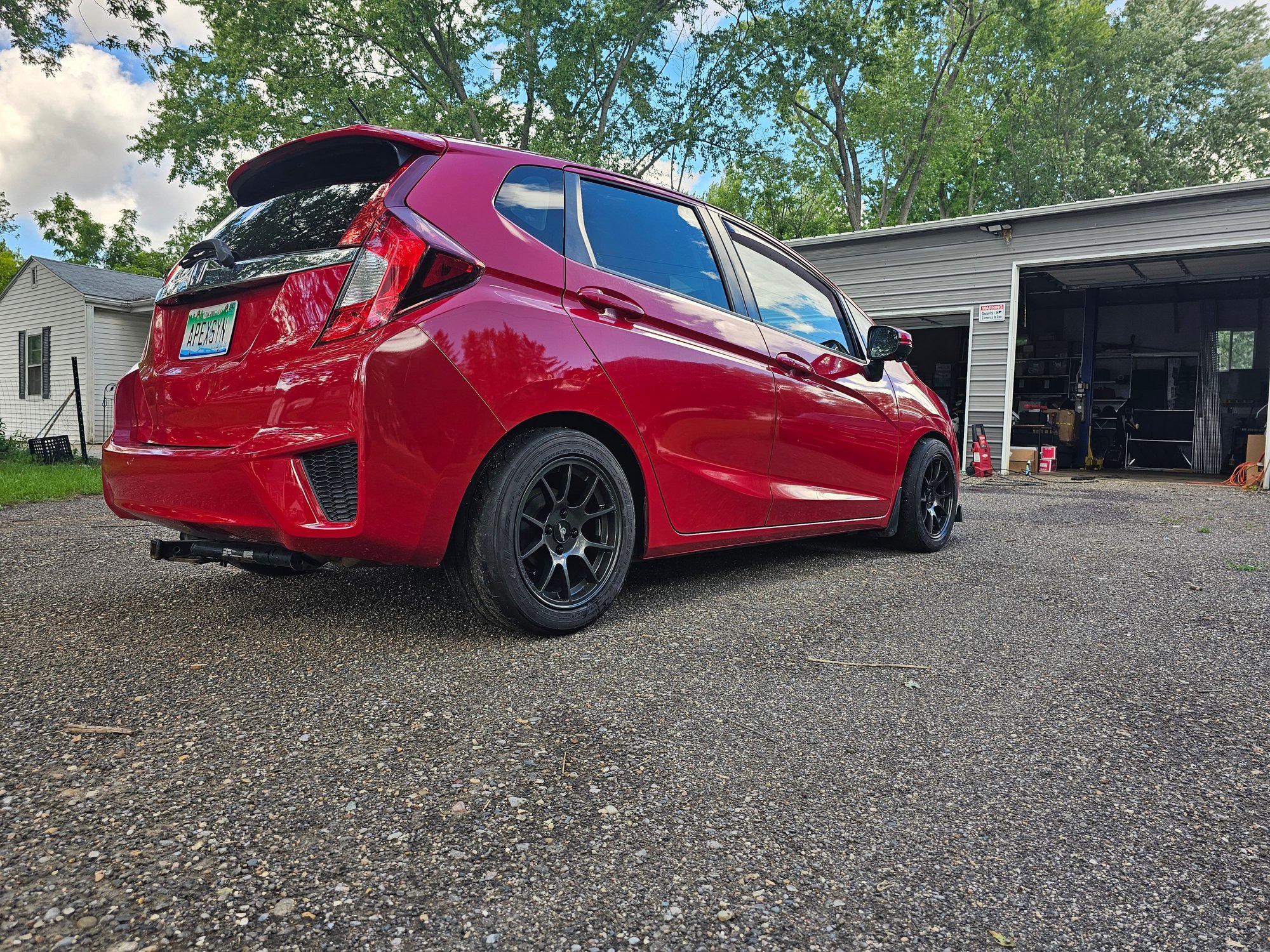

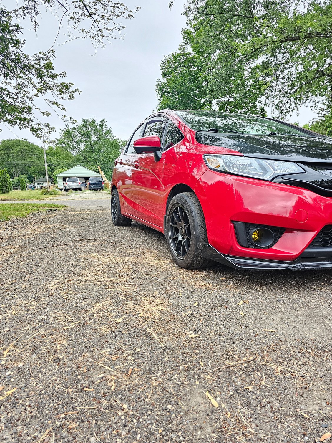

Cleaned up and some better pics
