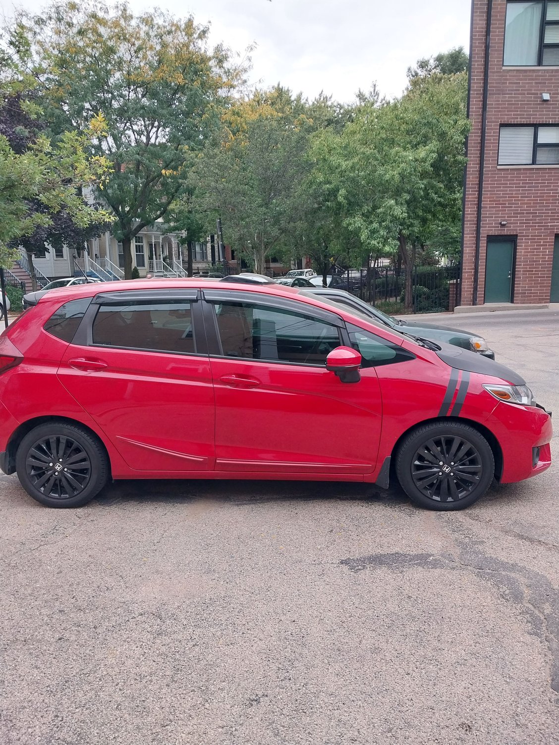

Chitown Fit's Avatar
Joined: Jan 2015
Posts: 1,034
From: Chicago
My 2015 EX with Black Sport Wheels.
