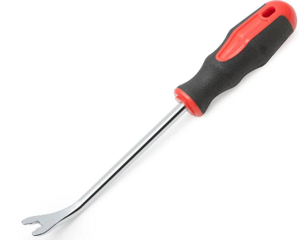

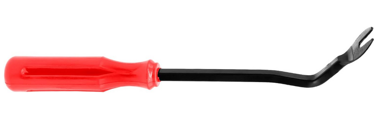

Most clips can be removed intact with the proper technique. The clips on my 2010 Fit come out easily with a trim removal tool. I have one with pointy tips and one with flat tips. For the common clips that have an inner rod, you use a single tip (or small flat head screwdriver) to pop the inner rod out a bit and then the trim removal tool to pull the clip. Reverse the process to re-insert the clips. Easy peasy.
