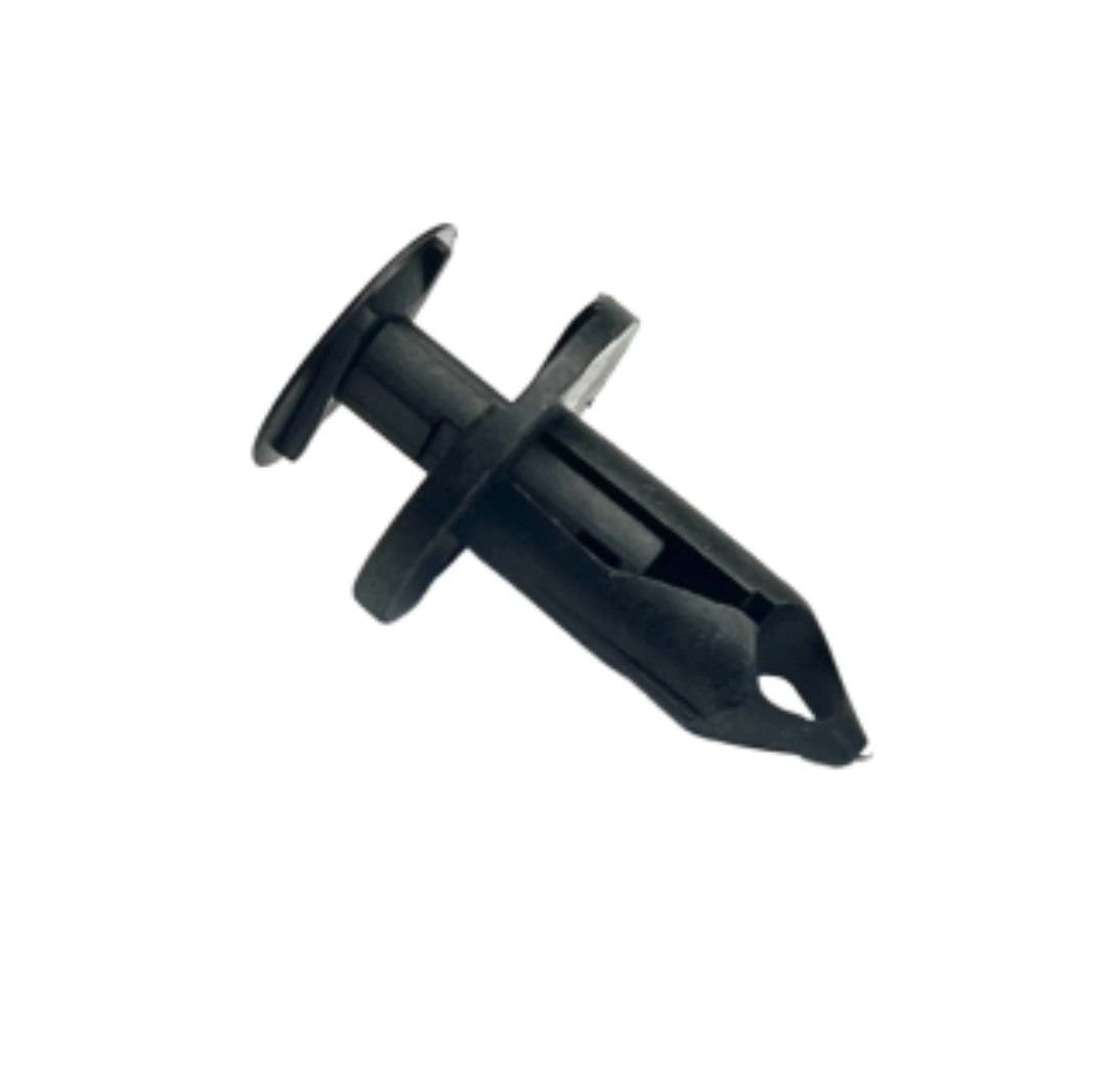

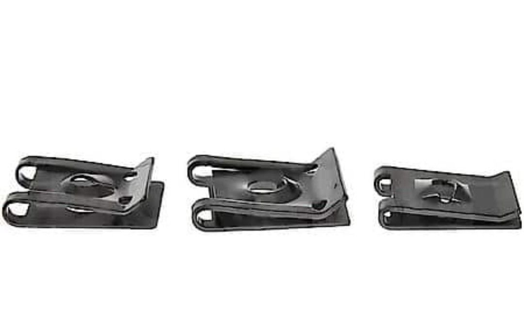

Think that part is three pieces. Those side panels stay attached to the car. Only the big center needs to be removed.
A combination of sheet metal screws, (6) screw into those U clips that attach to the side panels. There two small plastic expand plugs that hold the rear of the shield to the rear frame cross frame.
The side panels attach with larger plastic expanding push pins.
Save yourself some time and headache by getting the correct fastners from the Honda dealer.
The screw have a gray anti rust coat and are bigger then most hardware stuff. Even the push pins are odd side.
Few years ago, I purchased a huge bag of different size plastic push pins on ebay.
There from the size of a pencil to your thumb. Grey, blue, black.. Some with fins, Some two part expanding you pop center plug back to release it, some with a screw to expand and rekease.
Nothing fit the Honda. Have a coffee can of sheet metal screws and nothing fit.
There is a reason for that madness. One of those odd ball push pin plastic fastners at the Subura dealer was $5.00.
Why i purchased 200 on ebay for $20. However nothings fits for my $20...
Note below attachment just for reference. Don't remember what the push pin looked like. Could be 10mm. Not sure. Maybe a 91514-TG1-T01
