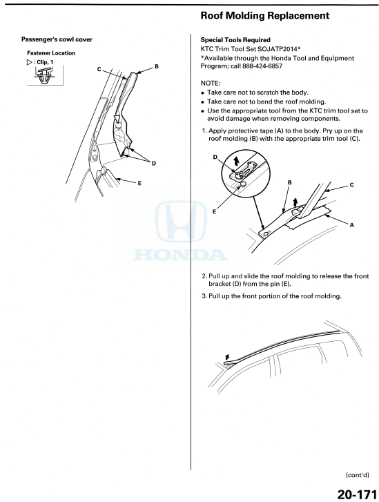

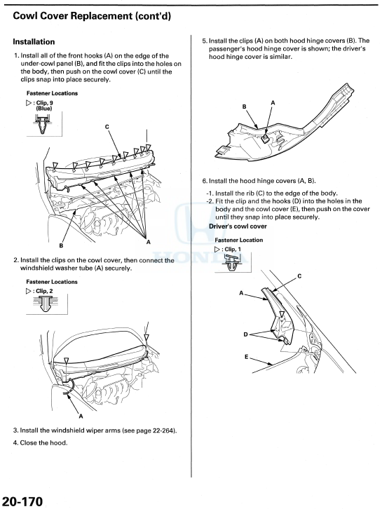

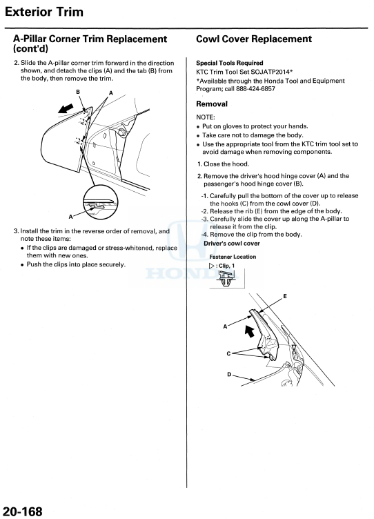

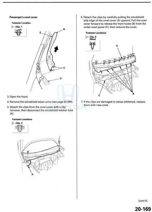

What year Fit do you have? I suspect cowl removal is similar across years, but I've only done it on my 2010.
The cowl is held on by a bunch of plastic clips. Many/most will break when you remove the cowl, so you want to have replacements ready.
Here are the instructions from the 2010 service manual.
