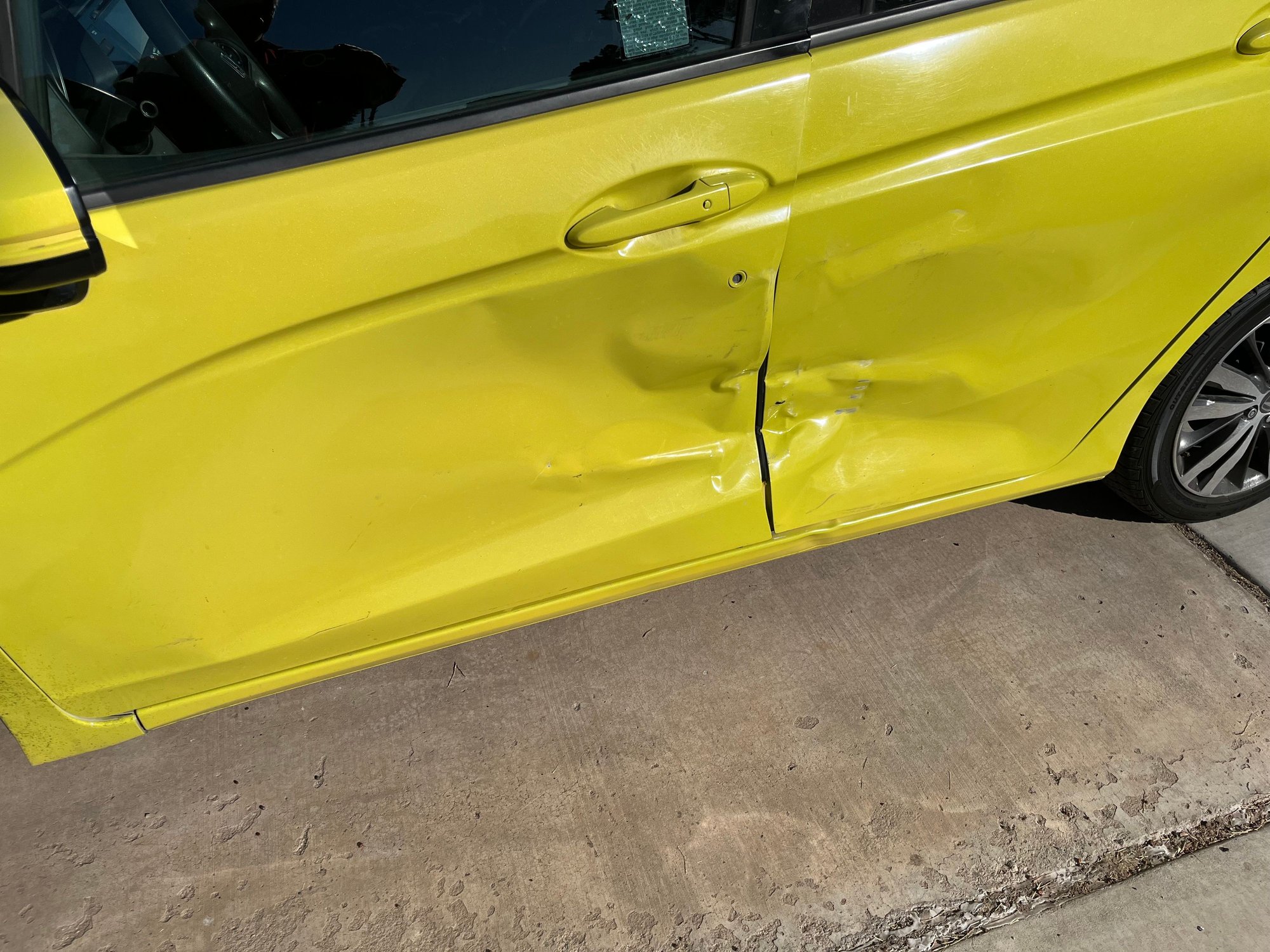

A couple months ago, while parked another car collided with my car damaging both driver side doors. Since then it’s been repaired except the gas gauge reads completely full or completely empty regardless of how much is in the tank and the low fuel light blinks frequently. Can you point me to a solution?
A couple months ago while my car was parked, another car ran into it and damaged both doors since that time the car has been repaired except the gas gauge either reads totally full or totally empty regardless of how much gas is actually in the tank and the low fuel light occasionally blinks even on a full tank. Can someone point me to a possible fix?

Very possible some of the wiring was damaged during repair or the incident. Check under the vehicle left side as well as under floor sill plastics and pillars/similar and look for obvious damage. Once you tear that out and find what you need, run continuity tests on all relative wires. If no issue is found, check fuel sender for functionality. Cheers.

The fuel tank is below the driver and front passenger seats, very close to the impact area. The tank may have been distorted by the impact, or the fuel level sender could have broken free from the pump assembly. Access to the pump/sender/EVAP assembly is under the center console between the gear shift and parking brake lever.
