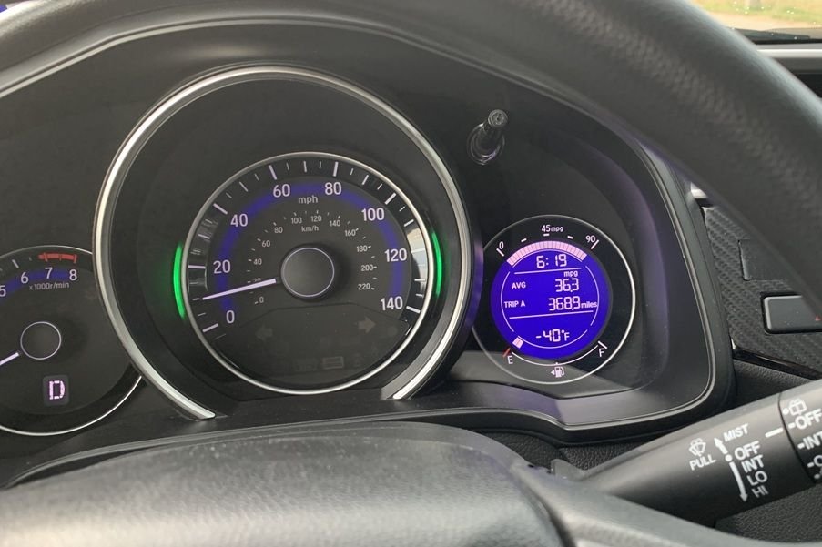

Mine went to heaven about 2 years ago, and seeing that to replace the sensor requires removing a lot of front end parts, so I decided to pass, unless someone knows a way of cutting into some cosmetic parts to get to the sensor, which I don't know exactly where it is located. The funny is that when the sky decided to drop heavy rain, the sensor sends a default reading to the gauge of -40 deg F.. This has happened a couple of times now.
