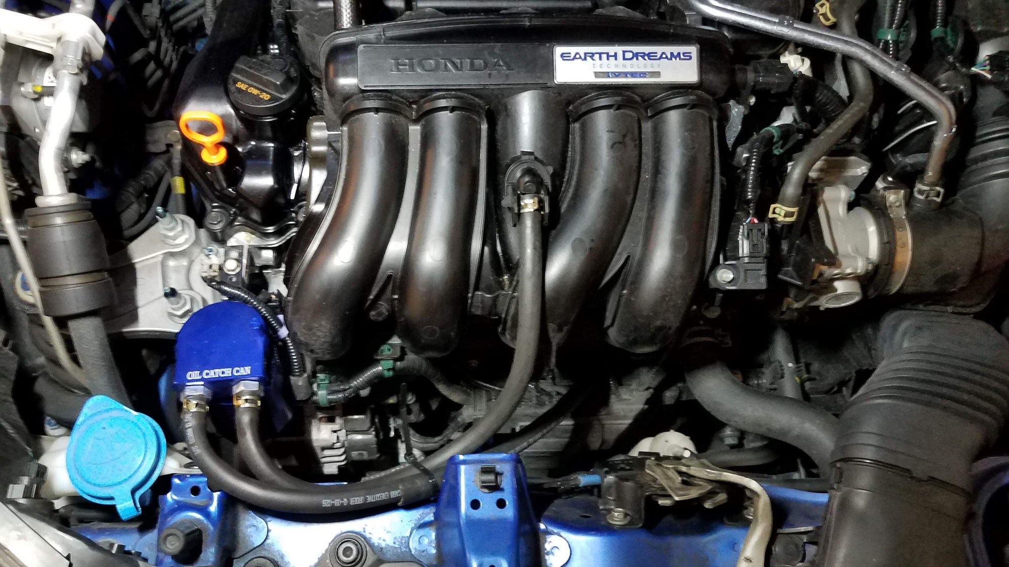

You are not really removing any SMOG device, the PCV valve stays in-place and is not vented.
Old Jul 22, 2025 | 01:15 PM
Mister Coffee's Avatar
Joined: Apr 2014
Posts: 1,636
@t-rd Great picture. Who makes that oil catch can? I'd like to do further research. Thanks.

It's the same as
this Amazon Evil Energy one for ~$25. this Amazon Evil Energy one for ~$25.
I've had one on my 2018 Sport 6MT for the last year. I dump it about once every 6 weeks and it's got 1-2oz of watery oily garbage in there.
Old Jul 22, 2025 | 05:23 PM
t-rd's Avatar
Joined: Sep 2018
Posts: 155
From: Aurora, IL
^ That's the one yes. Put 2 balls of stainless steel wool in there. This slows down carbon deposit on top of the valves, but you still need to clean the valves in the future, just not as bad. I just finished cleaning the valves last weekend, at 130k miles.

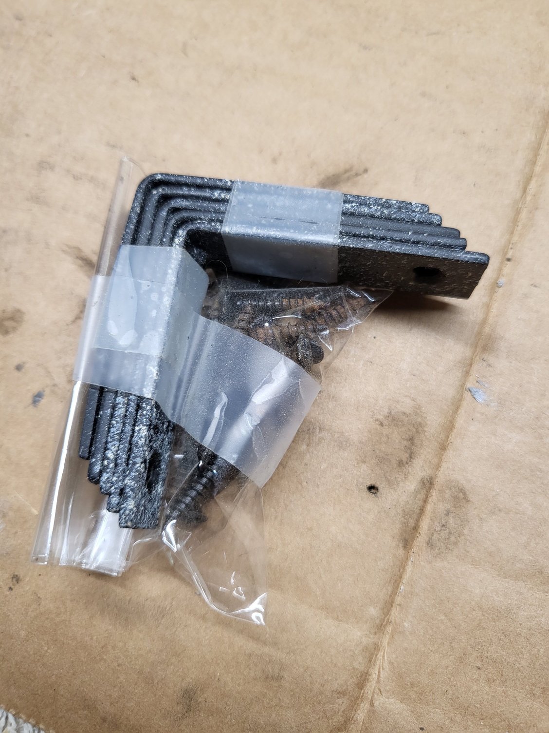

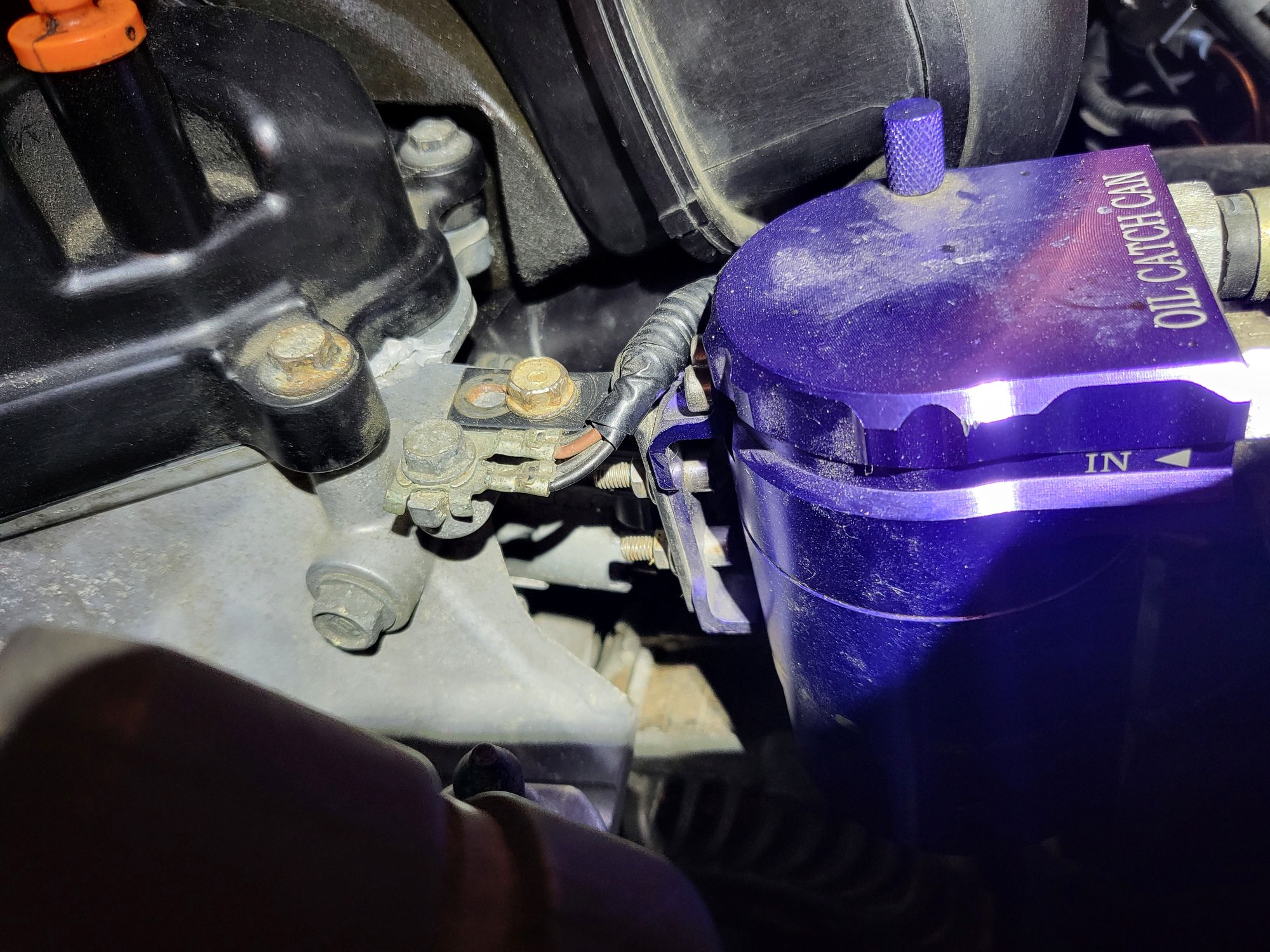

@t-rd @newengland72 how do you have the catch can mounted, and are you using the bracket that came with the kit, or did you make your own?
Old Jul 29, 2025 | 02:17 PM
newengland72's Avatar
Joined: Mar 2016
Posts: 46
From: Worcester, MA
Yes, with the included bracket and some (I think) M8 metric bolts. I zip tie-d the hoses together and also down away from the hood as they were rubbing.
Old Jul 30, 2025 | 08:16 AM
t-rd's Avatar
Joined: Sep 2018
Posts: 155
From: Aurora, IL
L bracket from home depot
