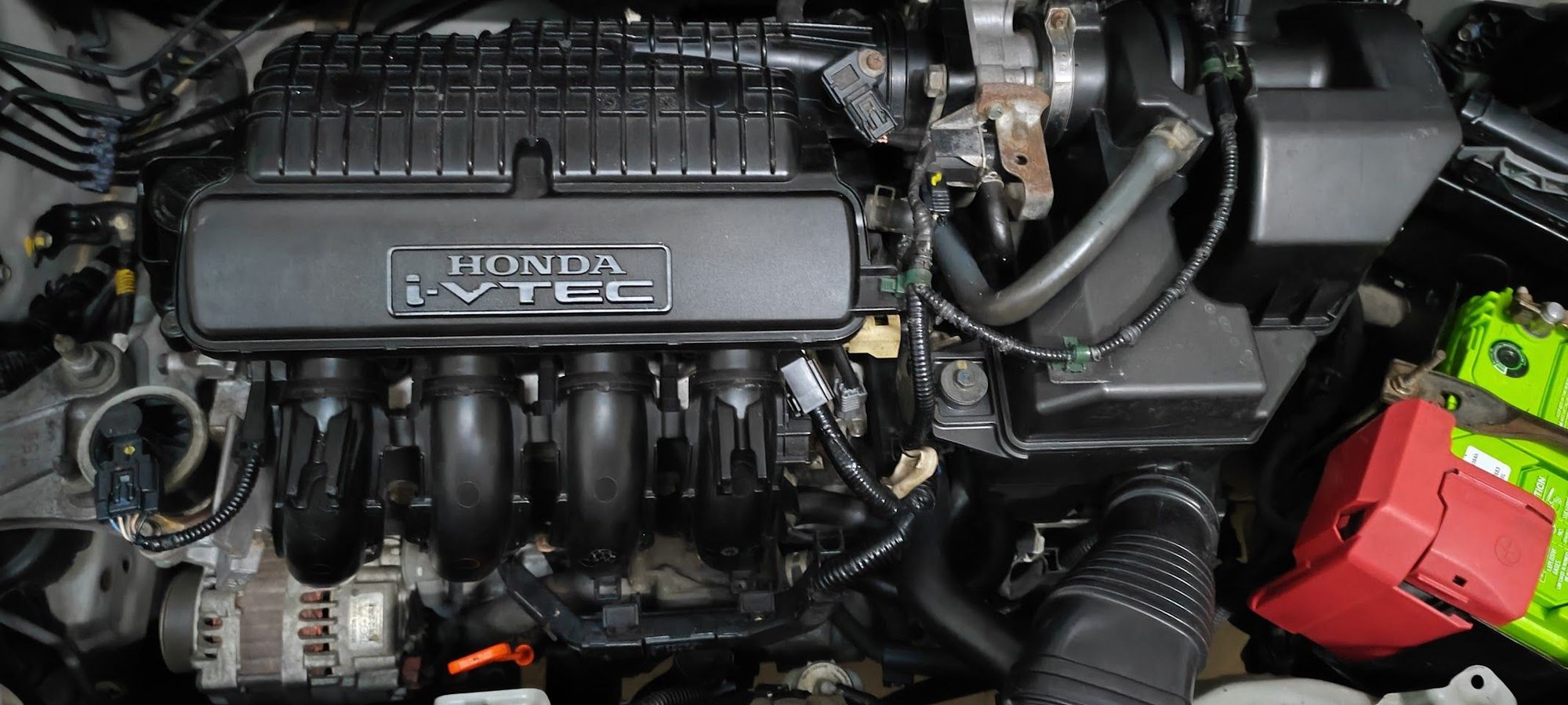

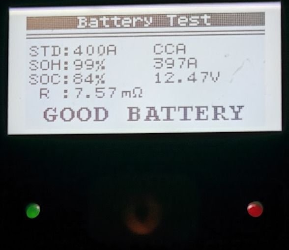

I just bought a 2015 Honda Fit GK5. Currently, when starting the engine, sometimes it starts right away, but other times there’s only a clicking sound from the solenoid—no rotation from the starter motor’s pinion. The battery has already been replaced with a new one, and the starter relay has been checked and is working properly. Could the issue be with the starter motor itself? Any suggestion ? Thank you .

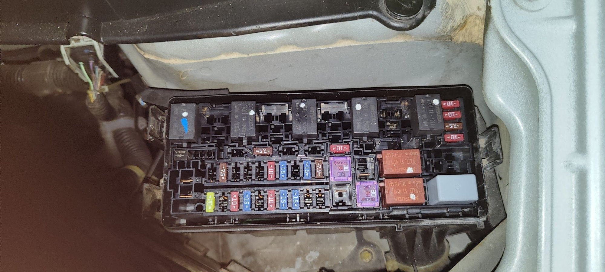

I do not use a push-button start/stop engine. I still use a manual key. The + cable from the battery to the starter dynamo and - cable has been cleaned. The starter relay has been checked, and it is functioning properly.I'm going to disassemble the starter motor—it seems the problem is inside the starter itself.

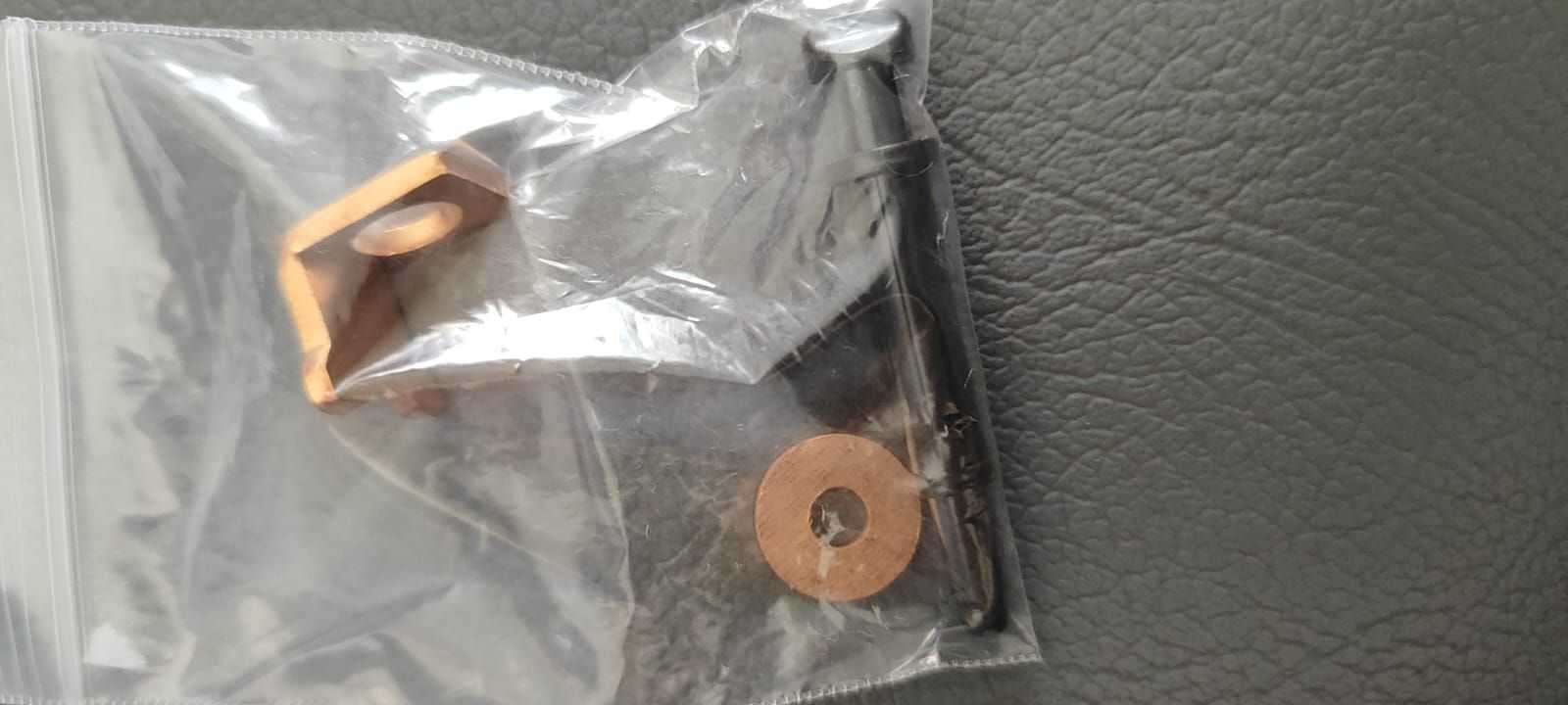

Finally, I found the root cause, and everything is okay now. I opened the starter engine, replaced this part, and now it's working properly.
Thank you everyone, for your help and information.
This is the root cause

Thanks for the pics.
That looks like the high-current solenoid/switch contacts for the starter motor. There's usually two part-circles (the extra-crispy part) on opposite sides of the solenoid shaft - one connected to the battery, one connected to the starter motor. The disk (attached to the shaft) pushes down on them to connect the circuit.
Do you have a pic of the parts in place? It could help others considering the repair. Where did you get the replacement parts?
