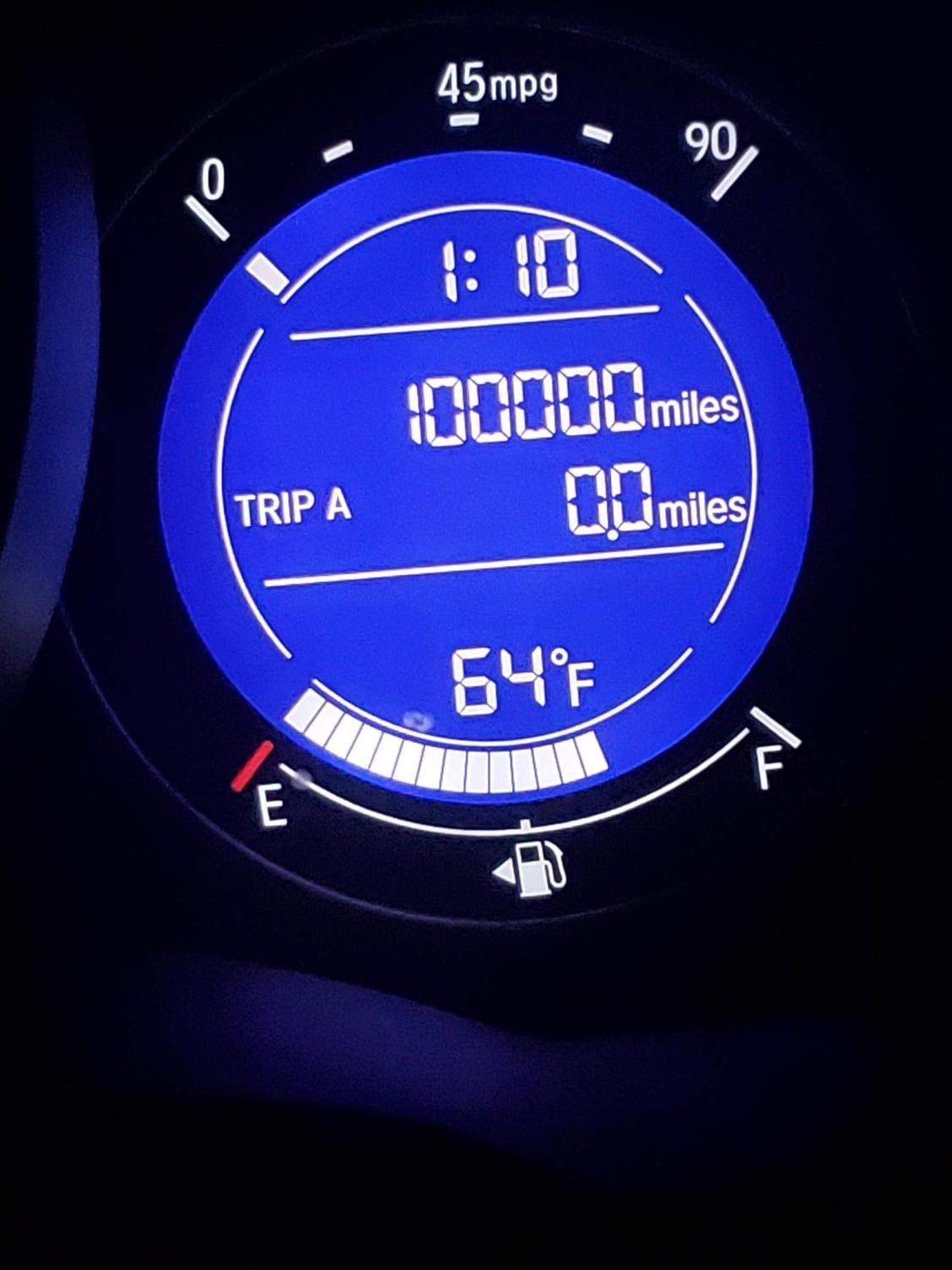

My 2015 EX-L FIT just hit 100K miles!
I have meticulously maintained it since new with all the recommended service plus:
It had the VTC Actuator and Chain Guide in the engine replaced at 74,000 miles under the HondaCare Warranty by the dealer and unfortunately even with a Transmission fluid change at 40K and 70K the CVT Auto Transmission completely failed at 92,000 miles. It was inspected and diagnosed by the 2nd Extended Warranty Company as a non repairable internal failure with metal shavings in the fluid and with that they paid the Honda Dealer $6200.00 for a new transmission. A few months prior to that the Starter failed and they paid the dealer to replace that.
I did a Radiator Flush at 50,000 miles and the Serpentine Belt was replaced at 74,000 miles while they were working on the engine.
1. What service should I do now at 100,000 miles?
2. What service did you do yourself? or paid a mechanic do when your FIT hit 100K?
Thanks!
