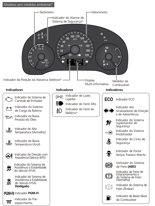

Yes, HDS is Honda's software used to access all vehicle functions.
However, not all scanners are compatible with it. The ones that are usually aren't sold in Brazil and become impractical due to import taxes.
My gauge cluster isn't the one shown — that's from the EX and EXL versions here in Brazil.
The LX version uses the one shown in the photo below (without cruise control lights):
As you saw, the gauge cluster is responsible for converting the cruize control signals, and it probably isn't doing that. So my problem can be the gauge cluster. Because the ECU, clock spring and steering wheel are the same that exl version (factory-equipped cruise control).
They are expensive in the US as well, as I understand it. I doubt it was due to taxes. Find a used unit maybe?
Interesting. We never got that style cluster. The style I posted seems to be standard for all US GKs, unless it has the Honda Sensing package. Then the right panel is a pixel-array color LCD which shows adaptive cruise status among other things, the left panel is a segmented LCD as far as I can tell:
THAT style is sure to give you trouble.
Ah, you checked the part numbers? Good, that narrows down the possible trouble spots greatly. That leaves the gauge cluster and firmware.
