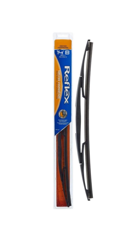

I’m on my second wiper that doesn’t fit. They all seem to come with all the universal mounting hardware but nothing resembles the one i removed. Is there a certain one i should be looking at. Or can you get just the refill for these.

Ended up getting this one, fit perfect. Dealer had inserts for $17 Canadian but they only fit the OEM blade, mine was replaced before so won’t fit.
