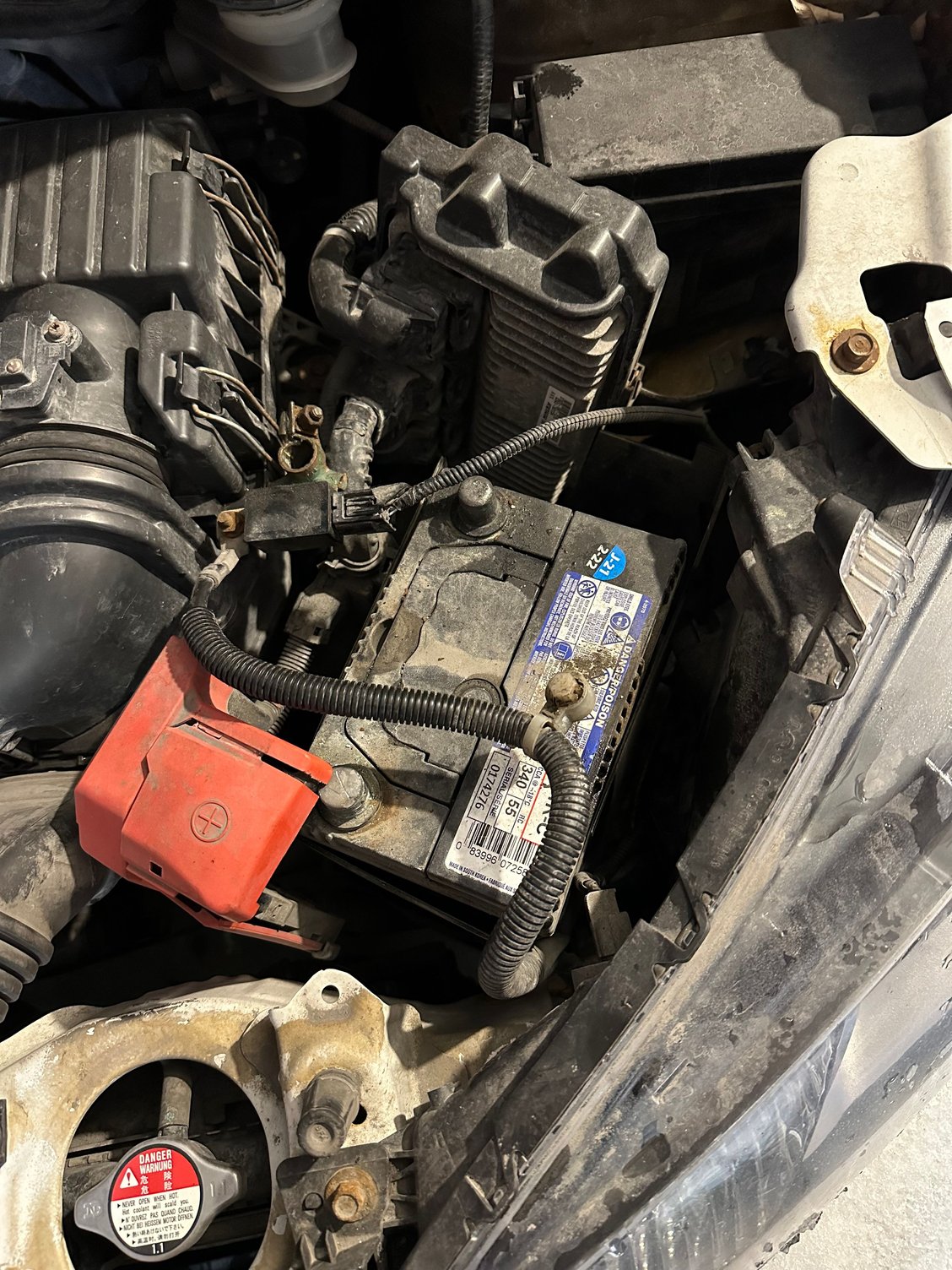

It looks like a tight fit
The negative battery terminal is close to the cooling fins on the ECM, but the terminal can be twisted to stay clear. I would be surprised if the cooling fins aren't already grounded (electrically connected to battery negative).
I checked and the picture makes the negative terminal appear closer to the cooling fins than it is. In fact, it is a good 1/2 inch or more away from the ECU heat sink.
