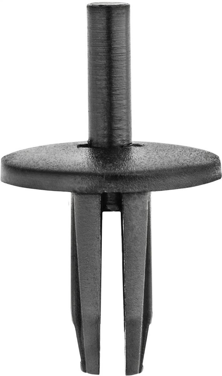

Here's a couple of examples of what I was expecting:
