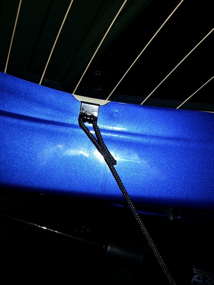

I bought an OEM 2015 Honda Fit Cargo Cover. However, I can not figure out exactly where to put the 2 clips. Can someone please take a picture and show with some arrows as to where it goes on the tailgate frame? I am including the instructions I found at Bernardi's Auto Parts. It's still too general for me.

I don't have one of the covers. However, from the diagram, it looks like they go on the hatchback door inside the trim mold next to the glass. The (rope) on each side of the cover will attach to the clips so that the cover will lift up when you open the hatchback door.

I have pictures. Hold please while I upload them.
Edit - on your hatch, note the notch/indent that is on each side. The clips go there. To help them go on, use WD40, a towel, and a broad blade (like a putty knife), to push the clip onto the notch. Hope this helps!

Just run your fingers along the inside edge of the hatchback glass, and on each side you will find an indentation. That is where the clips slide in. Keep in mind, it will take a little pressure, as they don't go on easily. We wrapped the screw driver tip with a small rag, to avoid scratching the paint, and pushed until the clip snapped in (or on). I would say it was pretty fast getting the cover installed. Don't overthink it.
UPDATE: In the time it took me to type the above, xStitchX posted his picture showing the indentation. A picture is worth a thousand words....

Thank you xStitchx and Vanguard!
Thanks so much! This picture really helped. I also used the tip for WD40 and the tip for a covered screw driver from Vanguard. I will see if I can post some pics. Thanks again!

Here's are some close ups of the clip placement for the cargo cover:

Boy, that is a close up........love the blue color!
Thanks Vanguard. I think my camera phone distorted the real closeup, so you see the "specks" for the metallic Aegean Blue. LOL!
