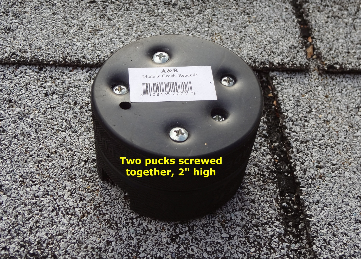

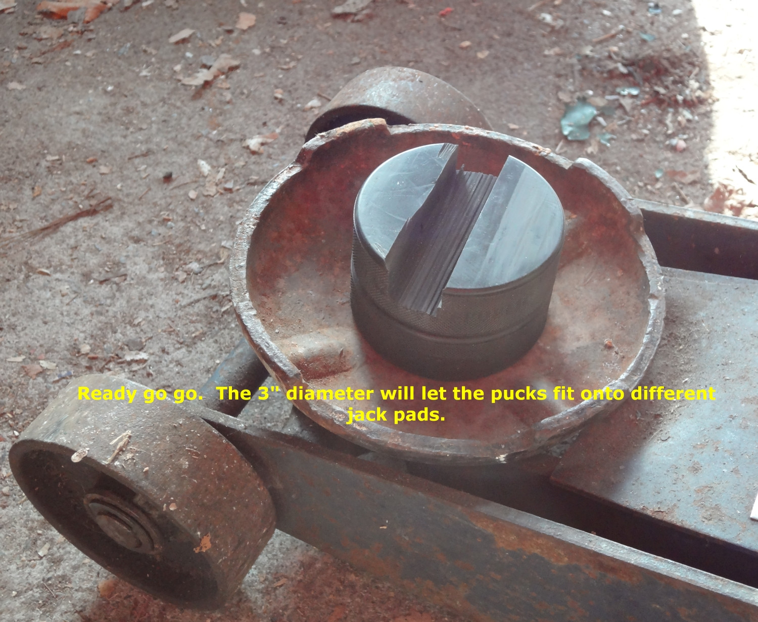

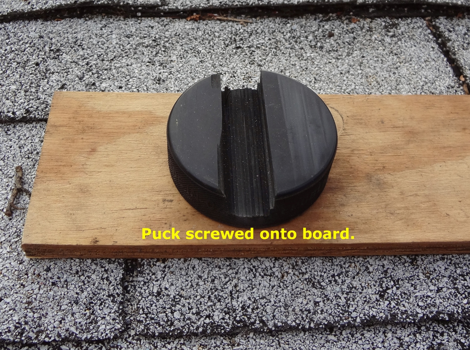

Thanks to your suggestions, I got my floor jack adaptor made. These hockey pucks will provide a firm, non-damaging grip on the pinch weld when lifting the Fit. I'm going to order two more pucks and make another one of these, possibly neater.
The puck is screwed onto the board to make it easy to run it over the table saw a few times to cut that groove.
