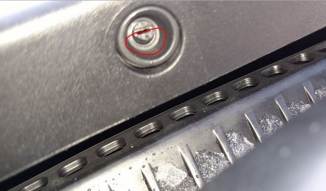

Sorry for the absence of photos - my phone wouldn't focus last night, and today is freezing in MA (again), but I'll try to explain so that others can learn through my mistake.
I used the flat end of the nail file from the SwissCard for this - less sharp than a regular flat head screwdriver.
I was able to adjust both sides one click up pretty easily, however at that setting they were spraying over the roof. When I adjusted the driver side back down it sprayed even lower than before. After some fiddling I was able to coax it into some middle position, but then it was spraying too far out and hitting the driver's side window, so I tried rotating it a bit, it went too far, I tried to even it back out and that's where the part circled below broke off. I then tried to insert a tiny flat head screwdriver into the slot to see if I could turn it back out, but it ended up just damaging the plastic even further.
Now it still sprays, but instead of two even sprays like on the passenger side I get one thick jet hitting the center of the driver side windshield. Perfect height though!
I found the damaged part online, it's like a $6-8 piece of plastic labeled "Nozzle Assy" (the 12 year old in me snickers every. single. time.): Part Number: 76810-T5R-A02
Seems like a fairly quick and easy fix to swap it out, hopefully that is actually the case.
