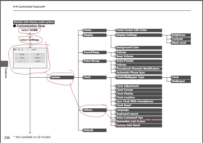

You can set the display to show the most recently displayed screen. It's an option in your settings. That way if you had the music screen up the last time you were in the car, it will go back to your music options next time you start up.
