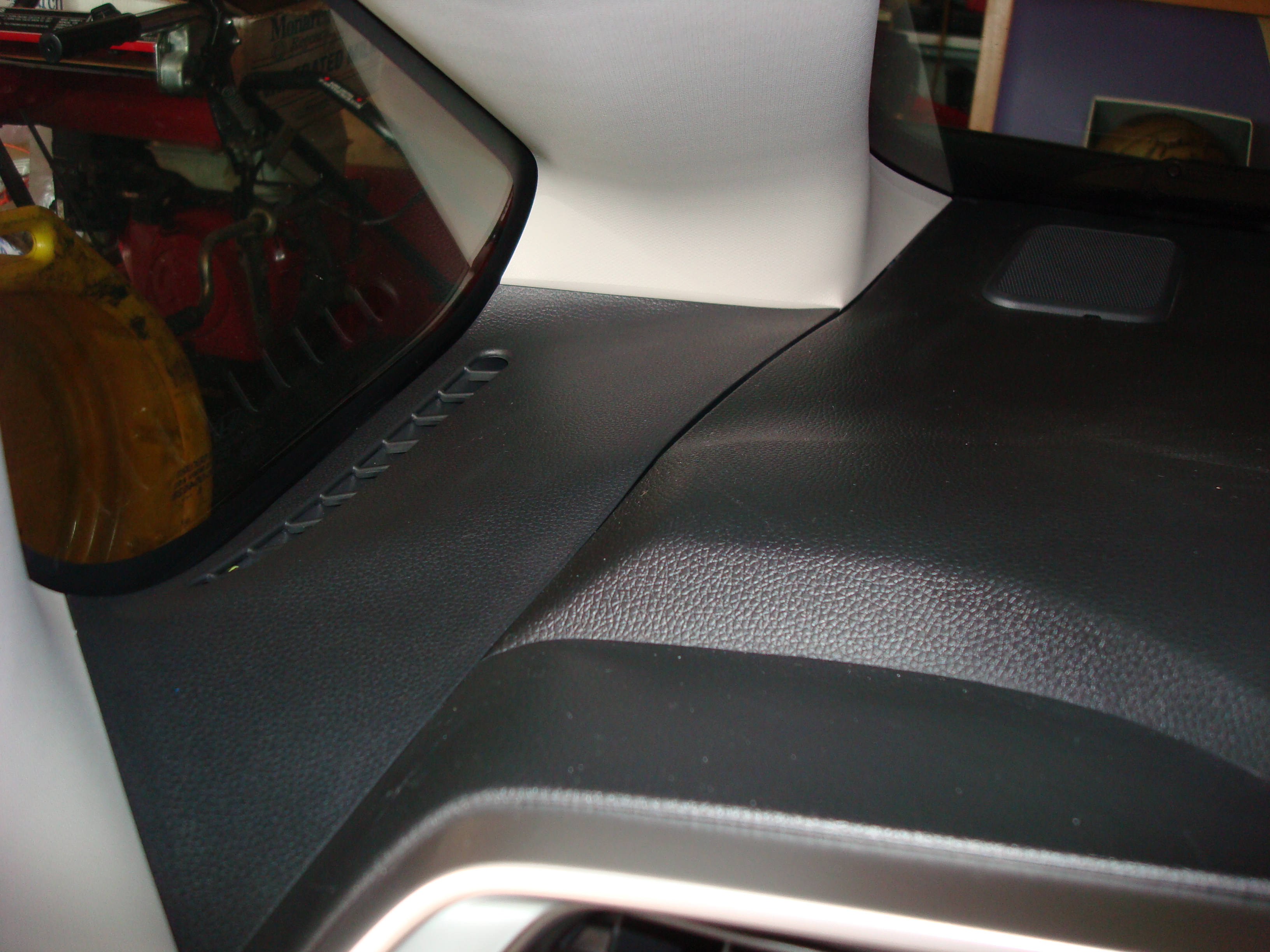

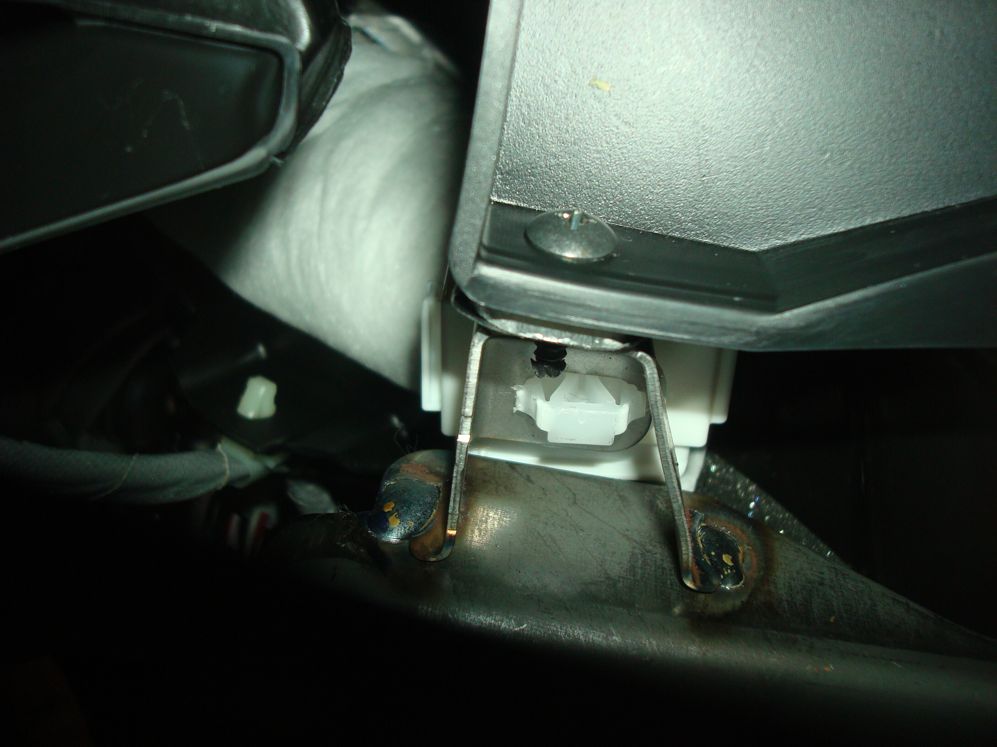

I had this problem and seems easy to correct. I added a 1/8" shim under the screw and it fixed the height alignment issue. I didn't take a before picture, but it looked like every one else's.
Attached Thumbnails Dashboard alignment-fit-1.jpg   Dashboard alignment-fit-2.jpg

I looked at your pixs better.it looks like the vent is still not set to the pillar. It looks a lot better now without a dash gap. But I would love to find a way to get the vent set. I have worked on many Hondas . But have never seen a vent so hard to set. The dealer tried to set it and they failed. If I find a way to get the vent set I will let you know.
I'm interested in what you did, but I have no idea what I'm looking at in the first picture.
Picture is of under the side vent piece. The picture is taken from the outside of the car with the camera against the quarter window.

Thanks for the pictures. Used a couple washers I had hanging around and got rid of the gap on the passenger side of my dash.

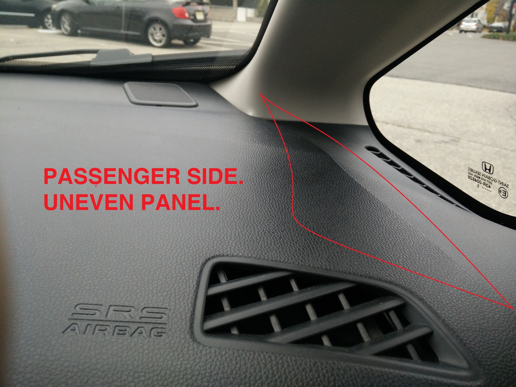

Are you talking about this?
Took it to dealer they told me all Fit are the same as mine.
They tried to even it w/ no success.
That's EXACTLY what we're talking about, and, no, they're NOT "all like that".
