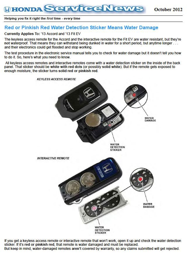

The information below was part of the service bulletin that
fit freak user chapito posted in his LaneWatch post. I reposted
it here for those of us that have put our key fobs through the wash.
