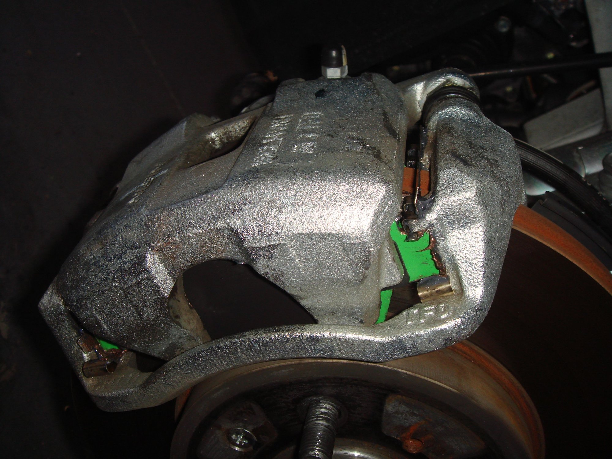

Long time ago, I also used EBC GreenStuf brake pads on my front brakes but with stock disc/rotor. The EBC is much better pads compare to stock pads in term of grip and feel but they wear out faster and they are very dusty, I think I goes through 2 set of EBC GreenStuf in 20,000 miles, while I drive about 20,000 miles also with stock pads before it need replacement...
One time when I drive with 4 people and lot's baggage in the trunk down a mountain pass, I experience brake fade and when I stop on the side of the road, the right front brake pads is on fire (literally on fire),
but it is not the mistake of the brake pads, but more because our rotor is way too small to dissipate the heat fast enough (please note my car is Automatic so no much help from downshifting/engine braking)...
But I never plan to stay with stock brake for long anyway, so the EBC GreenStuf was just a temporary fix before I can have enough money to upgrade my brake.
below is the pictures when I used to have EBC GreenStuf,

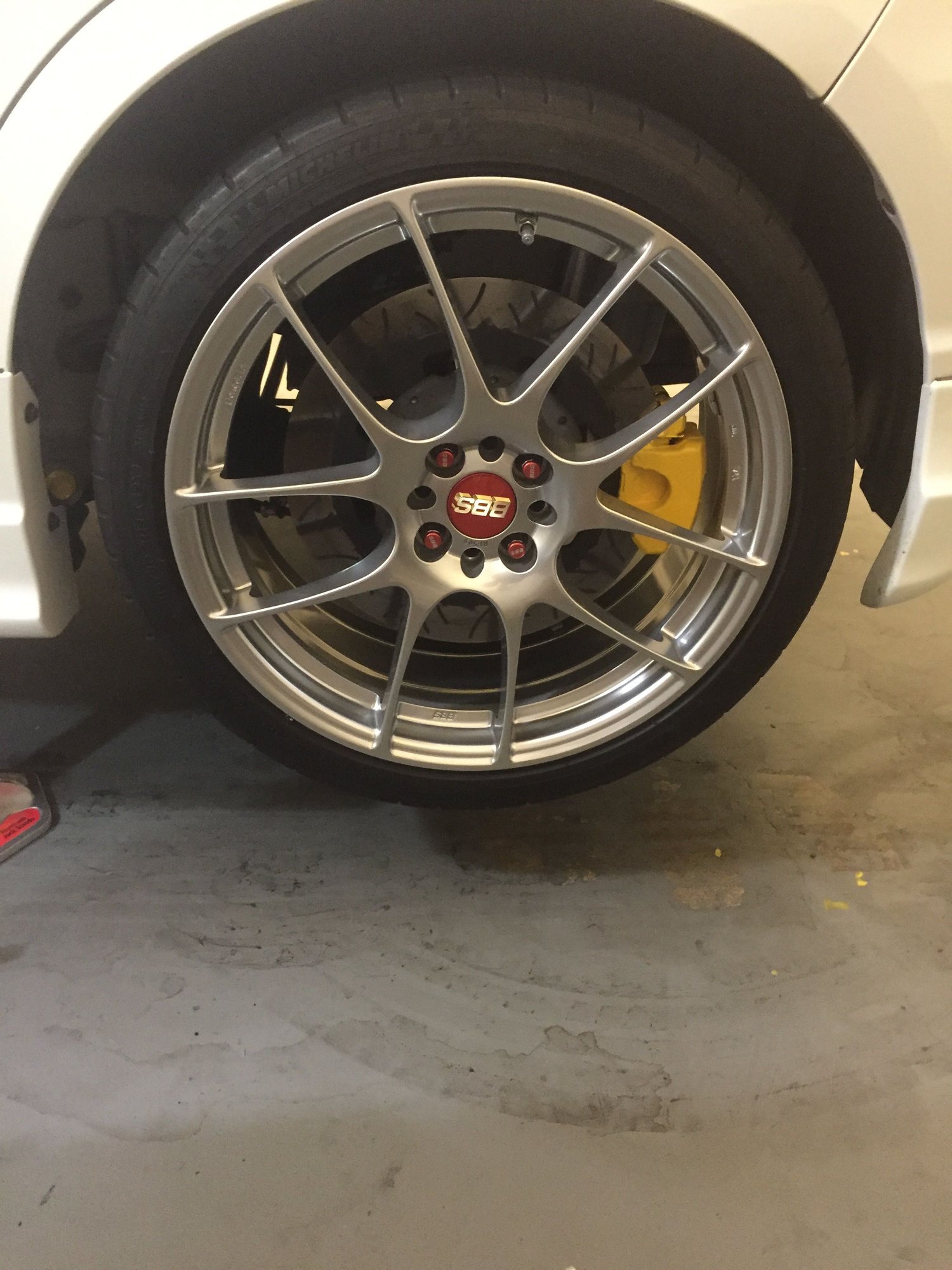

since I upgraded my front brakes to the system on the picture below,
I never had any problem with fade, the car stop much faster (and stable/straight) from triple digit speed and the brake pads will last much longer because it is not working as hard as the stock brakes:
