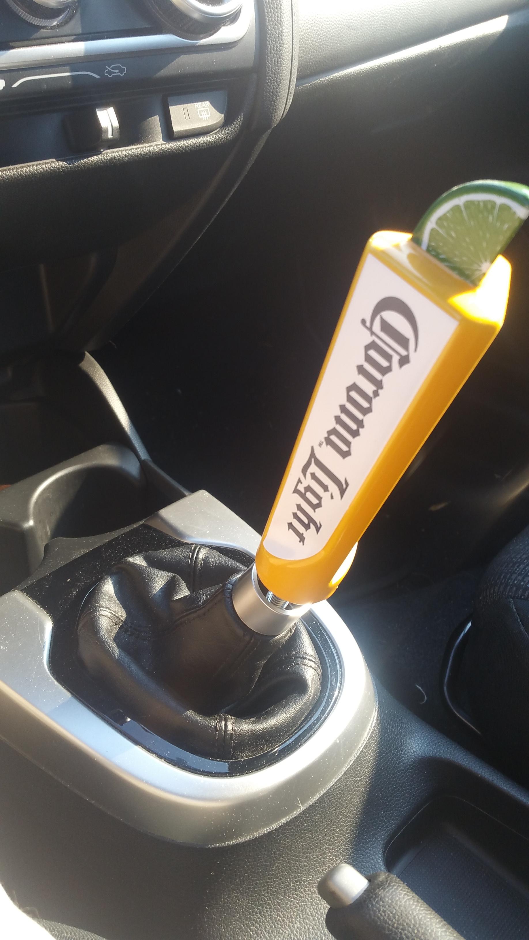

I was considering sportyifying my 2015 LX until i looked into its rear suspension. Swing arm..... Like a 1980s ford astrovan. The honda fit is a straight up minivan, which cannot be sportified.
(mostly kidding I'd be interested in a matched pair of front and rear sway bars when a cheap one comes out)
edit: But i did do this:

What's next, Crown Royal shift boot?

I thought it was fitting since i have a Mystic Yellow Pearl that is "Hecho en Mexico". Not sure how to attach the clip-style boot to the ceramic. Long time honda guys that have replaced shifters feel free to chime in here. (My buddy says its the exact same one as his RSX-S. So im sure its a common issue when switching shifters in hondas)
I replaced the shifter knob on mine, but the knob screws down a lot further than yours (there's maybe a 1/8" gap between bottom of shifter and top of the plastic ring....I bought a cheap piece of black pipe insulation, cut it to fit inside the ring, and it does well keeping the ring pretty well centered on the shaft, and the black plus minimal gap hides the chrome/threads well...it's machined black anodized aluminum billet wrapped in leather, looks like this but I forget the size ... the factory knob is just so lightweight - this one weighs perhaps 3x as much as original, but, it's not heavy, just feels a lot better...
