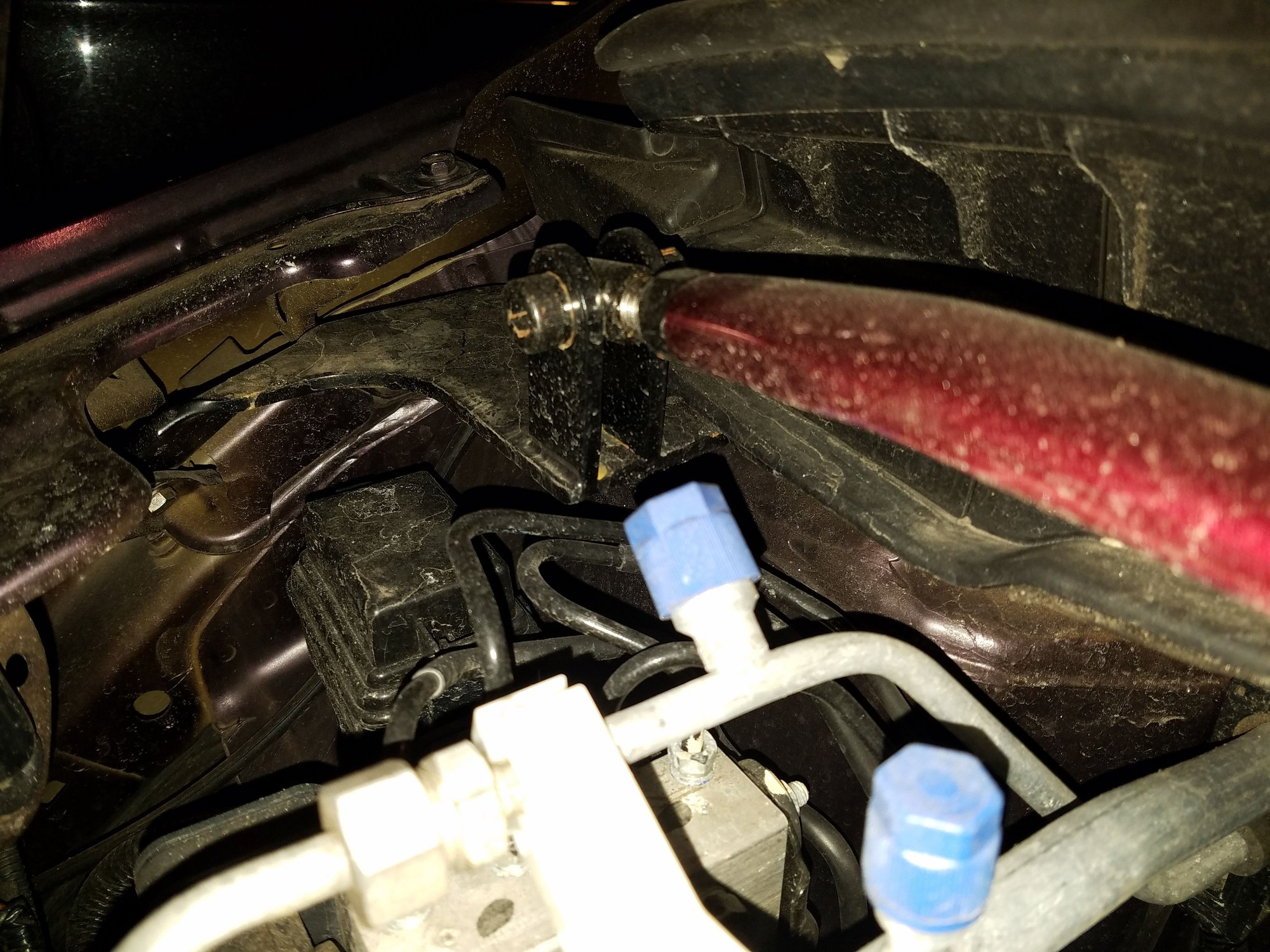

How difficult was it to install the strut tower brace? I am looking at the Tanabe Sustec. I looking at where it is supposed to attach, I can't see how it would help since it does not attach to the top of the front struts at all.
The hardest part was actually figuring out WHERE to bolt the thing on. You are correct that there is no place on the actual strut towers for the brace. Once I figured that out it was relatively easy as far as bolt on mods go.
The brace comes with these two black metal curved plates. The brace attaches to raised points / docks on the metal plates, and then the plates themselves bolt into spots against the firewall and against some other braces on the side of the engine bay using the silver OEM bolts that are already installed there.
I took some pictures to try and illustrate this. If you look past the ridiculous amount of salty crud that got into the engine bay, you can see the red strut bar attached to the raised dock or whatever on the curved black plate.
Behind the dock you can see a bolt peeking out resting horizontally on the flat side of the plate in the first pic. You can also see two smaller bolts side by side more clearly where the curved plate attaches to the side of the engine bay. Same deal on the passenger side.
Once you get those plates bolted in, then it's just a matter of centering the strut bar by spinning the threads on either end, and tightening it into what I'm calling the dock after its centered.
Do you feel that the bar made a difference? I have the rear sway bar and that definitely made a difference. Thanks for the quick reply and the photos!
