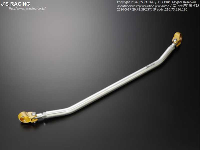

Old Mar 9, 2015 | 06:06 PM

Old Mar 9, 2015 | 06:19 PM

Originally Posted by Myxalplyx
no not quite

No, that looks like a strut brace. It stiffens the strut towers by connecting them together under the hood.

Nope, not really.
The Front lower arm is the bar at the top of the picture.
Honda Jazz GK (3rd Gen) 2WD 1.5 (2013) Front Member Brace / Front Lower Bar - Ultra Racing Product Catalog
Ultra racing is a Malaysia base company. I have their bars on my RAV4. Their product is good quality. You can see the list of suspension product for GK5 on their website
Honda Jazz GK (3rd Gen) 2WD 1.5 (2013) Aftermarket Performance Parts / Accessories / Spare Part - Ultra Racing Product Catalog
I think all the suspension bars should work on the US FIT except the Strut bar because it's for RHD. Now if you could only import them to the US. You could also bought them on eBay from Malaysia.
I personally have not get to the stage, where I want to modify the suspension yet, but if anyone would like to try it out, please let us know the result.
BTW, Honda JAZZ, HR-V and CITY shared the same suspension. You could also search for suspension parts for GM6. I believe their parts are interchangeable.

Ahh, OK. It's a chassis or control arm stiffening brace.

Here you go:
This wouldn't be hard to make at all.
I don't know about all those other braces. I have to wonder: If they stiffen up the car, how do they effect the crumple zones in the event of a crash? A race car is one thing, but a double D in the event of a crash could be something else, no?
