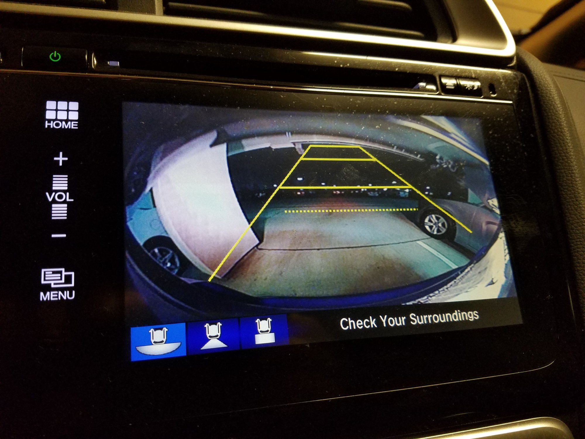

So I found something weird on my 2016 Fit EX backup cam when I start the car and throw it into reverse.
Seems that the software is not processing the cam image right out of the gate, and showing the full unedited cam view. This will also happen when if I wait for the system to fully start. I will; need to toggle the cam view for it to actually process the image.
Whats even odder is if I turn off the ignition, and start again, it's fine. So seems consistent with cold starts.
Putting the car in reverse, on a cold start. Looks like the default full-image without any image editing that the software does.
Tapped that 'normal' view. Grid shows fine.
Tapped fish eye again. Tis fine.
Anyone else seen or heard about this? Any fixes?
I will be taking it to dealer tomorrow just to see if they have seen it. Maybe ill get lucky and find a tech that actually knows whats-up..

Hasn't happened to me. How quickly are you going into reverse after starting the car? For me I usually have a routine, and it takes a minute or two before going into reverse. I only say that because you say you can go into the different view modes and back and it looks fine.

It's a feature that changes the grid lines orientation, if it thinks it's going backwards onto an upwards incline.

Mine does the exact same thing if I hit the start button and immediately shift to R.
