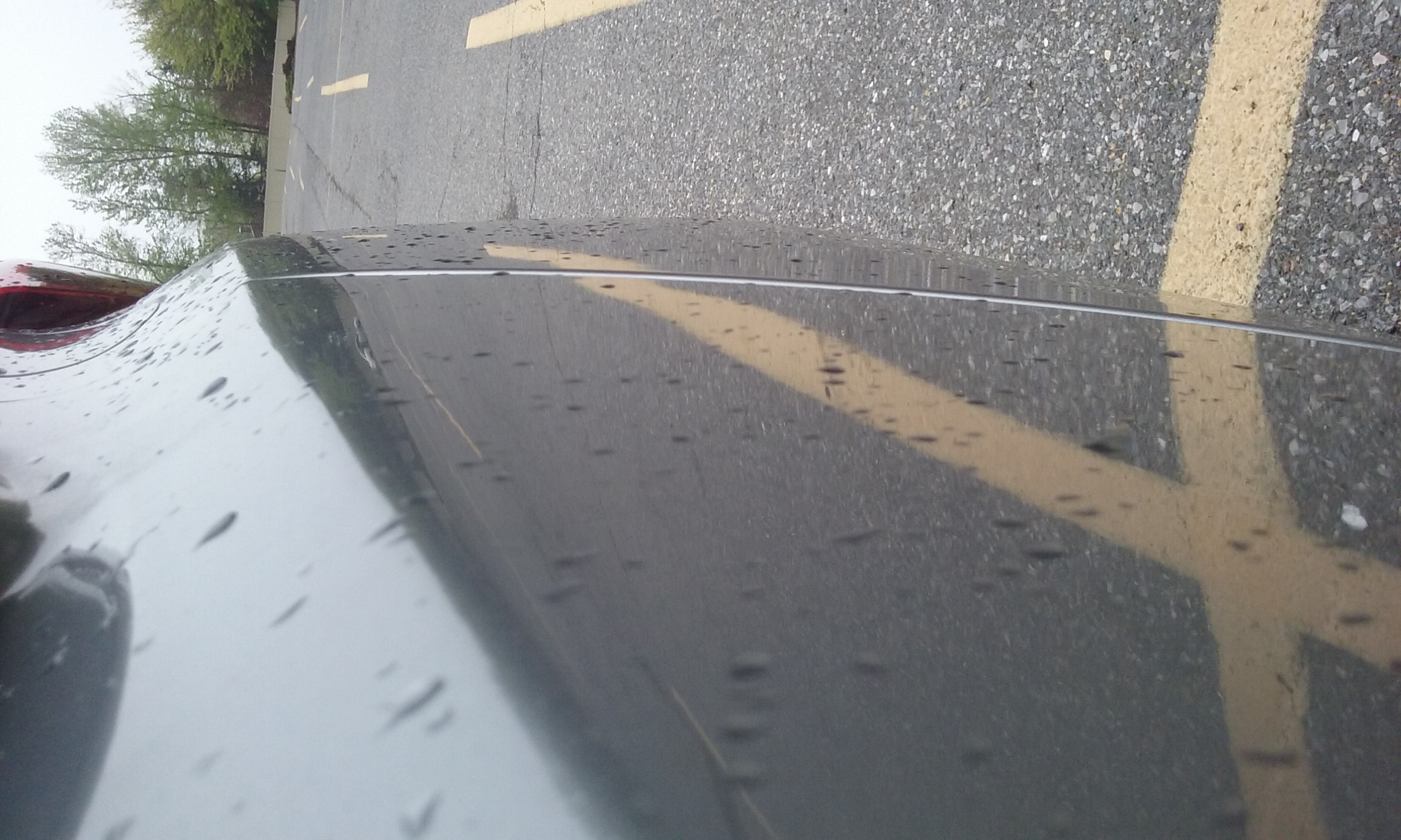

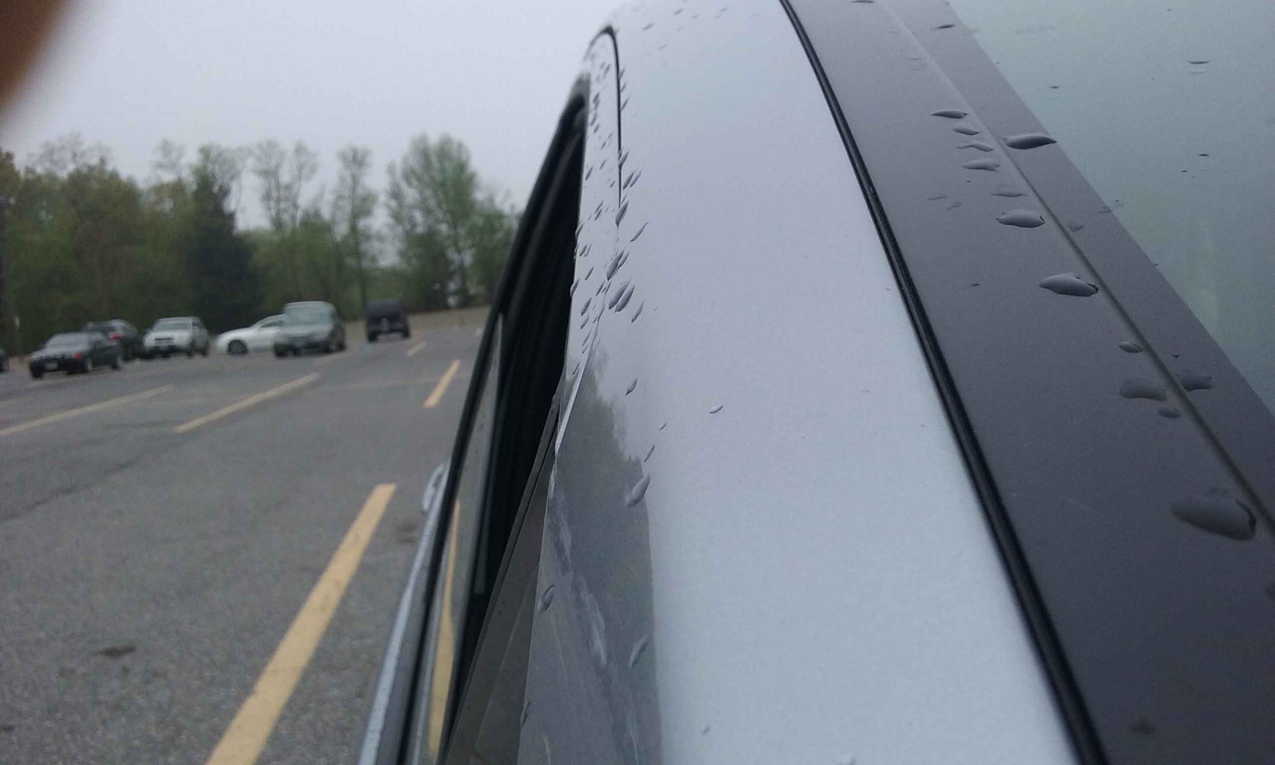

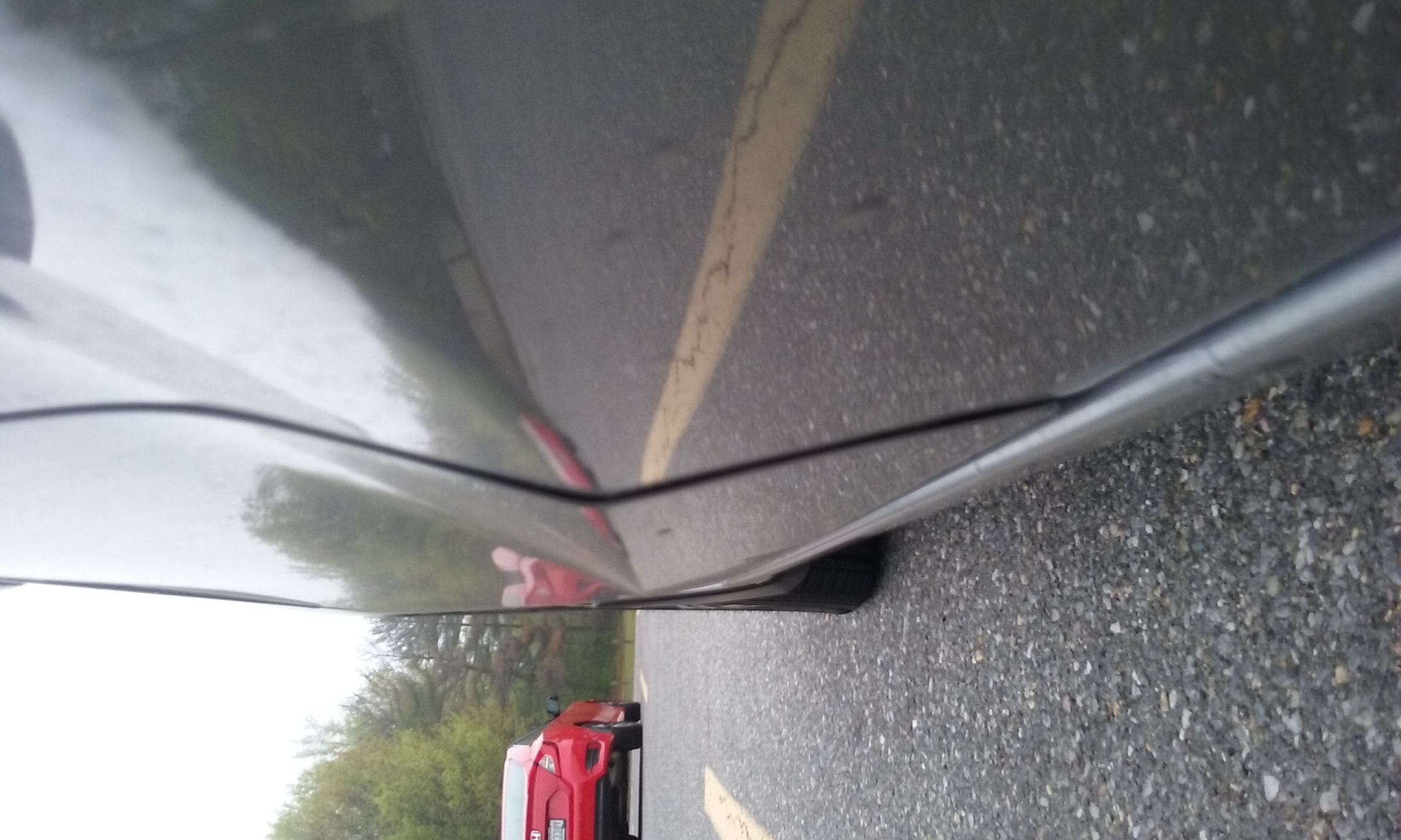

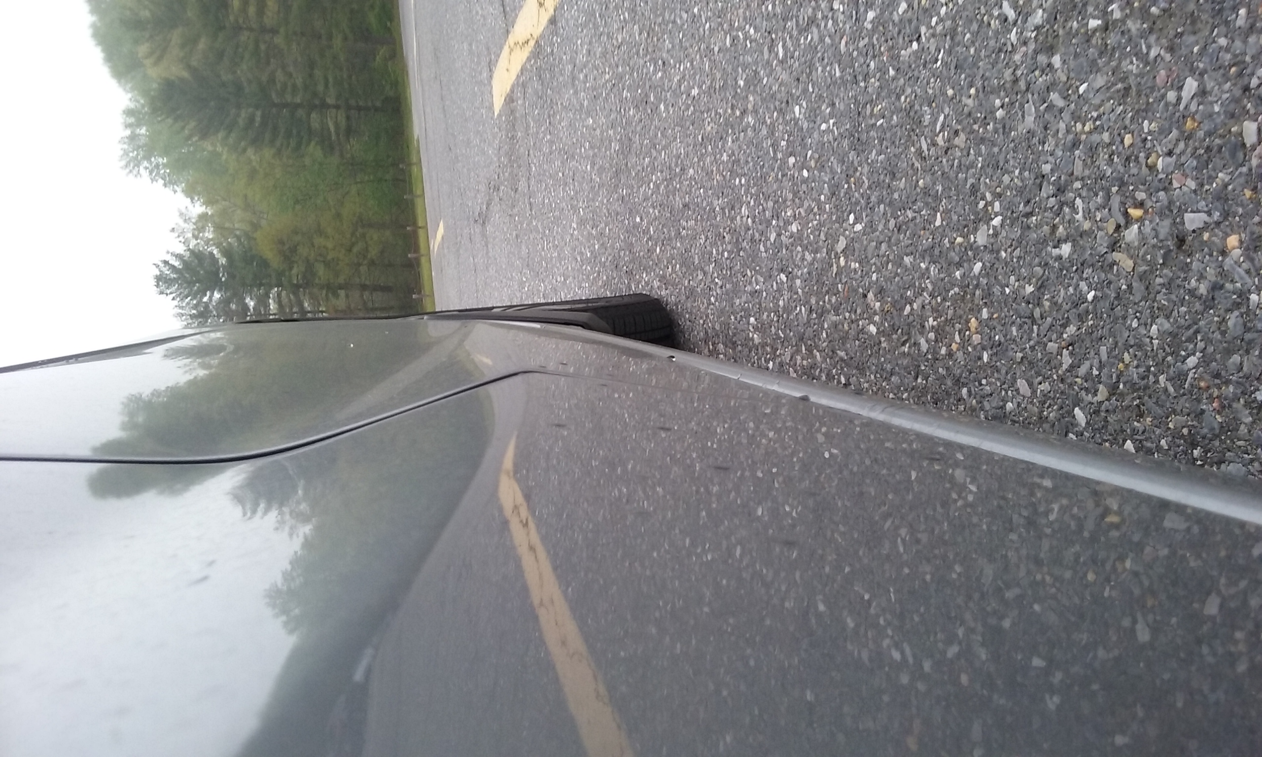

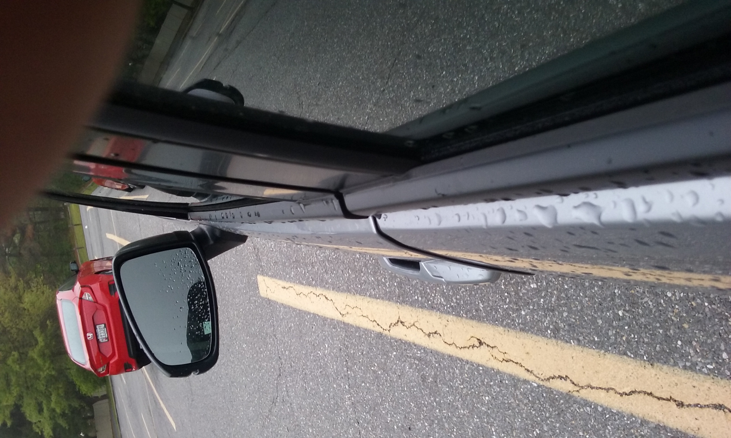

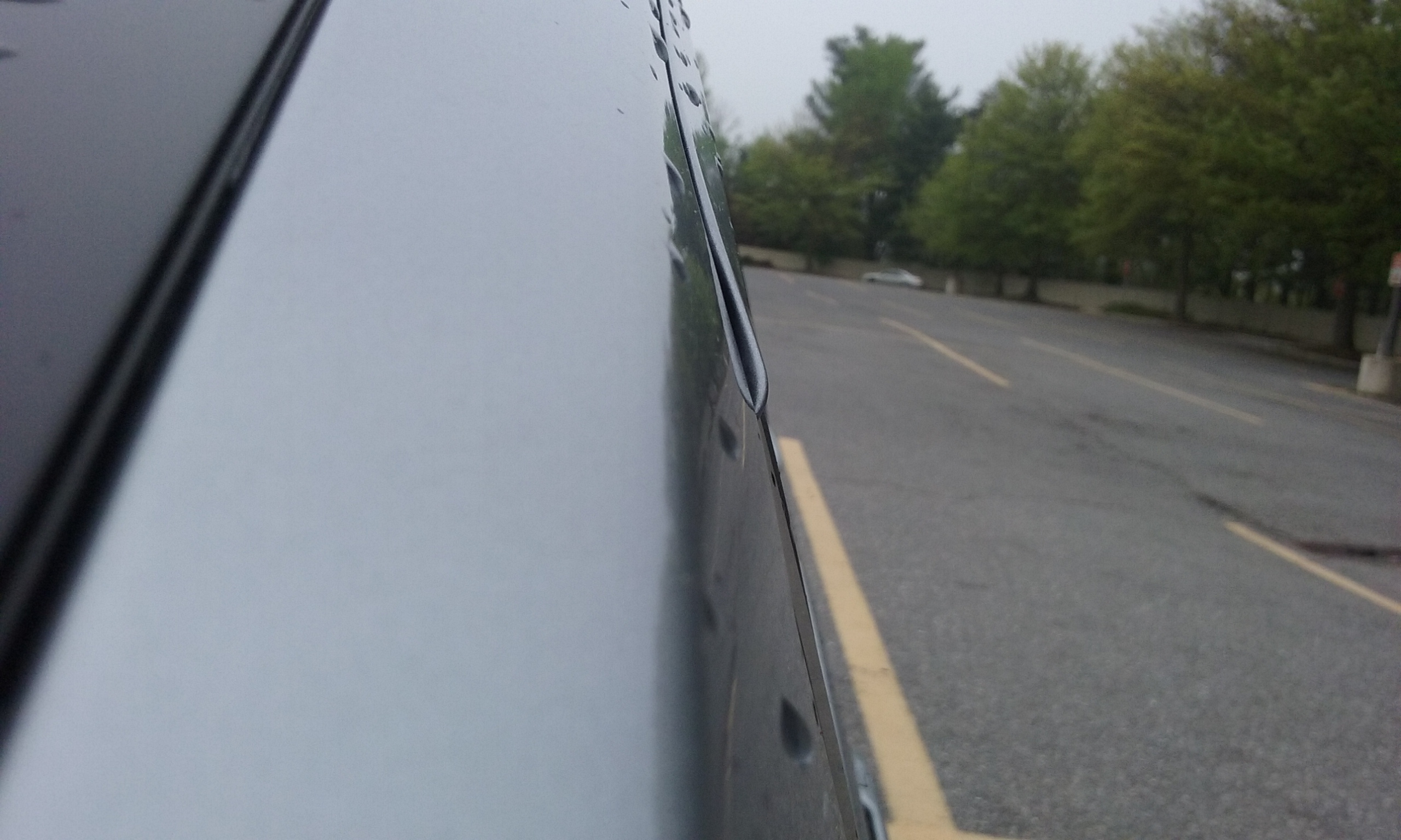

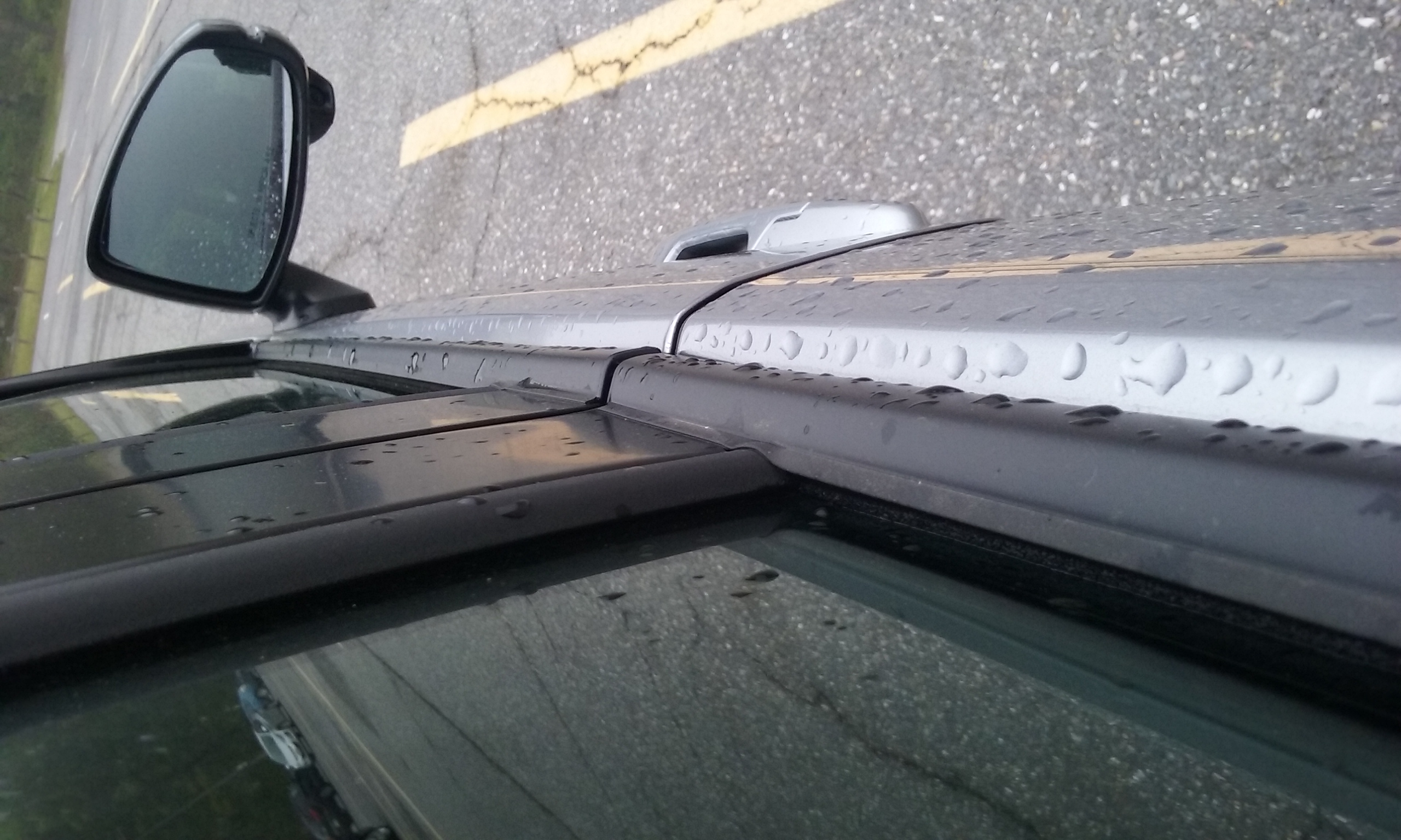

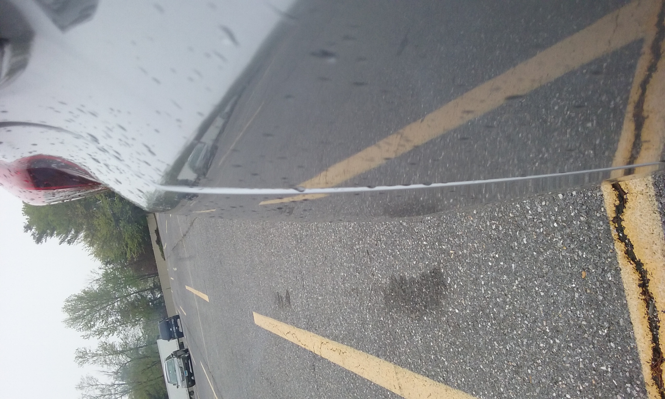

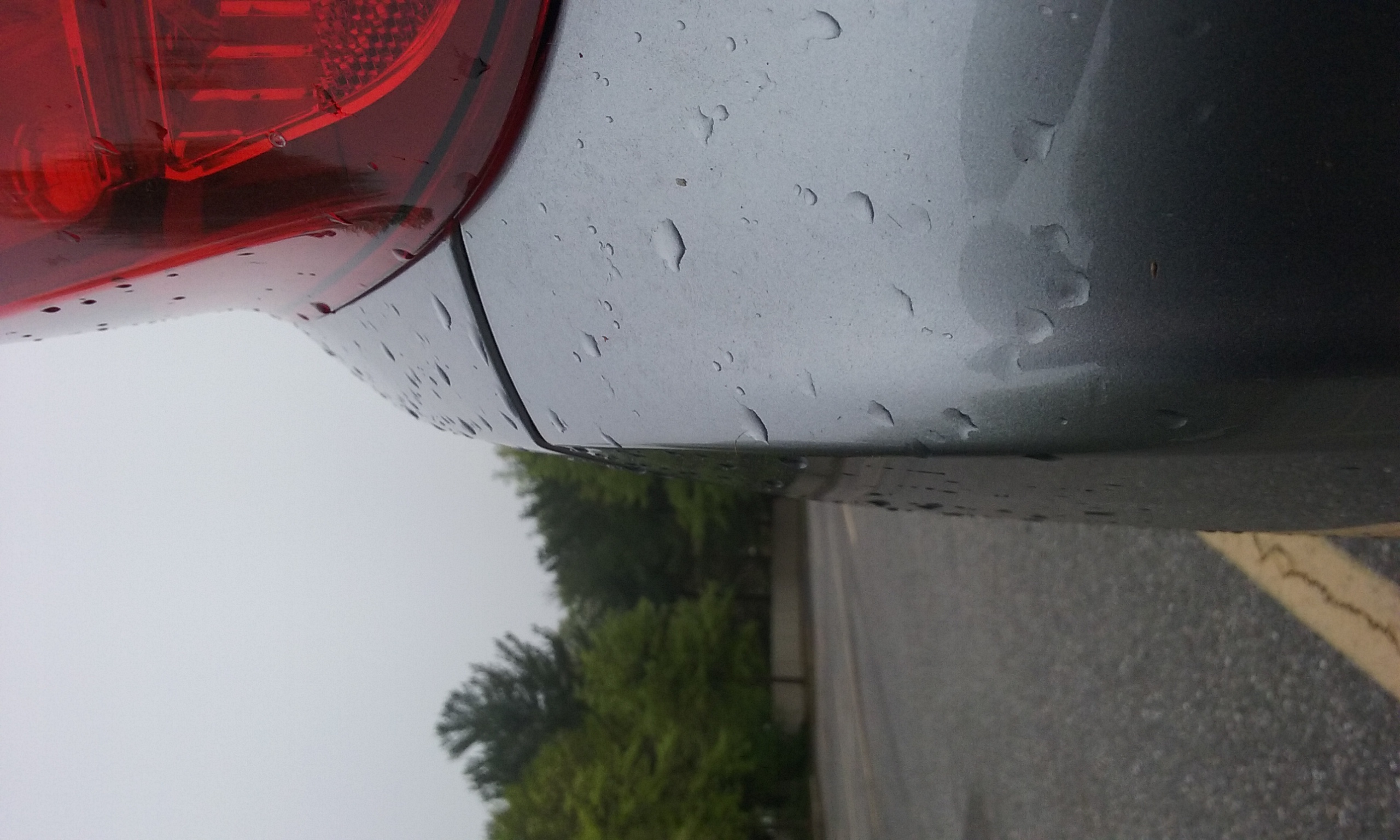

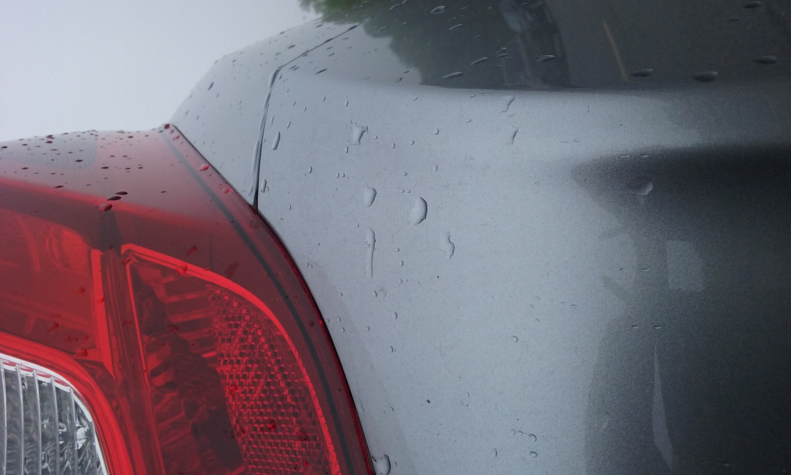

So I just bought it in April. Dealer had cheap aftermarket door edge guards on all the cars in inventory including mine. I get my new car home. After a few days I realize how cheap the door edge guards are and easily peeled them off. They were only stuck on with an adhesive strip. Then I notice how bad the door were. They don't close flush at all, not even close. Anybody else see anything like this?
I contacted the dealer and he agreed to fix it. But he said his body shop will do the best they can I suppose meaning no guarantees and being perfect. So, I'm a little pissed. BTW, I should have seen it before buying it but the problem was masked by the edge guards. This is a new car, not a used car, and the dealer has a responsibility to deliver a new car without substantial defect. I hope he can come through.
It seems like a manufacturing fault rather than an unreported crash. The car drives like it should, feels nice and tight in the body and no rattles.
See Pics, left and right side comparisons.

the door skins weren't made incorrectly. Someone was talking out their butt. I worked for Chrysler in their Body In White department where the cars bodies are manufactured. The door frame is quite flexible until a door skin is hemmed on. Even then it's still flexible until it goes through the paint oven which the hardens the adhesive along with any anti flutter. The fitters did a poor job or Honda's QC isn't anywhere near what Chrysler's is? No car would have left the body shop as bad as my Fit is. With Chrysler's system the car could be tracked back to shifty and what fitter signed off that it was OK. I would have written an employee up for lack of quality. Again Honda must have a lower standard? Personally, my car is embarrassing. Unfortunately all the fan boi's on here think that Honda is number one on quality
