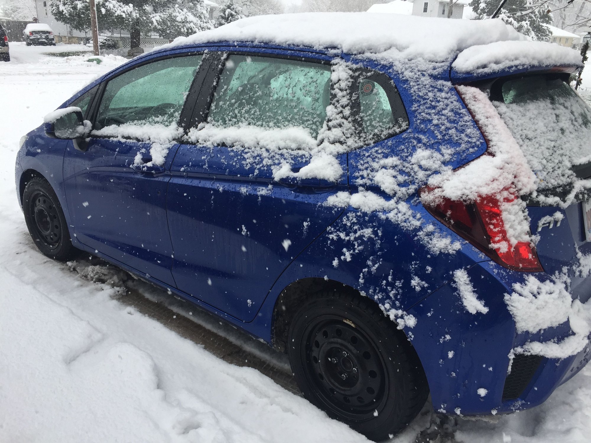

End result - I bought the Unique steel wheels. I do not plan to use a hub ring on these but will carefully insure I have the wheel and lugs centered and seated properly.
I'll swing by a local DT today and have Blizzak WS80s installed and store them until late fall. Right now, DT has a $70 rebate on them if you use your Car Care credit card - I always pay those off fast and rarely use the card, but for a $70 rebate, I'll go for it.
